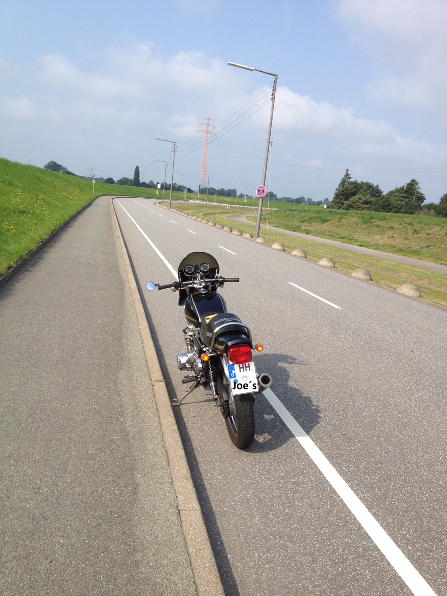

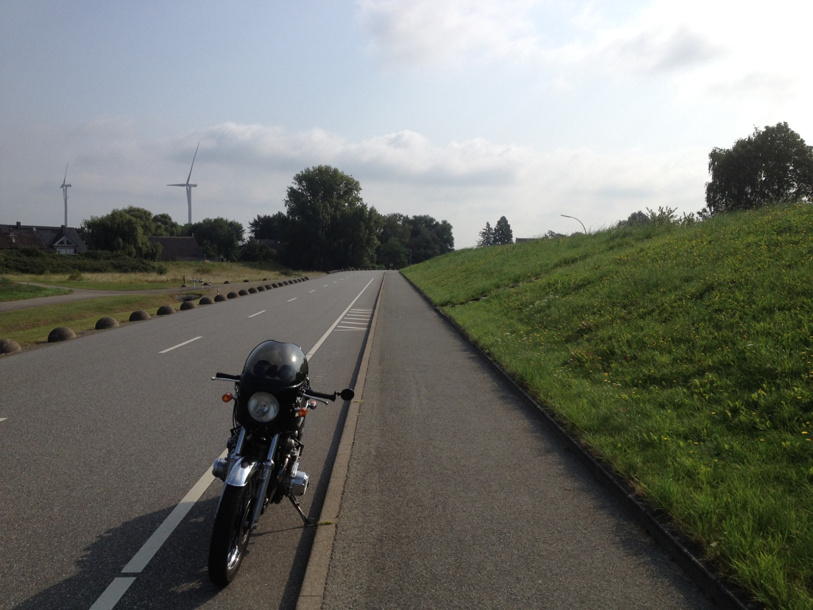

Today at morning,..on free and "open" roads
.....(.Bike runs very well at any rpm´s with my repaired carbs now..)...it´s a pleasure to ride it!

That road looks dangerous! Concrete curb to the Left and Concrete half balls to the Right. No drinking and driving there, ha.

The asphalt is good, the curve radius is very good. If you know how to handle a bike, nothing should happen...but of course you're right. The concrete bollards are deadly if you throw your bike away...they put them along this road back then to discourage people from parking there (there's a lake around the bend behind my bike), and of course, no one at the road authority thinks about motorcyclists...The only thing they always have the ability to do, is flash by radar there, or 500 meters later...
This stip along the river (it flows behind the dike to the left of my bike) leads past a lake after the bend...and has five good curves! - We often had one or two "private" races there in the evenings in the early 80s. It was usually for a tank fill-up or a few drinks. Although I would like to say that we weren't riding there drunk; This strip required a certain amount of concentration if you wanted to get through it at a good speed; it was always a good thrill. But that's no longer possible these days. It's too busy, people are running across the road, and the sheriffs are also on the lookout. If you're lucky, you might catch a good moment in the morning and let it rip a little...This morning, i´ve take 3 runs between,..and another with a stop in the middle for the pictures, just to show you the perspectives.
May you all have as much fun on your bikes as I do...!!!

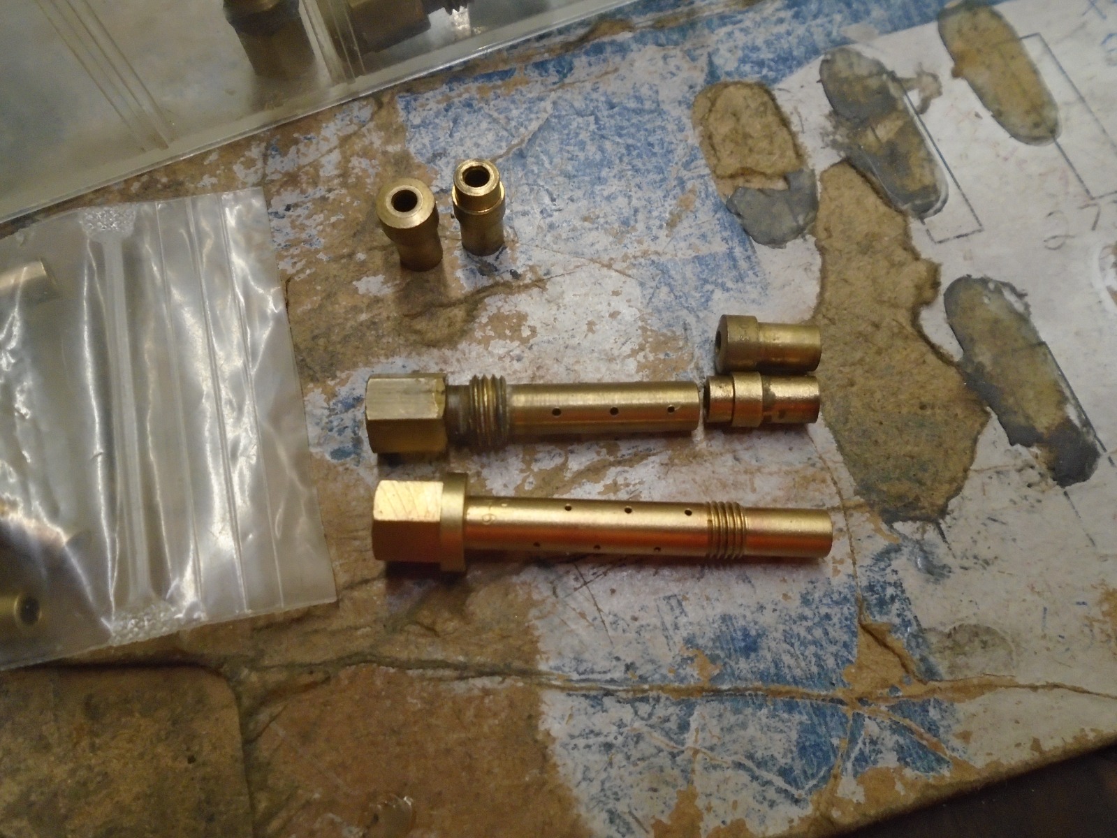

A supplement to what the email thoughts contained. You mention "orings" as the cause but was it really? Ever wonder why a smoothbore carb used a Complete Needle Jet and Main Jet holder in one assembly? Because the possibilities of loss of vacuum and just sucking air was eliminated. Nobody ever mentions this but bizarre running can Certainly be caused from the needle jet and jet holder not sealing as one when tightened down. I've also seen the Hamfisted persons waay over tighten these and they buckle the jet holder resulting in a slide needle that gets stuck/interference movement in throttle slide action. Ya gotta realize the Z1200 KZ900 had similar Jet holder but yet NO o-ring but worked just fine. And YES You have MUCH better paving mandates then here in the US!! That road looks well engineered and applied. I know me some pavement and drainage requirements!

I've overhauled a lot of these "Z" carburetors, but I've never had this problem before! It was definitely the seal between the jet holder and the housing! There are also 26mm carburetors that don't have this O-ring..( Z900 A4 ?)....and by the way, I was never really happy with the Z1000 A1/A2 carburetors: Only the mixture screw from below...difficult to handle...I prefer the 28mm ones on the Z1R, or all of the Z1, Z1A, and Z1B series..., with the airscrew from side, for me, they are much better!!!
I still have here for spare, VM26 from a Suzuki GS1000, with both mixture AND air srews equipped,...will check them over winter, maybe changing with the actual carbs...
Double-Cable holder is a little "higher", so i must change the holder to the Kawasaki one...

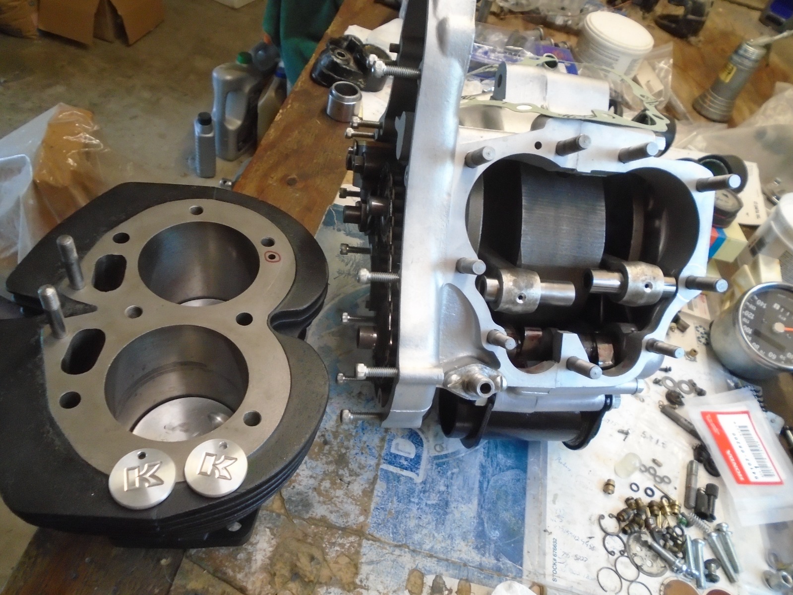

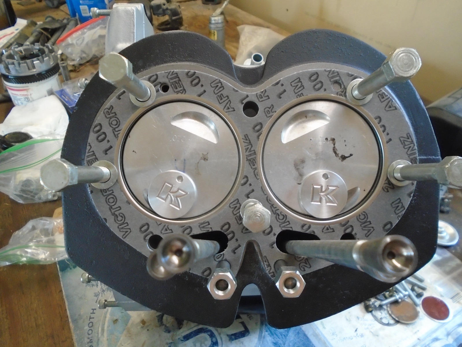

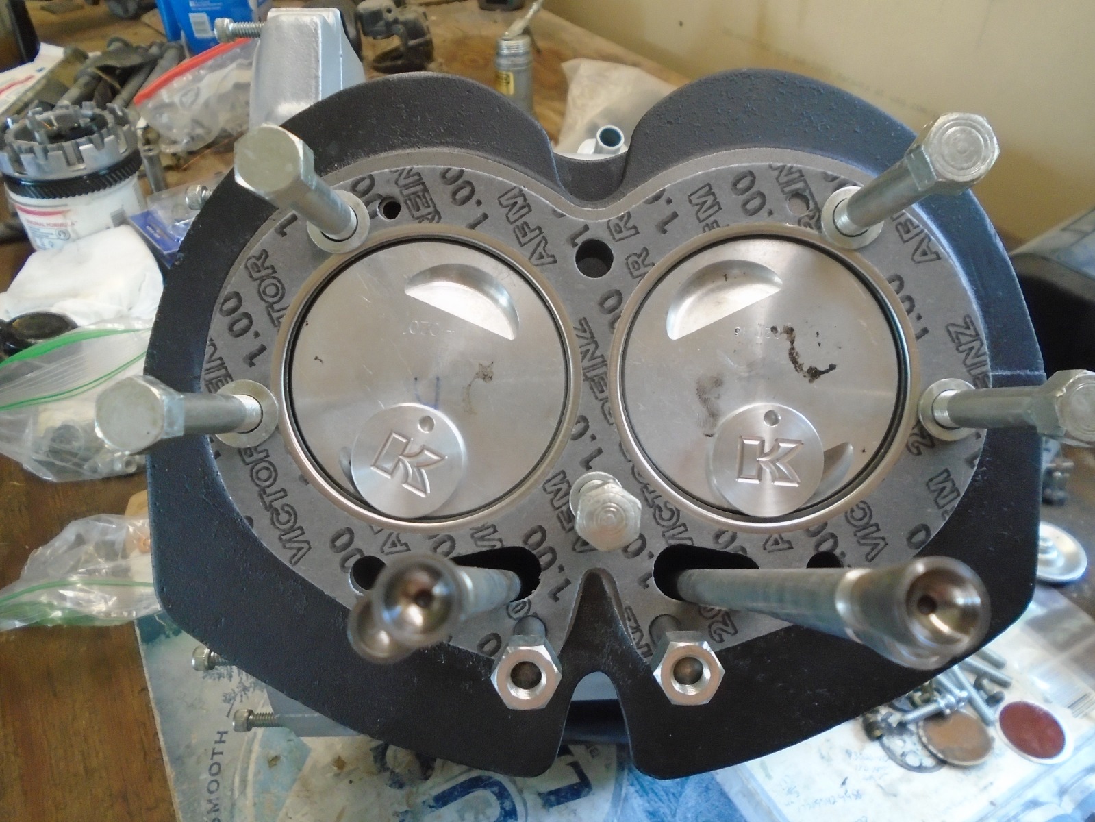

As mentioned earlier this Morning Joe, Your Cool Stuff arrived!! Perhaps sacrilegious resting them on a Norton Commando engine
. Tiffany Quality in trade for some crappy orings, ha.

It was a pleasure, Clay, you're welcome! - ( Maybe, it will help ya by screwing on this Norton engine,..may the spirit of "K" be with you
You certainly take on special challenges... yuck, Norton... you must be a good friend of yours to work on engines like that... 89 mm stroke, and resulting piston speeds of 17-25 meters/sec... but no matter: As I see it, you always do clean and accurate work! My Respect!

Clay’s key tags look great 😊
