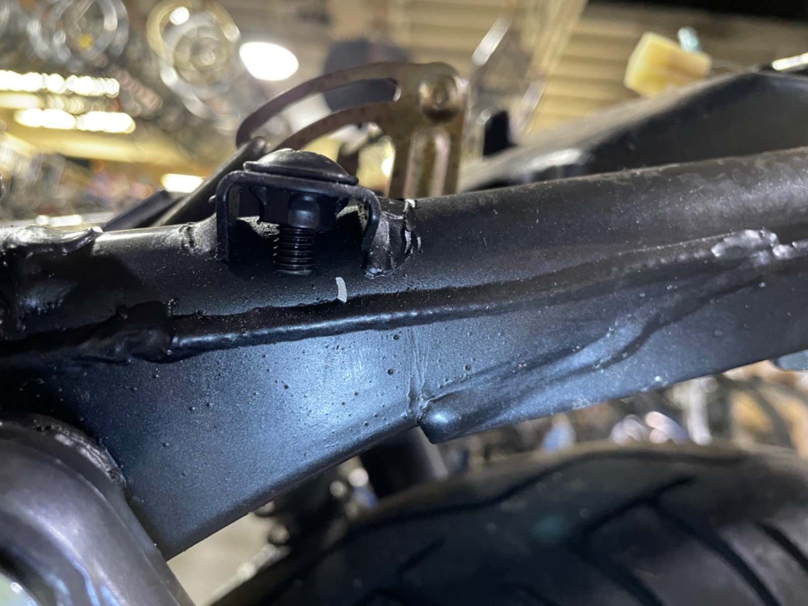

So just for a distraction from what is sure to be insurance hell, I have started looking into just how feasible it might be to fix my bike. I know I have an uphill battle in more than one way here, but if you all don’t mind humoring me and perhaps soothing my soul a little, I’d appreciate it.

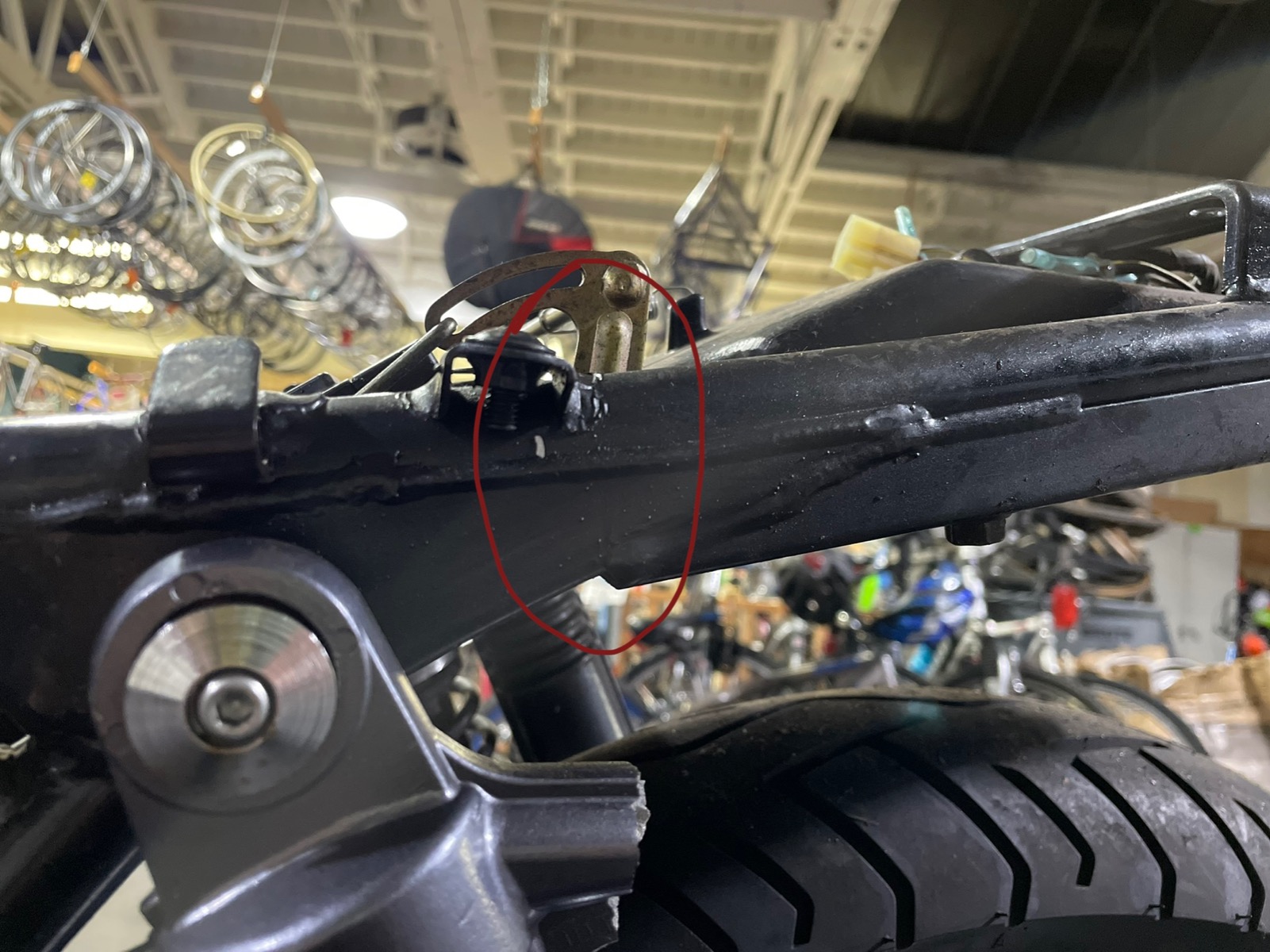

I’ve got the rear cowl, and combination fender and taillight mount removed, along with a small amount of other peripherals. Looking at the bike from straight on at the rear, I noticed that the left side is ever so slightly higher than the right. I put a straight edge on it to confirm. So I looked closely and it appears there is a place where the frame flexed and buckled up a small amount. I tried to take a photo of it, below.
I guess my question is, who or where do you send a frame to to get it repaired when you have damage like this? I know that because it’s not split and it’s behind the shock, it’s negligible for the rider, but could be a potential safety hazard for a pillion. Plus, I’d just like it to be perfect when all is said and done. Any welding is pretty much out of question for me to do myself. But unless something else more serious comes up I’m leaning toward buying the bike back as salvage, restoring it, and seeking a rebuilt title. This bike deserves it as far as I’m concerned.

A pro frame shop is the way to go. Hopefully there is some place local in your area. The motorcycle road racing guys would know.

20 Dec 2021 05:16I’ve got the rear cowl, and combination fender and taillight mount removed, along with a small amount of other peripherals. Looking at the bike from straight on at the rear, I noticed that the left side is ever so slightly higher than the right. I put a straight edge on it to confirm. So I looked closely and it appears there is a place where the frame flexed and buckled up a small amount. I tried to take a photo of it, below.
The bracing for the shock mount is strong, it may a dented tube, nothing important.

Having a frame shop look it over is a good idea, but keep in mind that many old KZ frames were not perfect to begin with.
