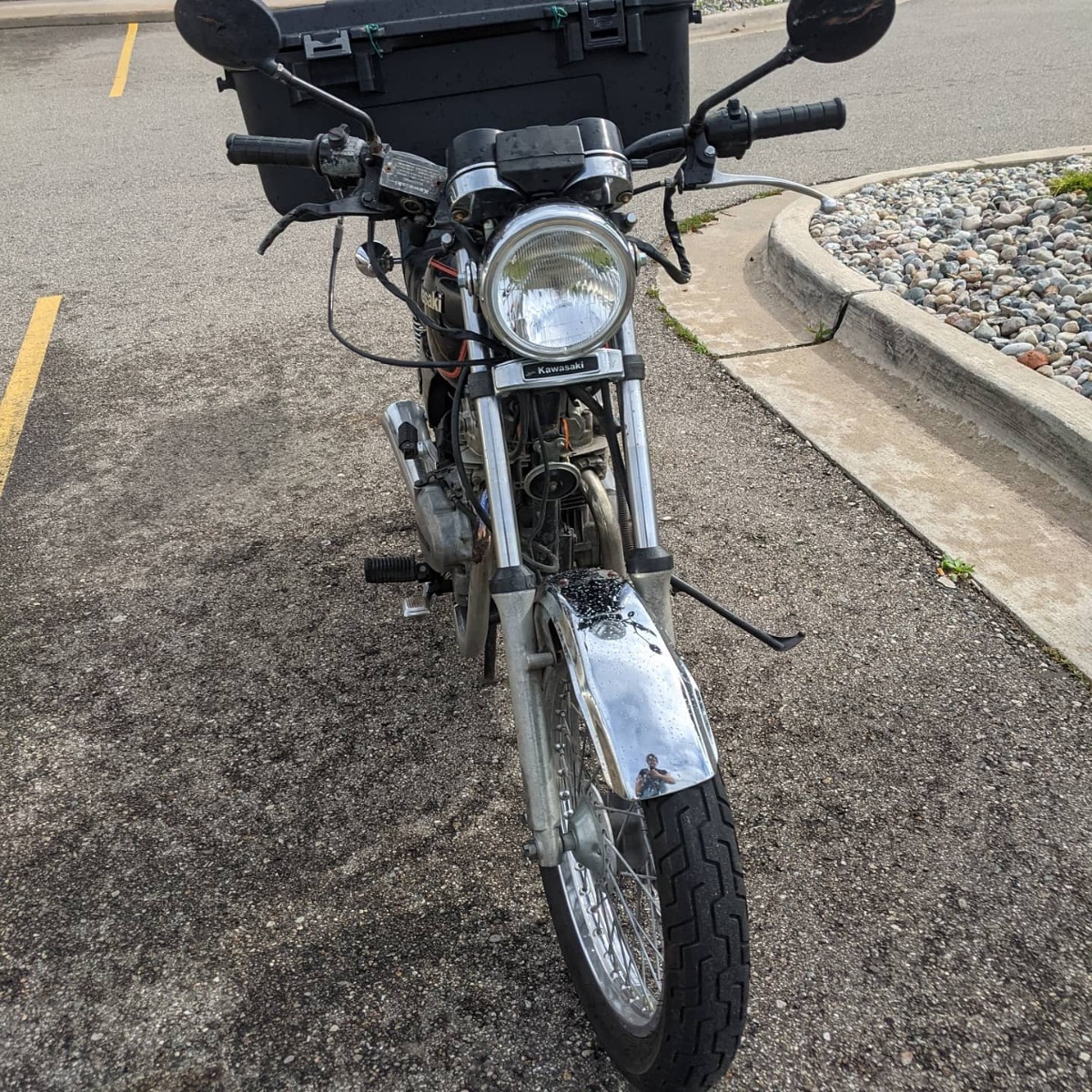

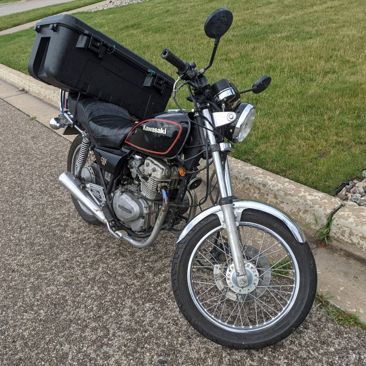

While riding home from work on the 305 today I had an unfortunate meeting with the side of a car. I was in the left lane of a four-lane road, and they pulled out from the right, stopping right in front of me. I sort of saw it coming - I suspect every car in a driveway is about to pull out - but hey, what are you gonna do.
It was raining so I locked up immediately, and just skidded straight into their door. I fell over, only took a bump on the elbow, no real harm. They took off, of course, so I figured I would just head home.

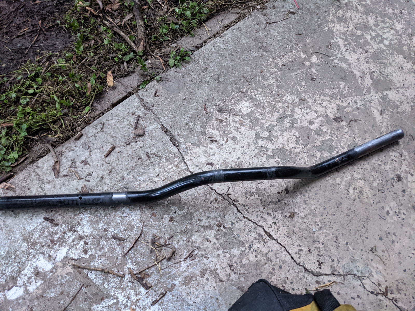

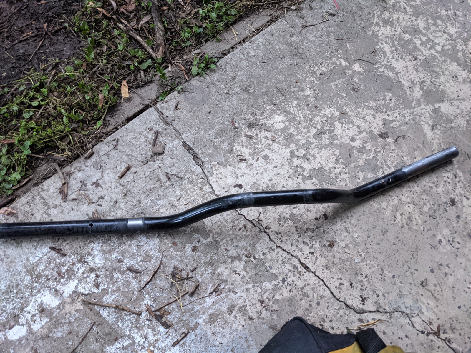

Unfortunately the bars were bent, and as I learned when I got home, the forks were too. Someone called the cops so I had to talk to them, and ended up getting my car to tow the bike home.
I guess with the cost of trailer rental and replacement forks it's a $75 incident - could be a lot worse. Think I might get some real tires for it soon.

No eBay APP ID and/or Cert ID defined in Kunena configurationGlad you’re ok. I was just looking at bars. Emgo makes a super bike bar the are if I remember 32” wide, 4 3/4 rise, and 4 1/2 pull back for $28.00. Forks will be your most expensive.

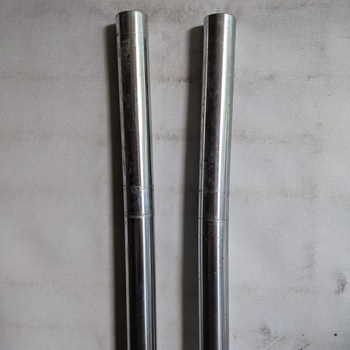

Thanks everyone. My shoulders were killing me until today, finally loosening up...I suppose I braced myself. New forks on, here are the old ones post-crash:
Still doesn't track perfectly straight, I think one or both of the triple clamps are a bit bent, but it's livable. Front wheel needs to be trued too, so I'll use the long weekend to work that out.

One of the triples may indeed be bent, but I would also closely inspect the front of the frame for any signs that something is askew.

I am pleased that you suffered no serious injuries Ghostdive, but three things should be mentioned. I assume the huge black box was on your bike at the time of the crash correct? If so that loosely attached box will most assuredly have some negative handling issues in an emergency situation. I won't go into details, but I hope it wasn't on your bike when your emergency situation came up. The other point is that you said you slid/skidded into the car and were now going to get some real tires. I am not sure what that meant exactly, but tires are one of the most important items on your bike besides a good working brake system. Speaking of braking, once you go into a brake lockup all bets are off on surviving or avoiding a crash. After you get your bike repaired and put good tires on it get to a clear parking lot and try to become very familiar with slowing your motorcycle down as quickly as you can. Be careful doing this though as there is an element of danger involved. The term we used in the past was "threshold braking" which takes place just before wheel lockup. Threshold braking is what you want to work at obtaining, but it must be mentally adjusted for with regard to the prevailing pavement conditions. Even newer bikes with ABS can't stop or slow down as quickly as a rider who knows his/her bike and utilizes threshold braking properly.
Please note, I am not picking on you in any way, shape, manner or form. In all the motorcycle crashes I investigated I always tried to learn something from them and there almost always was something to learn. I was always amazed at how neglected tires were on motorcycles. Some people ride on them until the cords are showing and almost no heavy weight bike riders bother checking their tire pressures. I learned quickly to check tire pressures on all involved vehicles at serious crashes and note them in my reports. Rarely did I find tires were properly inflated be it cars, trucks or motorcycles. You would like to think motorcycle riders are fanatics about their tires, but most aren't. The standing joke became big bike riders only checked their tire pressures when they took their bike in for service work. At least once a week in the riding season I would give some biker a ticket for running on defective tires and they just never understood why I was so picky about tires. Their feeling was if the rim isn't on the pavement yet it's okay. Being a motor officer helped make the point, but few completely understood my concern especially when they had passengers, like wives, girlfriends or their kid on board. Hope you heal fast and get the bike repaired quickly.
