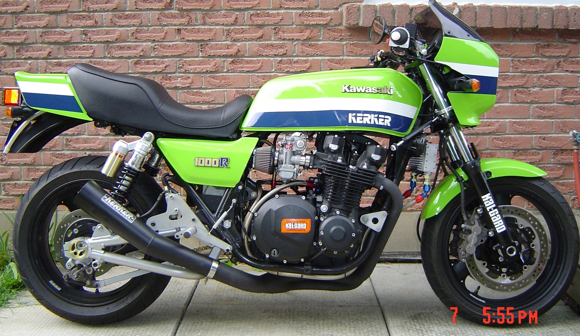

I LIKE!!!!
Your bike looks real nice in my book!!! What kind of throttle is that?? Looks like the old Yoshimura 1/4 turn I found for my old Superbike.
A few other things I also did to my S1 was replace those rubber mount pieces with the solid aluminum mounts that Sid Pogue made back in the early 80's. And I made up an oversize swing arm bolt. I could not believe the amount of clearance between the frame boss, and the stock swing arm bolt!!!! It had to be at least .030 between both. Just imagine what .030's of play there ends up at the rear axle!!!! That's one of the first things I noticed on all of the Muzzy built Kz1000's was a different swing arm bolt. Gee, I wonder why!!!
My machinist made me up a fixture that fit into the frame, and had a adjustable ream on the other end that opened up that side of the frame to the oversized bolt. Then I flipped it around and did the other side of frame. That way both sides of the frame were basically line-bored. Then I just honed the inner swing arm bushings to like a .001~.002" clearance to the oversized swing arm bolt. I have to tap my swing arm bolt into place. A lot of work, but it made a HUGE difference on my home built KZ1000 back then!!!

I don't know about that throttle since I didn't build the bike. So can't answer that one sorry.
