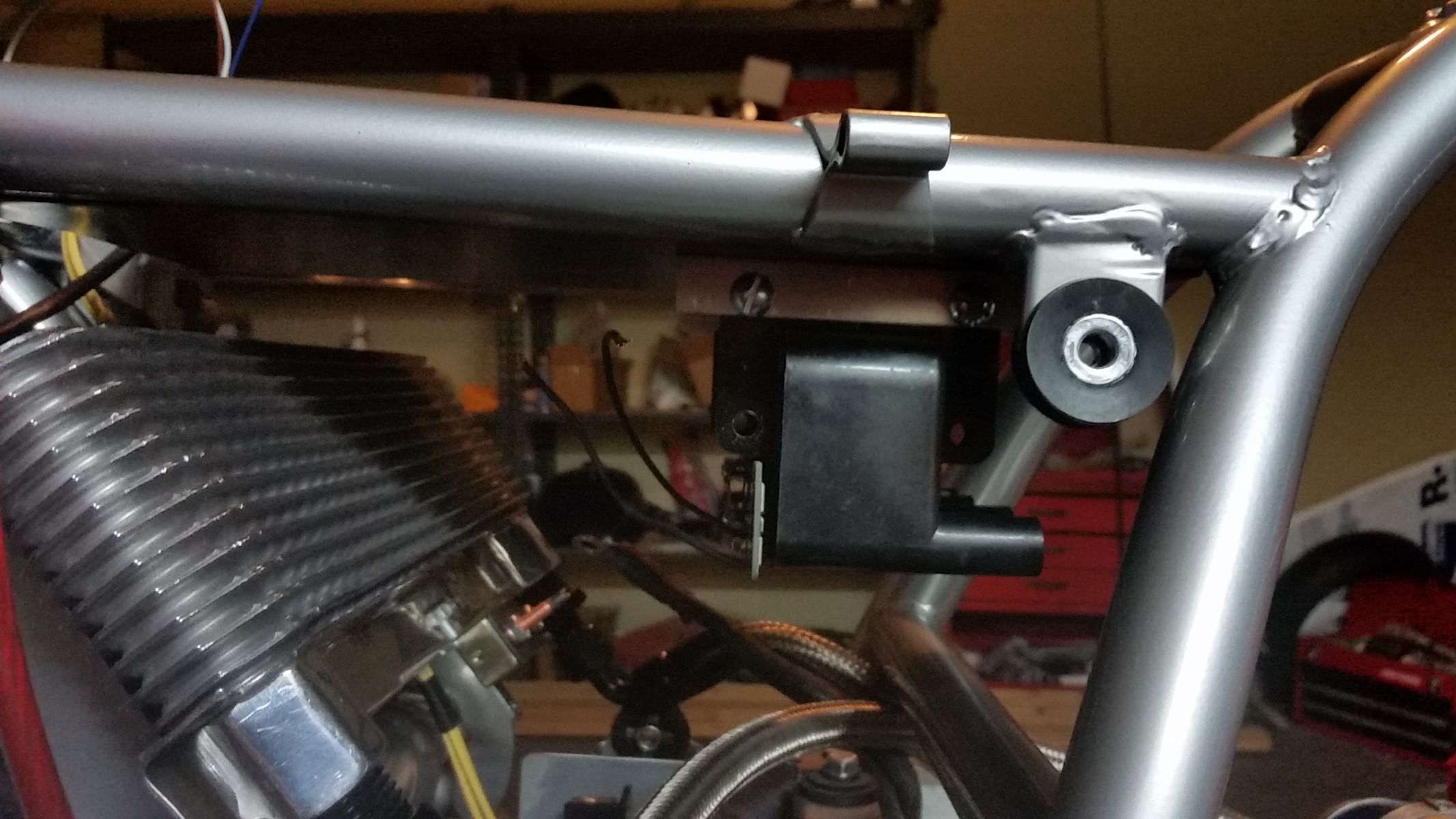

did your coils fit back in the same--is that bike running?

the stock ones would have but I went with a C5 ignition and coils which won't fit with the bracing kit so I put them here
No, its not running yet but soon.

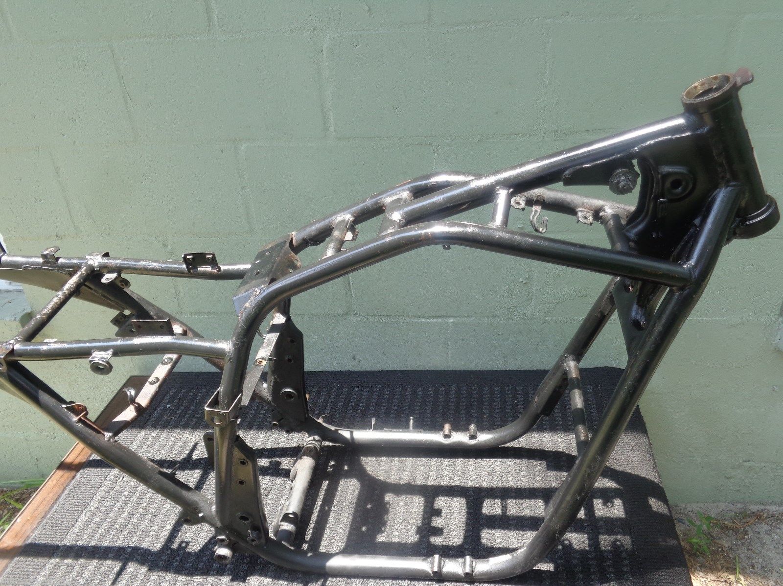

Re: Kosman frame bracing kits for the Z1 KZ900 KZ1000
25 Jul 2015 15:45

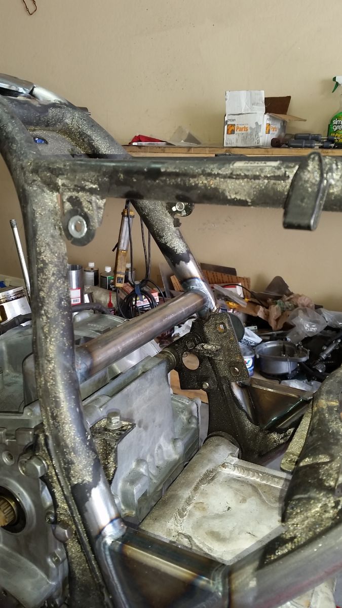

I thought they were no longer available. At least it shows the points to be reinforced. It's missing a prime area, that's below the steering head. The Z1's and KZ 900 always cracked there thus that cheesy bracket. I beefed mine up long ago and plan on more. I've also been studying another frame.
I'm looking for another frame that has a inverted T in it below the steering head. Can't find it now.
