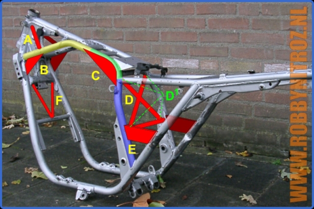

I thought they were no longer available. At least it shows the points to be reinforced. It's missing a prime area, that's below the steering head. The Z1's and KZ 900 always cracked there thus that cheesy bracket. I beefed mine up long ago and plan on more. I've also been studying another frame.
I'm looking for another frame that has a inverted T in it below the steering head. Can't find it now.
