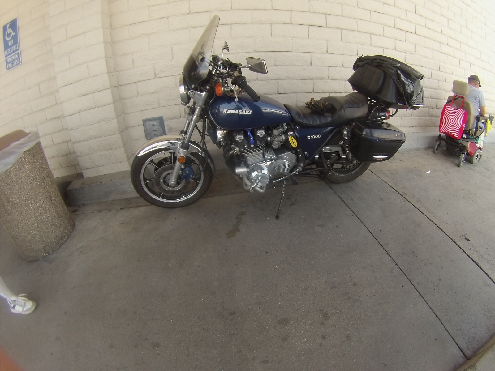

I was toying with the idea of a bladder in my top box, a small valve in line connecting to one of the fuel lines going to the carbs. Being the two lines are connected in the petcock the fuel would flow through it and run the bike while filling the tank at the same time. I'd lose my top box for storage but I have my side boxes and a carry on bag would do for clothing and such. I also have soft bags that could be strapped the the back seat for extra space. In your case a luggage rack could do the trick.
