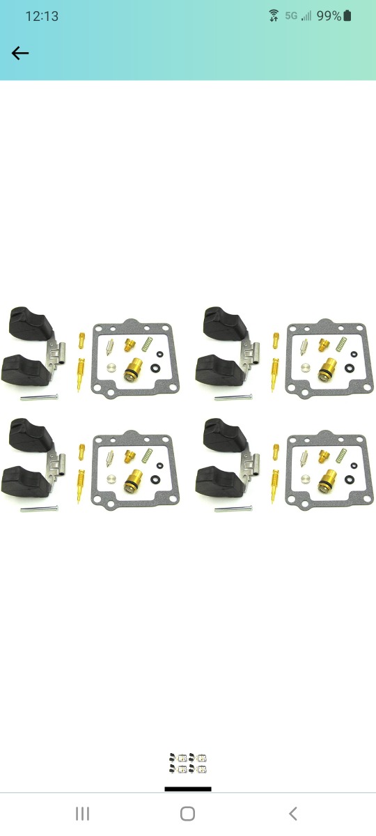

The kit I bought comes with the following jets and seats. Are these the proper ones?
Main Jet #127.5
Slow Jet #37.5
Seat #2.5
Main Jet #127.5
Slow Jet #37.5
Seat #2.5
Re: 1981 kz1000
03 Feb 2022 10:32
More than likely you won’t need jets. Brass doesn’t deteriorate. The orifice size doesn’t change from wear. Exception being the needle jet. Air velocity presses against the jet needle and can rub and distort the needle jet but it’s not super common. Problems that I have heard with aftermarket jets is they are not machined to the same quality standards that Mikuni are so you could have tuning problems from one carb to the next just because the jet orifice or machining process is not consistent.
Per Partzilla the main and pilot jet sizes you list are consistent with “Stock”
Seat? Float Seat?
Seat? Float Seat?
- jpacewic
- Posts: 20
Re: 1981 kz1000
03 Feb 2022 11:14
I am new to these mikuni carbs. I am not sure what seats are in the kit. This is a pic of the kit I bought.
