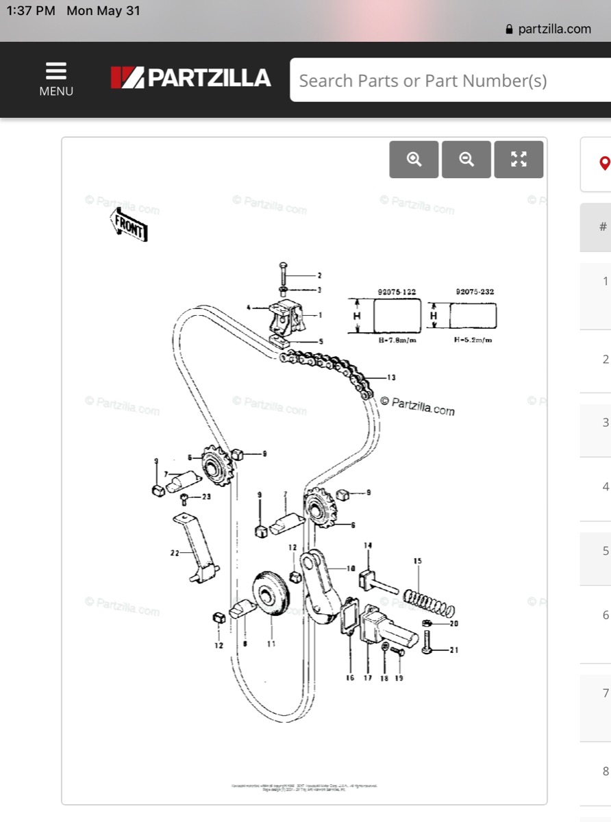

Thanks Mikaw and 73. This along with a couple other things has me a little concerned about the PO being inside this engine. The other is... something's not right with the cam chain tensioner. After I removed the tensioner I tried pushing against the ... for lack of a better word... flap that the chain rides against, the thing the tensioner pushes against to tighten up the chain. So pushing against this "flap" it doesn't make contact with the timing chain. Anyone have any ideas what's going on here?

See diaphragm. Tensioner pushes against an idler wheel #10. The flap you talking about is on the front exhaust side. It’s number 22. It keeps the cam chain from digging into the aluminum block.

#10 is what I was referring to. Pushing against it with my finger, it should make contact with the chain but it doesn't. I'm wondering if #22 either isn't in there or isn't aligned properly though. I'm going to have to pull the cams so I can see in there. This PO has me a little concerned. Supposedly he was a Harley mechanic but isn't "Harley Mechanic" kind of an oxymoron?

Have you checked cam timing? Before removing the cams the engine needs to be at TBC. But you mentioned how loose the chain is. I’d try to get the idler back on the chain and reinstall the tensioner. Get some tension on the chain before you rotate the engine. Your in a tough spot. Maybe a better mechanic than I can tell you how to safely remove the cams. I’d wait till experts chime in.

The engine doesn't need to be at TDC to remove the camshafts, just loosen all the camshaft caps a little at a time in a crossing pattern and you will have a harmonious outcome! You will need to have the crankshaft at #1&4 TDC to reinstall the cams. The engine is easy to turn with the cams removed, but you need to take care not to kink the chain on the crankshaft sprocket while turning it, nice to have about three hands. As has been mentioned, not knowing the mileage it is very possible the rubber on the various idlers and rollers is very likely very hard or disintegrated, and #22 in the schematic is very often broken, usually the result of running with a loose camchain. Also hard to know what the Hardly Mechanic did while is was in there, he painted sh#t ORANGE for God's Sake!

I did check the timing... it's off. First time I turned it over by hand to line up the marks, it jumped the chain. That's when I realized something was off with the tensioner.

31 May 2021 11:57 - 31 May 2021 11:58I’d say it’s time for a rebuild. Hopefully you didn’t bend a valve already. Not the end of the world though.I did check the timing... it's off. First time I turned it over by hand to line up the marks, it jumped the chain. That's when I realized something was off with the tensioner.
