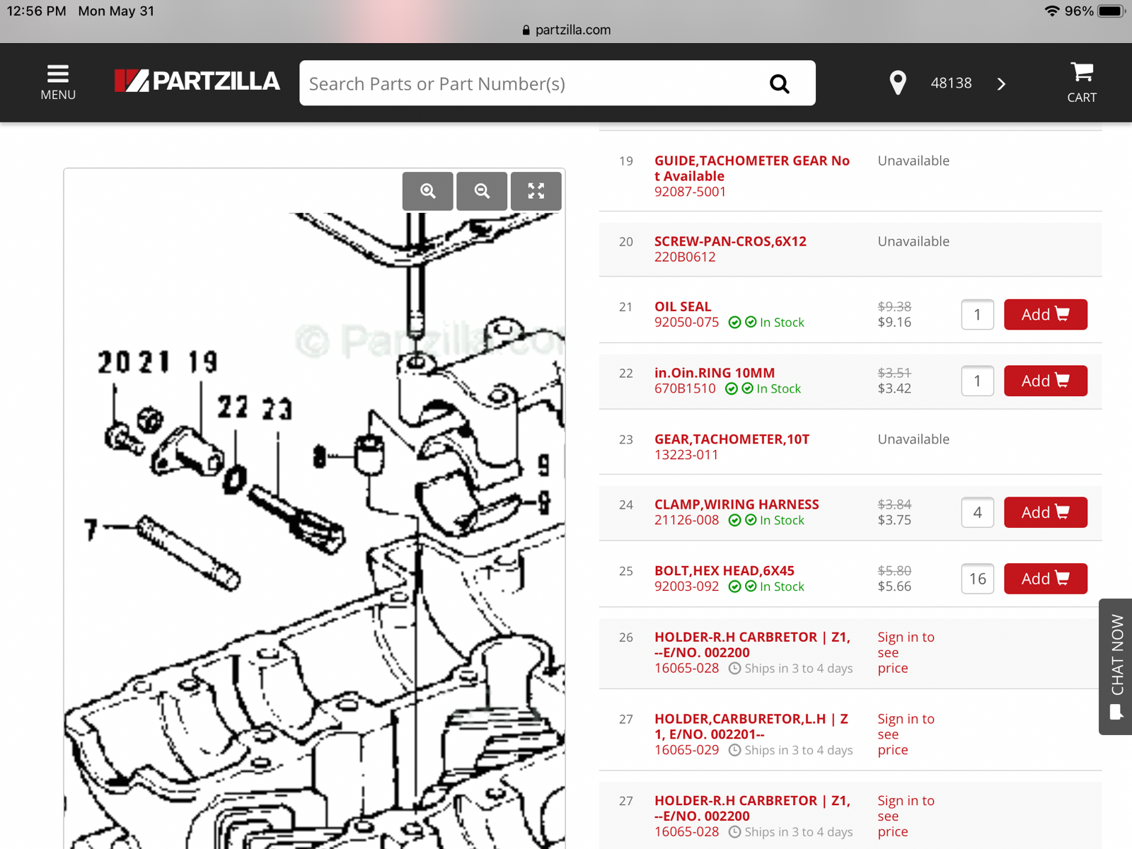

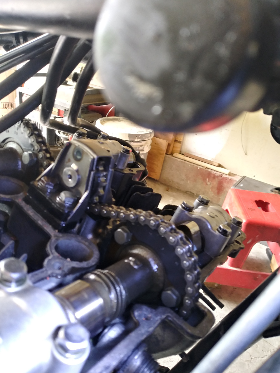

Pulled the valve cover off to check clearances and to strip off the orange paint. Couple things.... cam chain was very loose... would have jumped teeth had it been started. I removed the cam chain tensioner and it appeared to not have been released after last time it was installed. PO was obviously inside. BUT.... the thing that's got me curious is... shouldn't there be a worm drive gear attached to the back of the tach cable attach fitting? Doesn't really show too good in the picture but there's nothing back there to be driven by the tach gear on the exhaust cam. Anyone know what the thing I'm missing is called?

Re: Looking at this 73 Z1 for sale
31 May 2021 09:57 - 31 May 2021 09:58
Last edit: 31 May 2021 09:58 by Mikaw.
The following user(s) said Thank You: Robb2018
