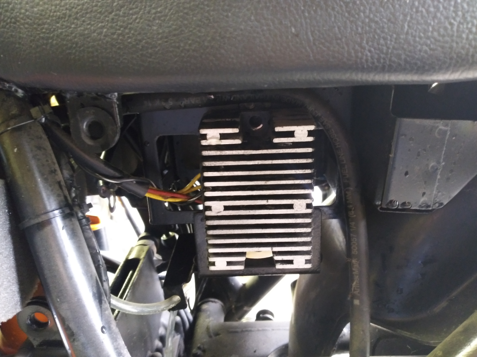

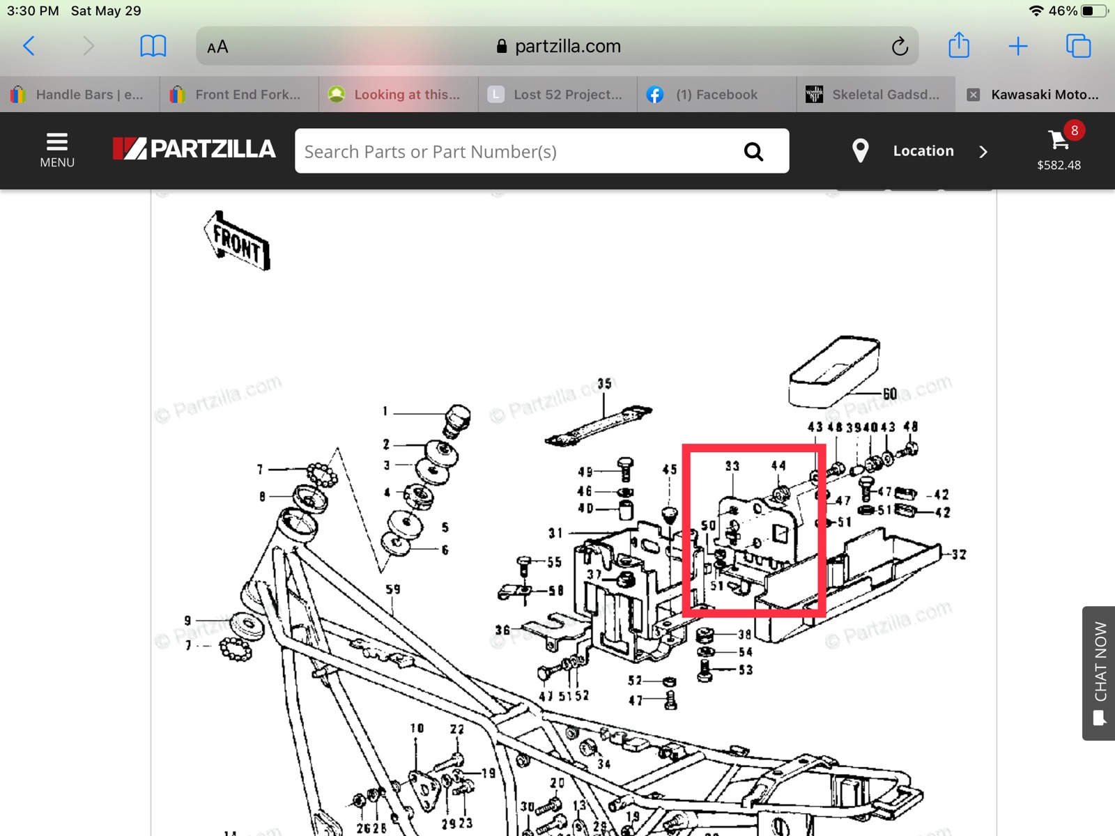

I'm trying to track down the most obvious item that's missing... hard to find because I don't know what it's even called. It's the panel that the rectifier and canon plugs attach to under the right side cover mounted on the battery box. Control board? Also, anyone who might have one they're willing to part with please message me.

No eBay APP ID and/or Cert ID defined in Kunena configurationAnd the rectifier

I don’t think they made those in 1973!
