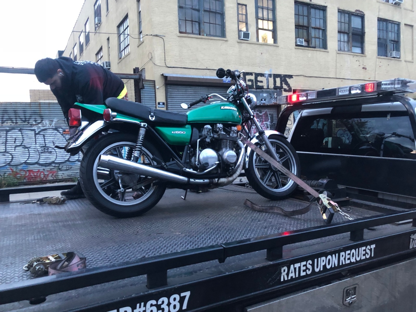

Thanks so much Joe. after 8 hours spent working on the bike yesterday, this was the end result:

Did you sell it or is it going to a mechanic?
