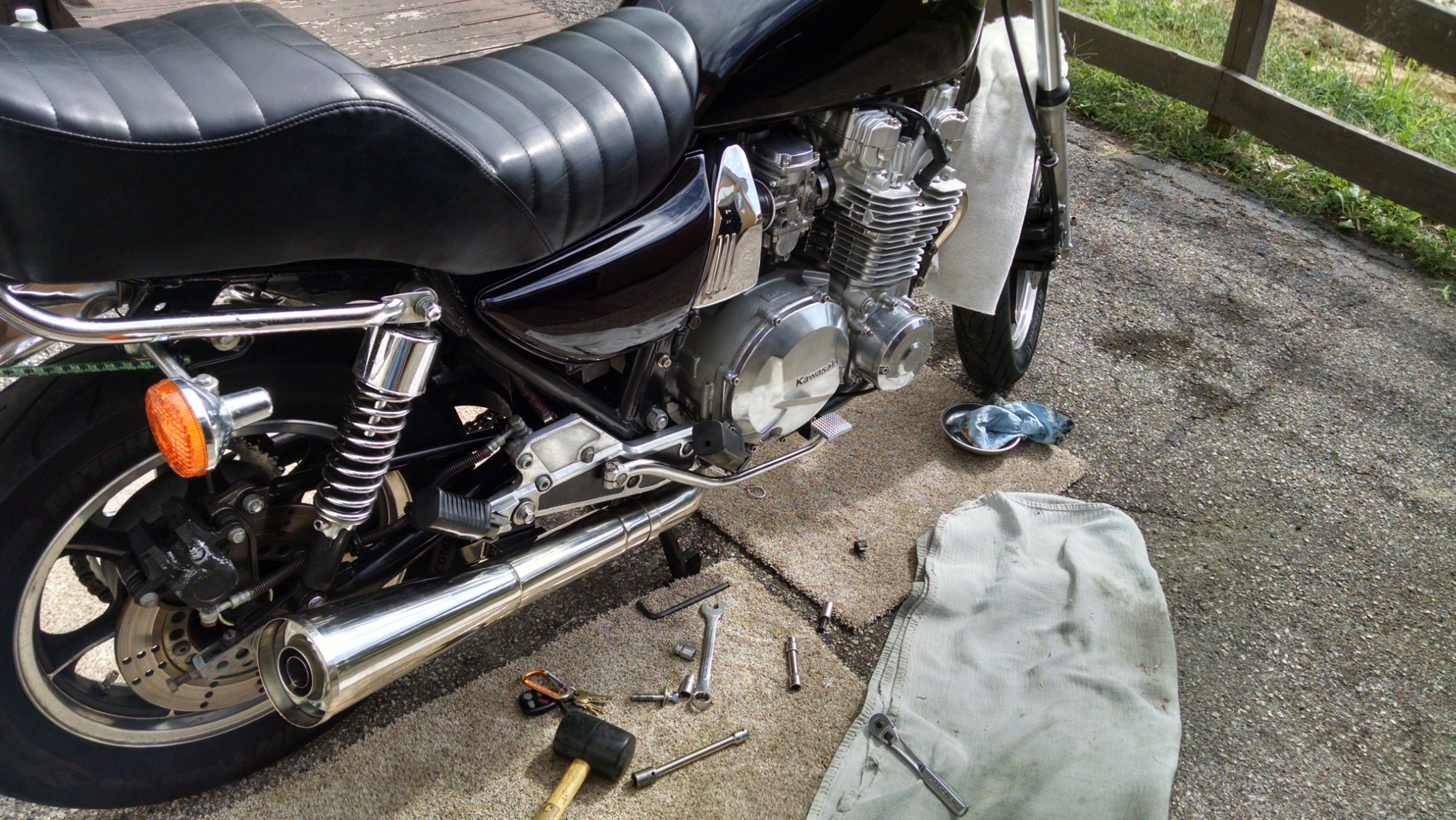

22 Oct 2018 13:24 - 22 Oct 2018 13:40old_kaw wrote: Usually, when my bike starts running progressively worse, I am running out of fuel. I know it's time to switch my petcock to reserve. (the carbs start running out of fuel) Your buddy obviously didn't fix anything, and to tell ya the truth, if something doesn't run after ANY repair, it really wasn't "repaired" at all. The main thing is that he didn't make things even worse.
Loosen up the bowl drain screws to check for fuel in the carb bowls, better yet, use a clear tube to check for fuel levels while checking. You can bypass the vacuum petcock by switching it to prime to check for fuel.
I appreciate your comment but the type of "progressively worse" I experienced is NOT low fuel in the tank.
We have yet to identify the issue but I will let you know how it turns out. I have 6 other bikes and I put the KZ650 in the garage and will come back to it. Today Im on this:
Thanks.

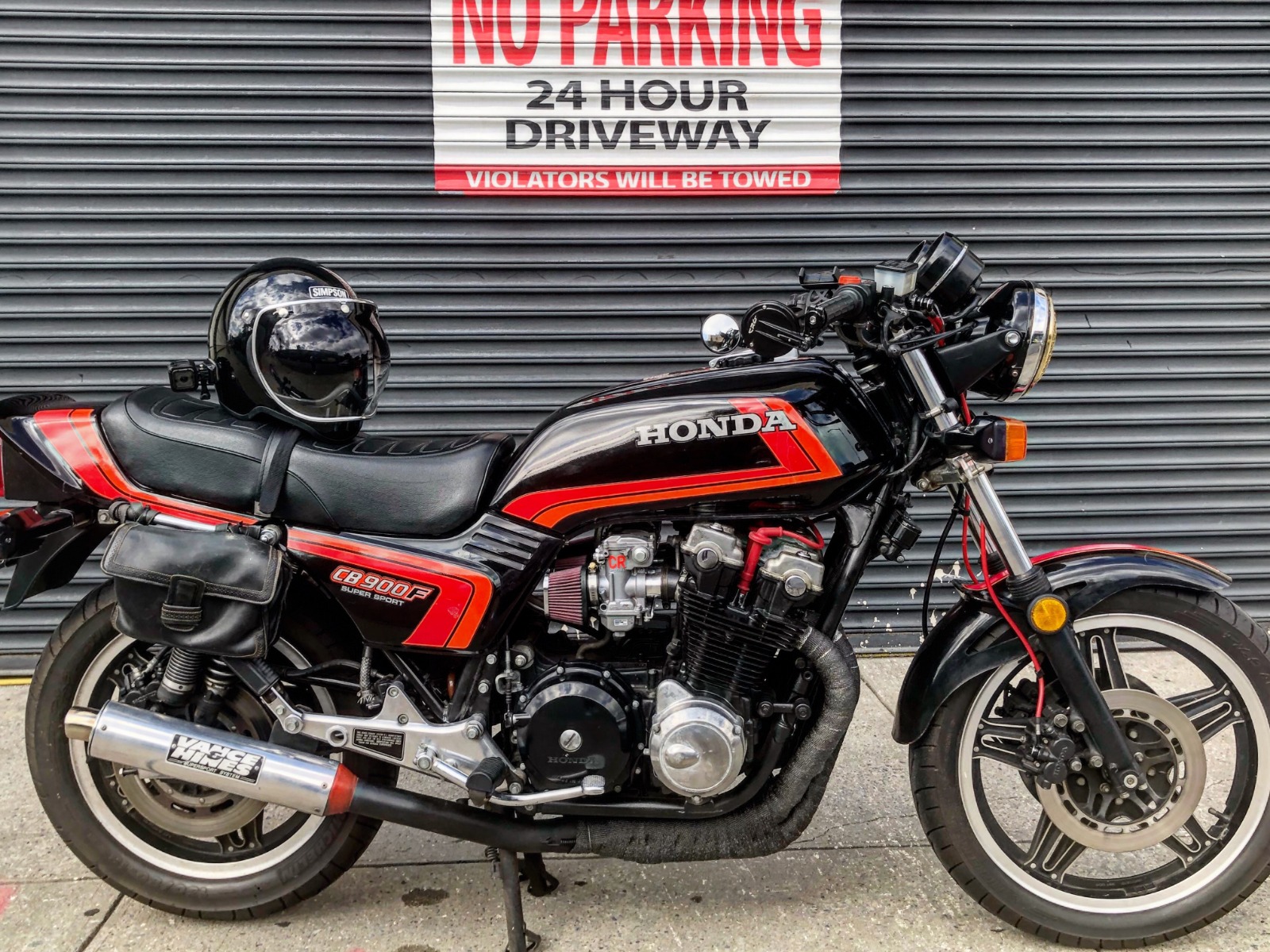

Sweet CB900F Super Sport. This was mine. (now sold) It had the "big bore kit". I couldn't keep the front wheel on the ground at closing time, but then again when it was hot on a nice warm day, it ran like crap. I attribute this to it having too high compression ratio, so that it only ran good when stone cold on a cool night. BUT in everyday riding it would sputter and ping / pop, My 99% stock old Kaw is faster 100% of the time than my modified CB900F SS. It will flat eat the loud and slow bikes.
With the running progressively worse would indicate something restricting fuel. Carbs, filter, screen, petcock, etc. Valves are also a possibility, as well but would get worse over an extended period rather than minutes. There are actually two coils, so one effects 1,4 and the other fires 2,3. Not knowing the general condition of the bike, cleanliness of the tank / fuel etc, it's even more of a guessing game, than your buddies who can actually see the bike.

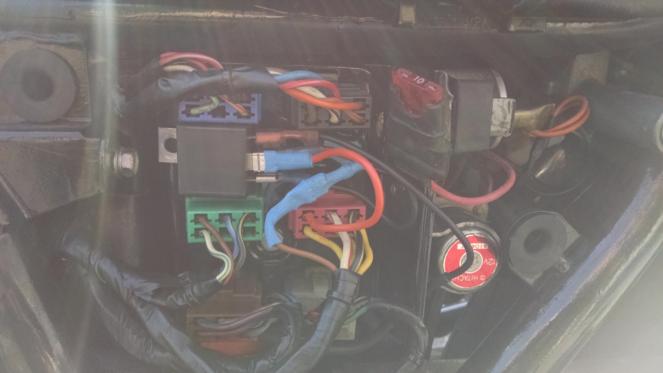

Electrical is a big one. So is fuel contamination.
I never did find the reason for my voltage drop on the brown wire to my voltage regulator, so I took the "band aid" approach and added in a relay to stop overcharging.
Sitting in the elements is not good for cats, dogs, lawnmowers AND motorcycles for many many reasons.

23 Oct 2018 18:04 - 23 Oct 2018 18:14old_kaw wrote: Sweet CB900F Super Sport. This was mine. (now sold) It had the "big bore kit". I couldn't keep the front wheel on the ground at closing time, but then again when it was hot on a nice warm day, it ran like crap. I attribute this to it having too high compression ratio, so that it only ran good when stone cold on a cool night. BUT in everyday riding it would sputter and ping / pop, My 99% stock old Kaw is faster 100% of the time than my modified CB900F SS. It will flat eat the loud and slow bikes.
There are some great folks on this board, and they give some solid advice. that reflects on their personal experiences with their own bikes. Much like myself.
Anyway, good luck on the repair.
Hey! Thanks for this good message.
I laughed when I read about the "ping and pop" on the 900F. Same thing happens to me, and the bike LOVES when its cool out.
In re the KZ650 I have an opportunity to swap the KZ650 for a KZ1000 +$1000 to the seller. Not sure what im going to do.

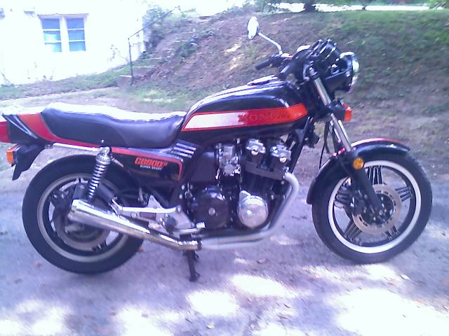

We cause spitting and poping and pinging ourselves by "improving" things to the point that the motor no longer runs properly. Pod filters, 4 into 1 exhaust, removing the air box, "big bore kits" all should be marketed as "go slow parts", because the everyday joe has no idea how an internal combustion engine runs, let alone the math involved to make it run properly.
I see your CB900F SS has pod filters, and a 4 into 1 header with whatever other "improvements" it has been blessed with. If that bike were 100% stock, it would be hard to keep the front wheel on the ground.
I recently put a Delskevic SS exhaust on my Kaw. I did not remove any baffles just for this reason. (had it out in ~60 F weather last nite). I assure you I won't be upping the CR or removing the air box anytime soon. My bike is still an animal.
Your post is full of assumptions
You think my bike was better/faster stock? Nope. After my mods, the bike was dyno tested and puts out 107 hp with the CR carbs and a few other things I did. I have all the paperwork and graphs. Stock is 95 and im at 107. it IS hard to keep my wheel on the ground. I did 140 yesterday out on long island.
