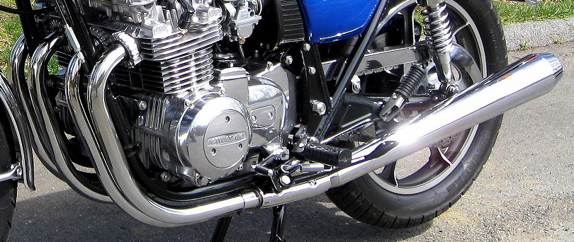

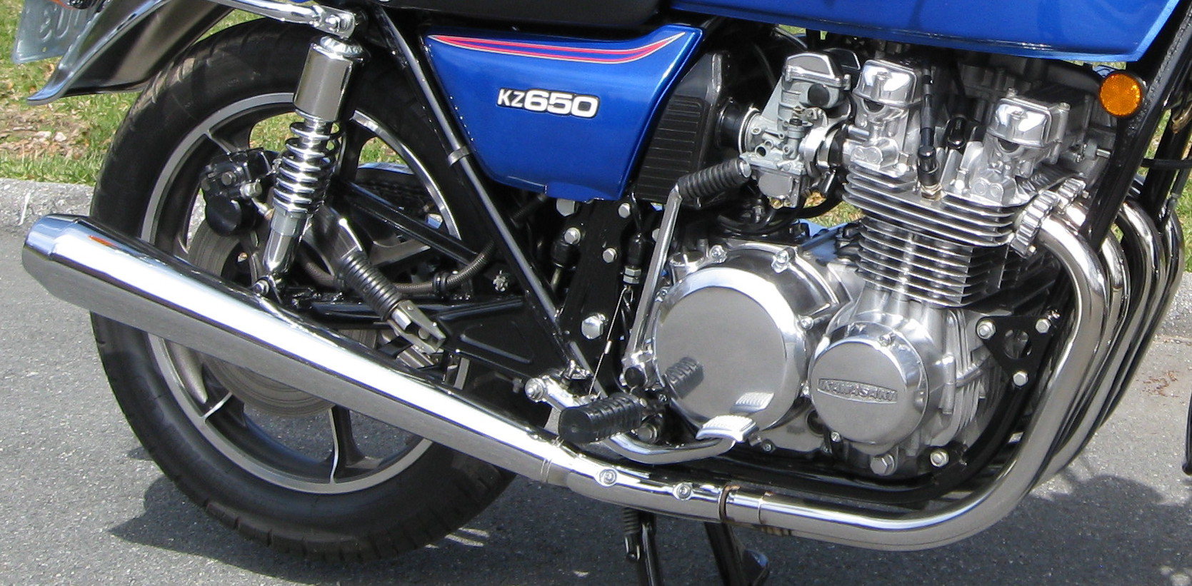

Not bad, but a much better plan is simply don't store it over the winter. Instead, start the bike once per week and run the engine for 20 minutes or so until the engine is thoroughly warmed up. Then shut off the gas and run it for a couple minutes, then shut off the engine. That's what I've done with my KZ650 in the winter for the past 20+ years, and it works extremely well for me. It keeps the battery charged, keeps oil on the cylinder walls, and prevents gum from forming in the carbs. Another plus is that when the first warm day of spring arrives I know the bike is ready to ride since it hasn't been in hibernation over the winter. Ed

I've owned my bike since it was new (41+ years) and it still has the original exhaust; there is no rust. I believe the key is letting the bike run long enough to get the engine and exhaust system hot. At that point any condensation that would have been in the system evaporates and is gone. I can only say that the method I described works well for me. Ed
