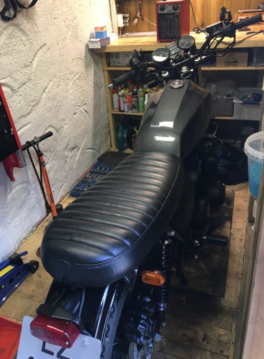

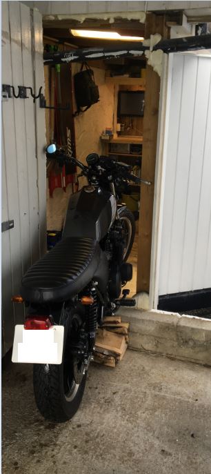

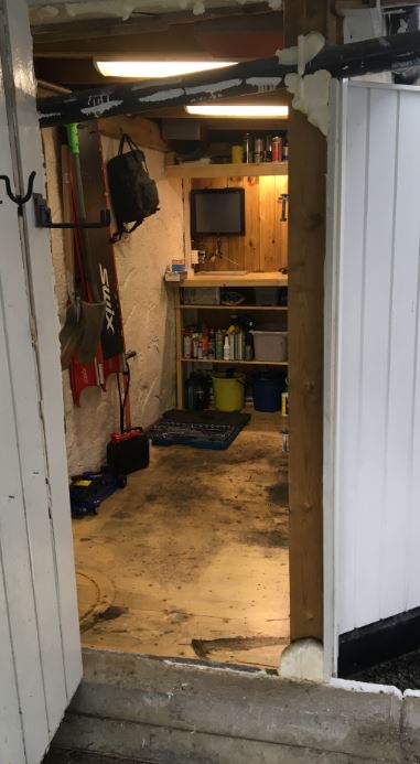

After some thinking back and forth.... I don`t liked the idea to store the bike outside after putting so much hours and money into the bike...
So I wanted try to squeeze into my smal workshop...
I manage to get the bike inside, but it will not be so good place to working on the bike... but know I think the bike will be stored safe from cold weather... corrosion etc...
The workshop is not insulated.. but I have install a panel heater... my question is what shall I set the temperature to, some says above 50 ℉, if under I will get condensation problems, is that correct ? What is more safe ? 55 ℉ ?

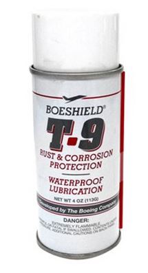

I use Boeshield T9 on my tools and they do not rust. I haven't gotten the tools wet, so I cannot say how well it would protect steel against rain, etc., but I can say that it totally stopped the rusting problem that I previously experienced on tools that were hanging in my workshop (I live in an area that often has very high humidity). I apply it and it takes a few days for it to fully dry. Once dry I cannot tell it is still there, but I know it is because it keeps working. I've used it for several years and have not needed to re-apply it. Ed

I personally don't use a heater, I think they are dangerous,
It's good that you have a wood floor.
Typically winters are low humidity, I think the problem with condensation happens in the Spring with the thaw.
In the spring we get a wet concrete from the moisture getting drawn to the cold floor.

I agree the fan heater type is dangerous, but I have installed passive one, something like these:
www.power.no/hjem-og-fritid/varmeprodukt...0-panelovn/p-114702/
They should be safe to use...?
I have set it to 15 degree celcius now.

Now that it is in a shed, it will be much better.
Like BlueJ said, now it will not get daily condensation like it would in the spring. It may still get some on extreme temperature changes (warm day after a cold day), but it will be better than getting condensation every morning. It doesn't take much to keep off the condensation in an enclosed space.
