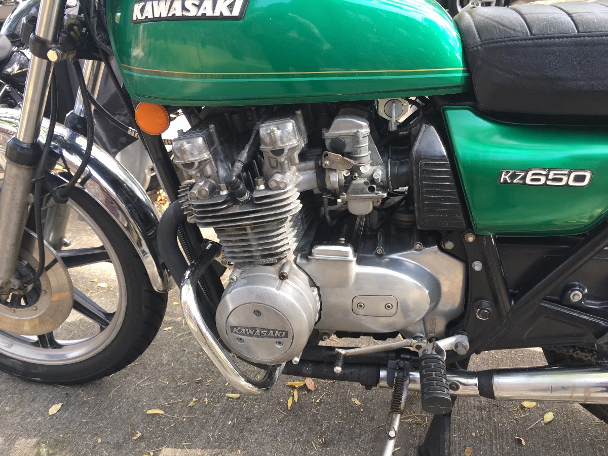

Im so sick of trying to polish these stupid fins. I DESPERATELY want to paint this engine fins black. I probably wont paint the engine cam covers black but can I just do this with a rattle can using high temp paint?
Here is my bike
Here is my bike
1977 Kawasaki KZ650B
1977 Kawasaki KZ750 Twin

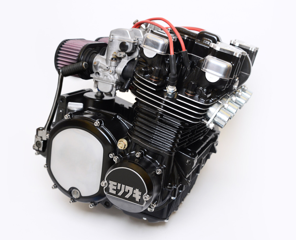

Yeah by buddy told me a little earlier in the day that PJ1 was best and that Rustoleum would be a disaster. Im thinking of doing the WHOLE thing black now. Should I scuff the chrome with scotchbrite on the clutch cover etc? I saw this photo and it looks awesome.

Thanks! The delivery time for the PJ1 is quite a while so Im going to take our suggestion and get the Duplicolor! Do I really need clearcoat on top of the paint? I dont want my aircooled engine to run hotter because its smothered.

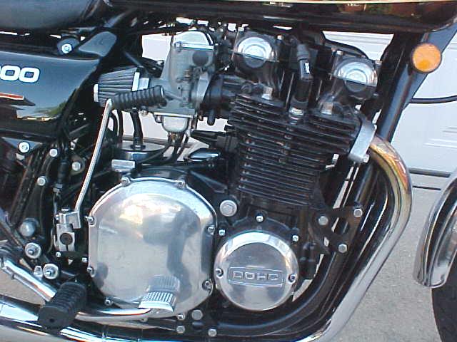

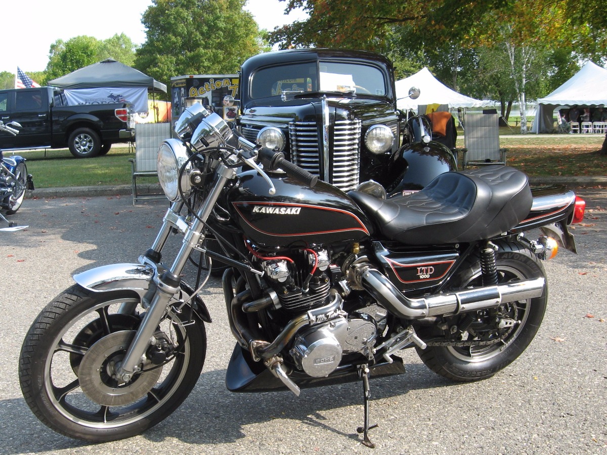

- Posts: 5074
- Thanks: 2277
Re: Can I simply RATTLE CAN my engine black?
24 Feb 2018 16:36
I used gloss black and prefer the look over flat.
Prep is critical for a good job. Better with motor out of the frame but it is up to you
Along with wire wheel / scotchbrite / and picks for the nooks and crannys I would power wash and blow dry with a air compressor
All Black is nice , but I prefer some contrast on my motors.
Once painted and cured ( Run it and drive it for paint to setup.
I like taking a metal file and 2x4 wrapped in emery cloth to clean off the fin edges on the cylinder head
See attached pictures of my bike and Doctor rots motor
