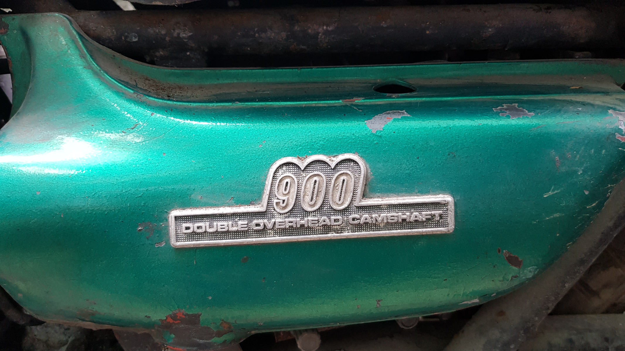

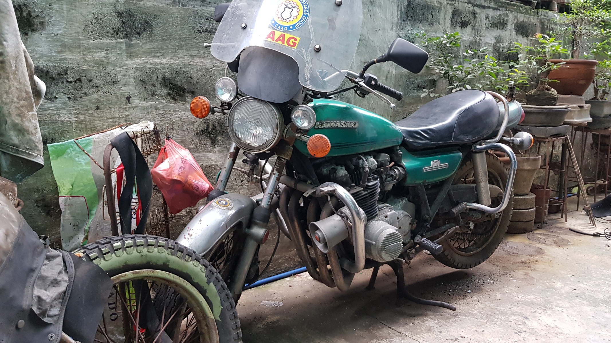

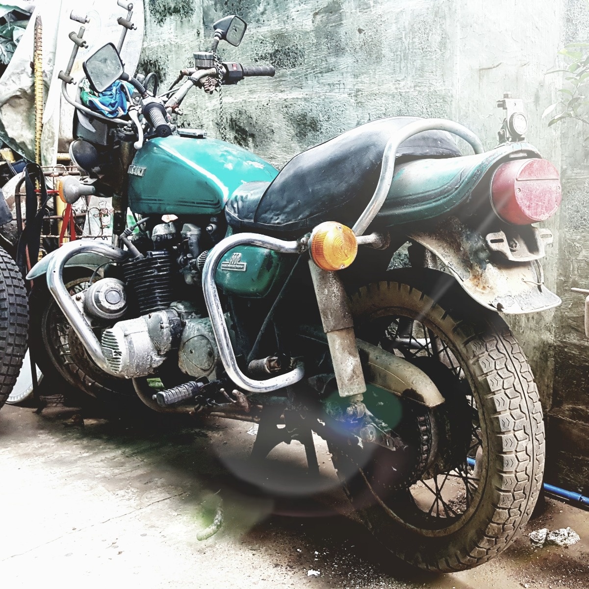

Just discovered this thread 2 days ago while I was pipe dreaming. I'm from the Philippines and currently own a 1975 Kawasaki 750RS ZII/Z2. Mine had a funny story actually. It was posted in one of the local motorcycle groups simply as "Kawasaki 900". Side covers had the 900 emblem as well, and papers simply had it listed as "Kawasaki 900".
Paid the seller up front and took the bike home for cleaning. However..... upon brushing off the engine.... it says "746cc". Worse, the wiring diagram/tool pan in the tail is in Japanese and actually says Z2. Not that I'm complaining, just a fun/interesting story. Bike's been with the family for over 30 years... original owner who passed away might be rolling in his grave right now.. all his life he probably has been showing it off as a "Kawasaki 900" when in fact it's not a Z1, but a Z2! lol
Anyway, was pipedreaming of a possible 76x58mm high revving Z2.. couldn't find results when searching in Japanese too - luckily, I stumbled upon your build. Sad you ditched the Z2 crank.... anyway, bike sounds good and seems real fast!!! how much more for an 1105cc! (I know someone locally who owns a Z1R with an 1105cc Wiseco kit, Mikuni RS36 carbs,as well as a real deal Kerker sidewinder exhaust installed.)
Good job with the Z!!!!! Hope I come up with the funds I need to either rebuild the bike as a 746, or actually realize my 76x58mm high rpm screamer pipe dream, or just get the 1105cc engine. Need to work harder it is!

Those look like VM 26 carbs. I'd like to see a better pic of the stator cover too. Automotive shocks? The crash bars look beefy.
- Posts: 3158
- Thanks: 1252
Re: Z2 750 crank (Bossie the Kaw)
14 Mar 2019 12:44
I think you're right on the carbs. VM26SS. The original carbs were VM26SC with the same flat tops and the Z1's. I prefer the SS carbs because they are simpler to set up and maintain. But for originality I have to use the SC carbs.
