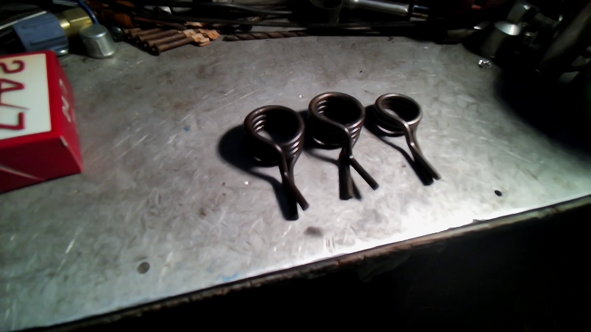

I bought a gear selector and the shaft looks new, The Z1's had a 3 wind spring and the later were 4 wind so they wouldn't break as easy. It's a common upgrade now. I need just the shift lever if you have one. Thanks

Actually spring differences were based on clearance Not strength the difference between the 3 and 4 coiled springs, don't be fooled.

The spring fits fine. The extra coil allows it to expand less thus less stress on the coil. Been using them for years.

16 Aug 2025 21:17The difference between the Z1 and KZ 1000 springs.
