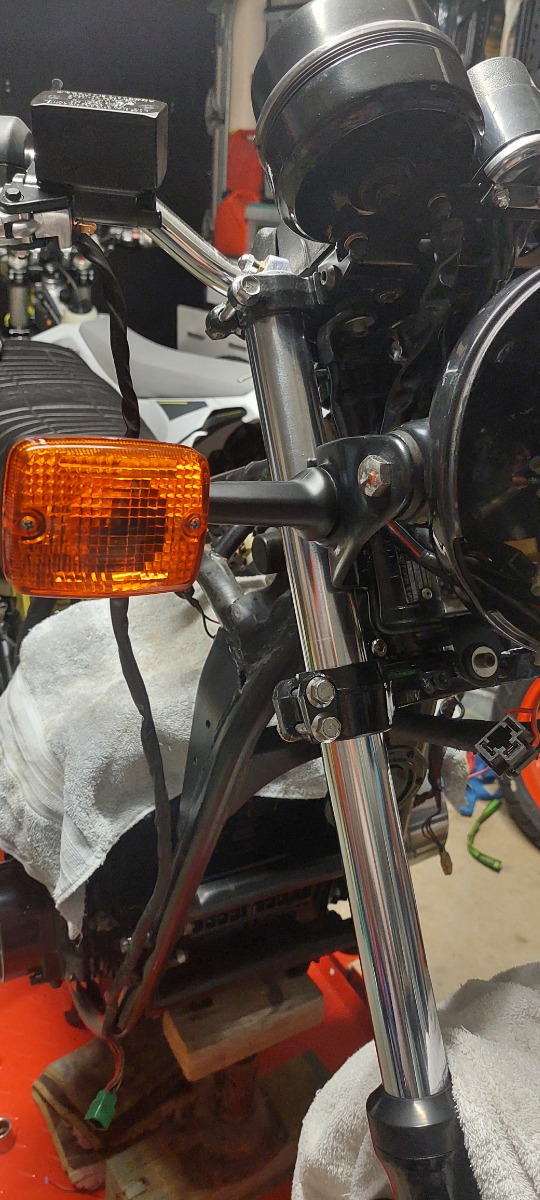

Meanwhile, new Meter Bracket and Blinkers have turned up from Webike, so thought I'd try and fit them up:

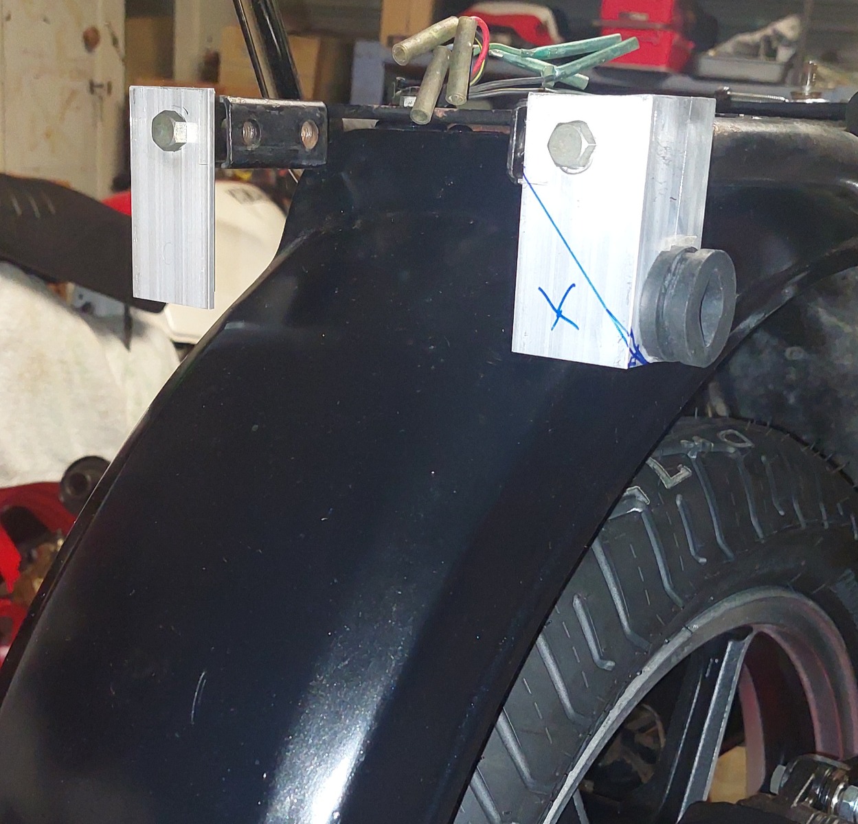

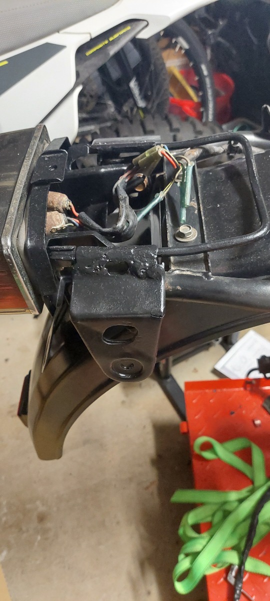

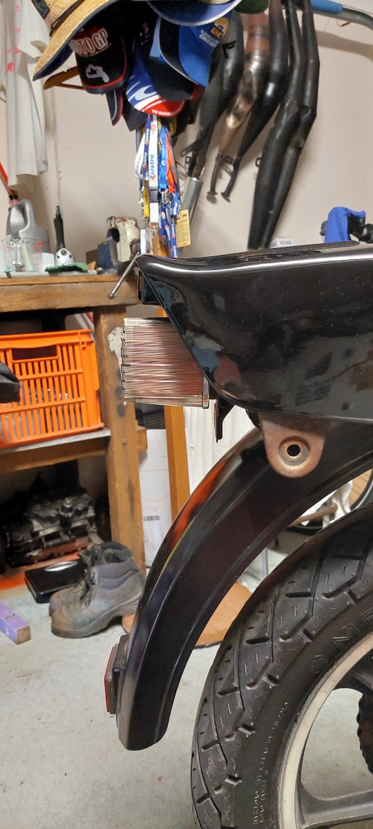

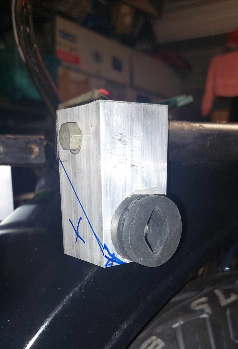

Rears - PO dodgy'd up some front headlight/blinker mount, so the only hole showing below the ducktail is the round hole for the headlight, do I try and dremel the diamond shaped hole in the bracket or grind away the plastic on the blinker to fit the round hole?

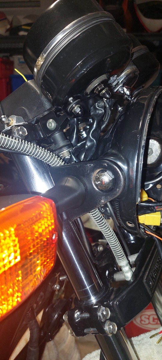

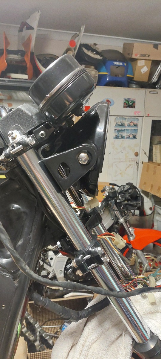

Fronts - Fitted the blinkers and attached the headlight shell, check out the gap between the meters and the shell, something weird going on here...Any clues??
The modified headlight/indicator bracket po used for the rear indicators kind of fits, the arms are welded on very close to the top attachment points, this had the headlight touching the meters, for now I've just fitted a spacer to provide some clearance and made a new lower attachment point (original bracket was cut off).

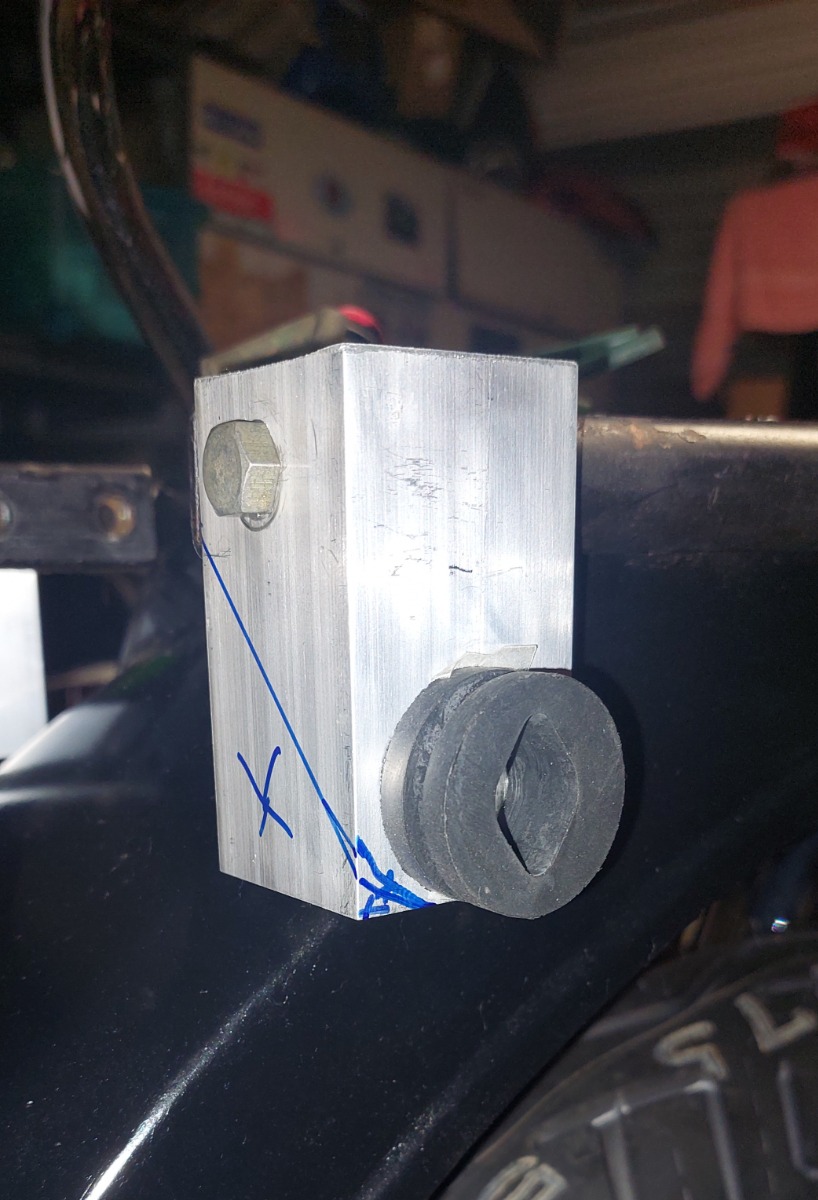

So now I need to come up with a bracket to hang the rear indicators, this is what I've come up with so far, once I've dremeled the "diamond" shaped hole for the grommet I'll trim off the excess metal around it and paint it black, once the ducktail and tail light are fitted I think it will look ok.

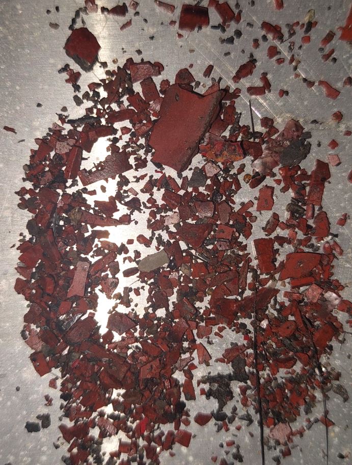

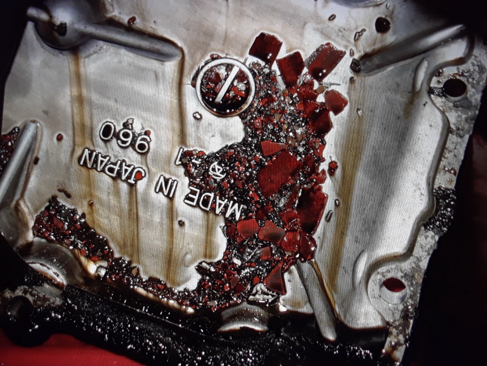

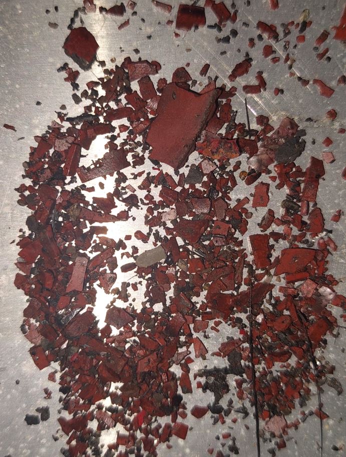

I removed the sump cover so I could check the oil pump screen, lucky I did it's full of crud...plus a grease like muck covering the bottom of the cover and heaps of this stuff
it looks like a red Bakelite type product?? Is there anything made out of that inside the motor?

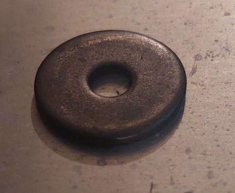

Also found this washer in there, have no idea where that's from?

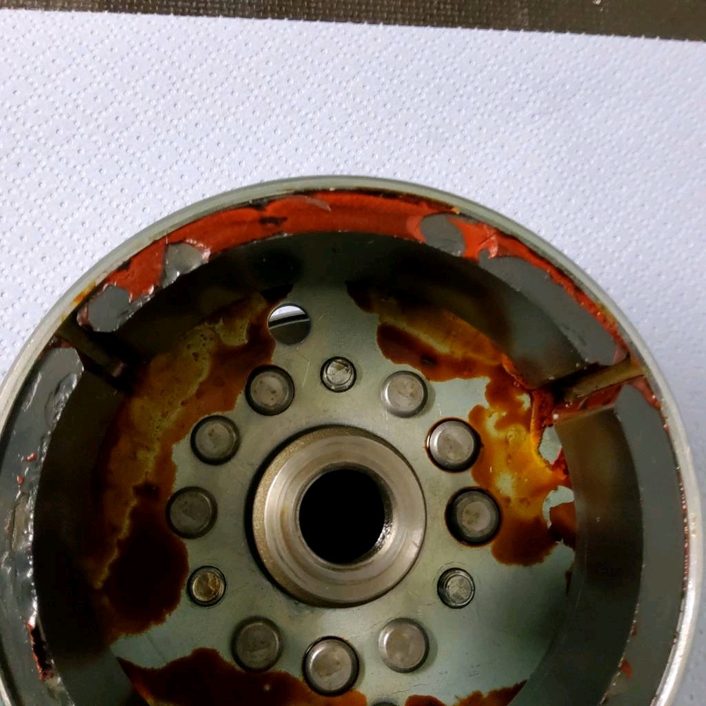

Yep just keeps getting better....
Not much I can do about it except to remove whatever coating is remaining, I'm going to assume it will still work without the coating??

I guess you would need to see how bad it is, I believe this is the adhesive that holds the magnets in place not just a coating

I was just thinking about what the coating does...
I'll get the cover off tomorrow and have a look and take it from there.
Thanks Wookie

23 May 2025 03:52 - 23 May 2025 03:55The magnets would be too brittle if they were just solid magnets so they are magnet /steel laminates which reduces eddy currents. The coating is to stop the steel oxidising which would cause the laminates to seperate. You can paint/coat them with anything heat resistant as long as its air tight.I was just thinking about what the coating does...
