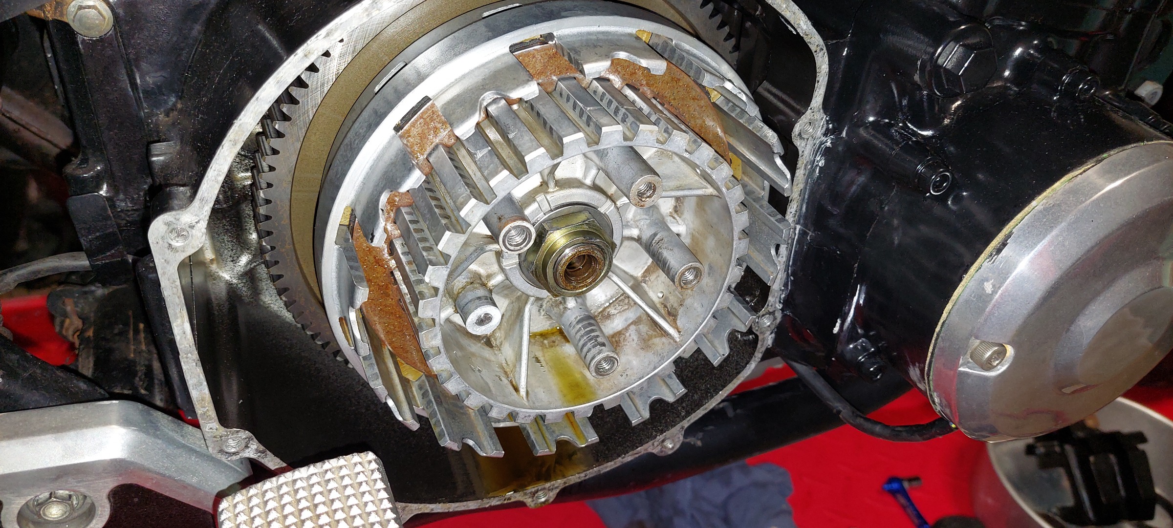

Clutch Cover was leaking oil, pulled it off to discover it had no gasket just some poorly applied sealant/goo, thought I best measure the clutch plates whilst I'm here, 1st spring bolt I went to loosen just snapped off with the hub post, I later discovered the post had previously been broken and had a bolt inserted from rear side but was too long and the spring bolt had bottomed out on it and had cracked.
It gets better, noticed how loose the clutch housing was so I took it off to measure the housing inner and bearing collar outer, that's when I found the large crack in the housing...parts are on their way from CMSNL...

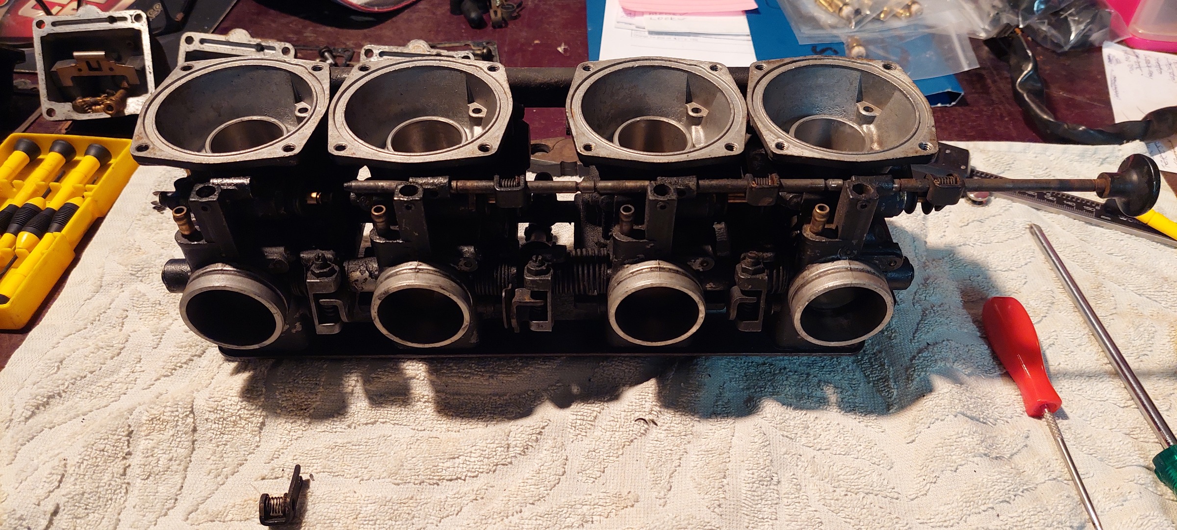

I haven't mentioned all the minor issues like all the stripped threads, broken bolts, perished rubbers, frayed cables, painted carbs that don't look very pretty after fuel had leaked on them....

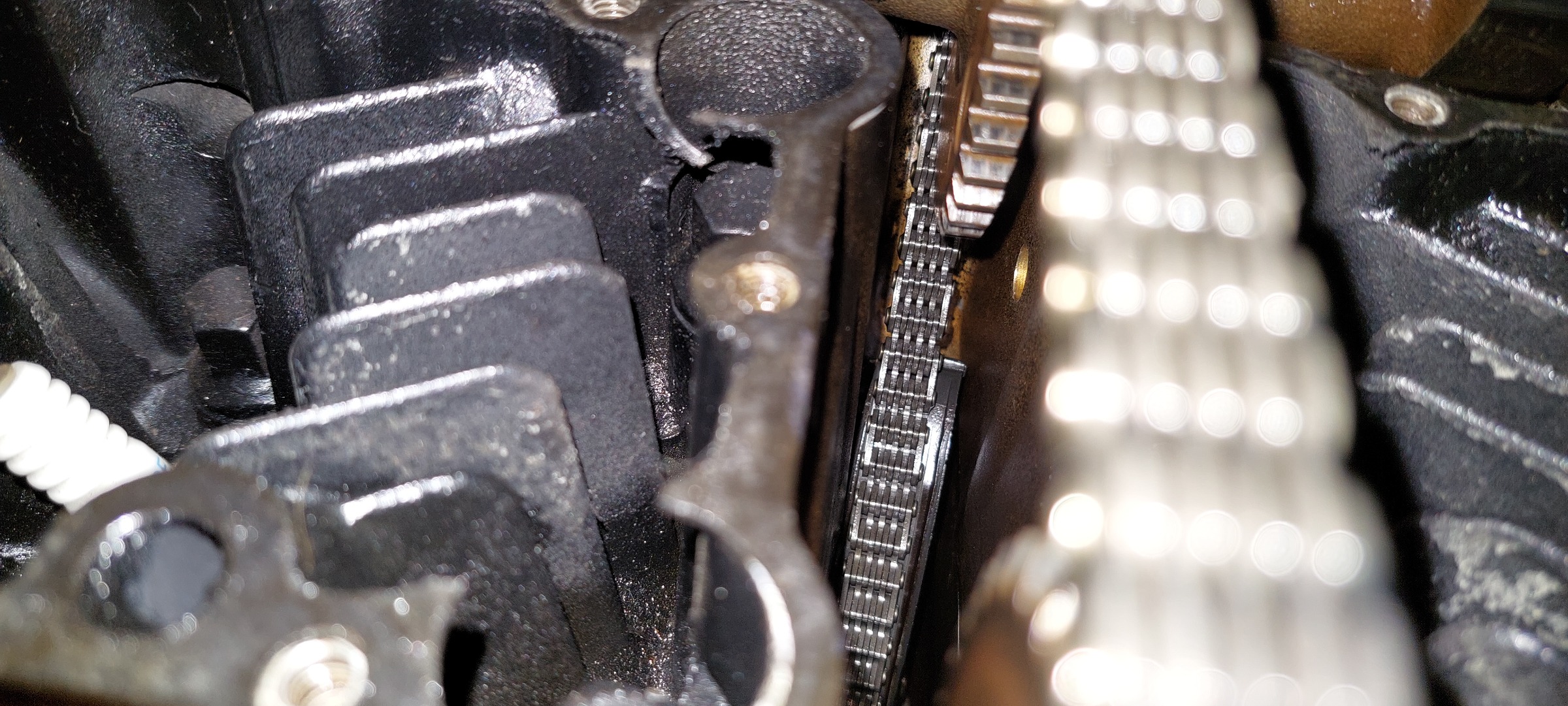

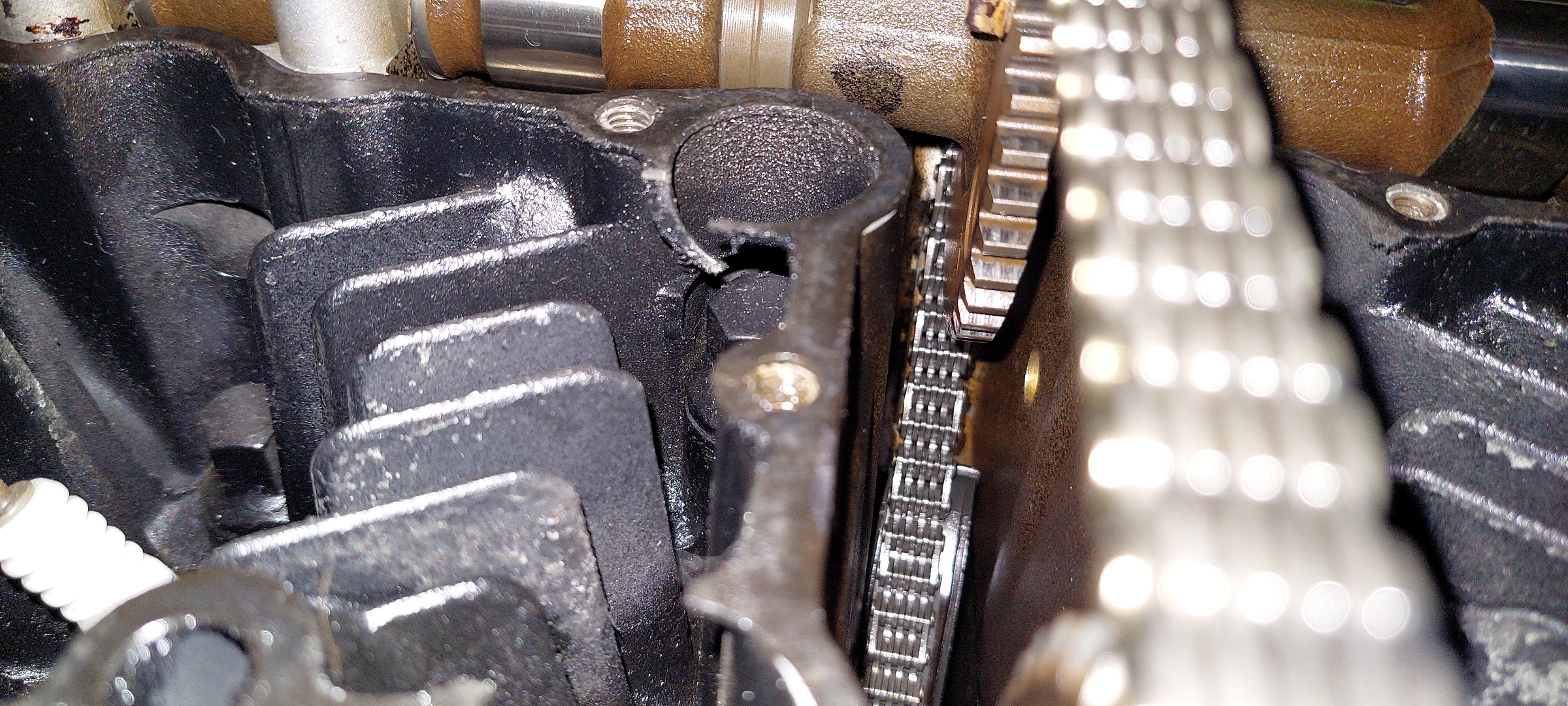

I have noticed the Cam Chain is not aligned with the cam sprocket where it runs down into the engine on the tensioner side, it veers off to the right side, almost touching the side of the tunnel, I'm out of my depth here, can somebody give me some guidance on what could be the problem???
It was difficult to get a photo, these are taken from the exhaust side looking towards the inlet side.
Also photos of my lovely black carbs and the broken clutch hub post...

Are the cam caps in the correct position (one cap on each cam controls the lateral position of the cams) hard to tell from the pic but it looks like the cams aren't central ??

I reckon the other possibility is that the chain has jumped off the crankshaft sprocket.

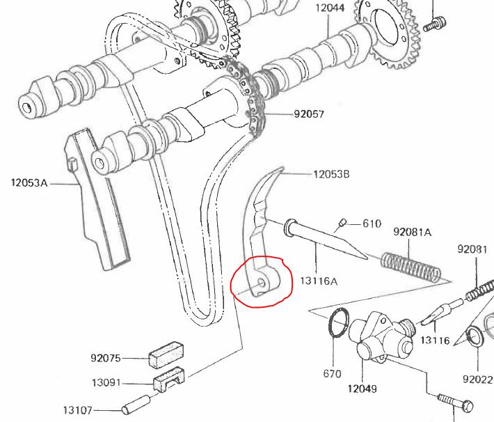

Looks like the rear cam chain guide (12053-1049) is broken at the locating shaft (13091-1084) area .

Just checked the cam caps, all in correct positions and torqued to specs.
I can turn the crank easily, no noises, chain is rotating around the crank sprocket.
I'm thinking Scirocco might be on the money, the guide should be vertical not leaning hard to the one side so it makes sense that it could be broken at it's attachment point, unfortunately that's going to require a major strip down.....aarrrgh

If you remove the tensioner and push the guide back does the chain fall into line ? have you got pics that show the ends of the cams ?

Kind of, I removed the tensioner and yes it comes back into line but when I poke my finger through the tensioner hole I can easily move the guide side to side and quite a way forwards but not upwards so it appears to be still attached at the bottom.
Hope that makes sense??

Unfortunately that definitely looks like the guide is f~@*'d it should pivot forwards and backwards but that much "twist" and sideways movement suggests it's time to get your hands dirty

Thanks everyone, with the resources here and the manual I'm reasonably confident of getting it done...CMSNL looks to have most of the parts I may need with the exception of the Holder, Cam Chain Guide 13091-1084
