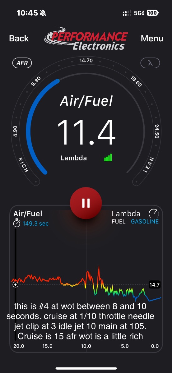

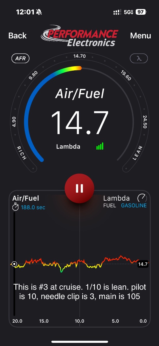

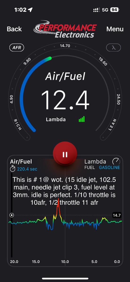

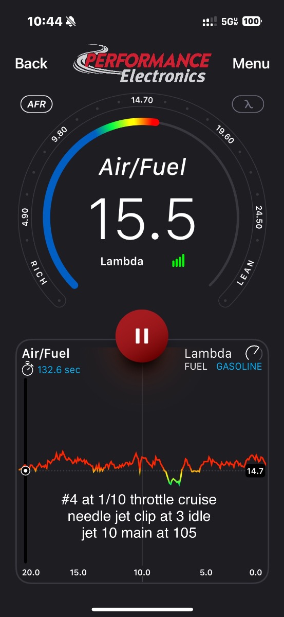

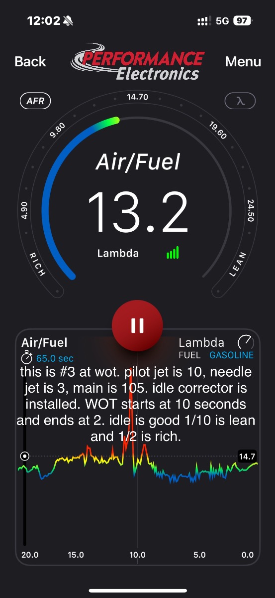

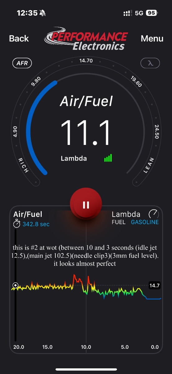

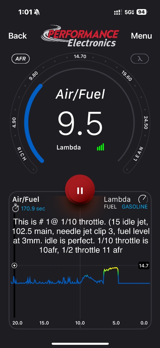

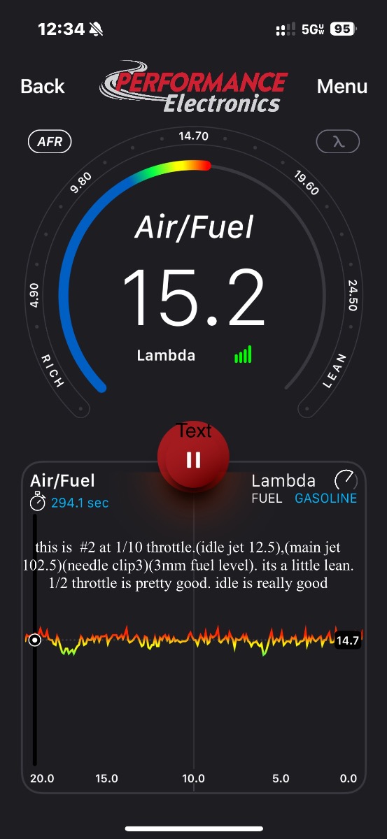

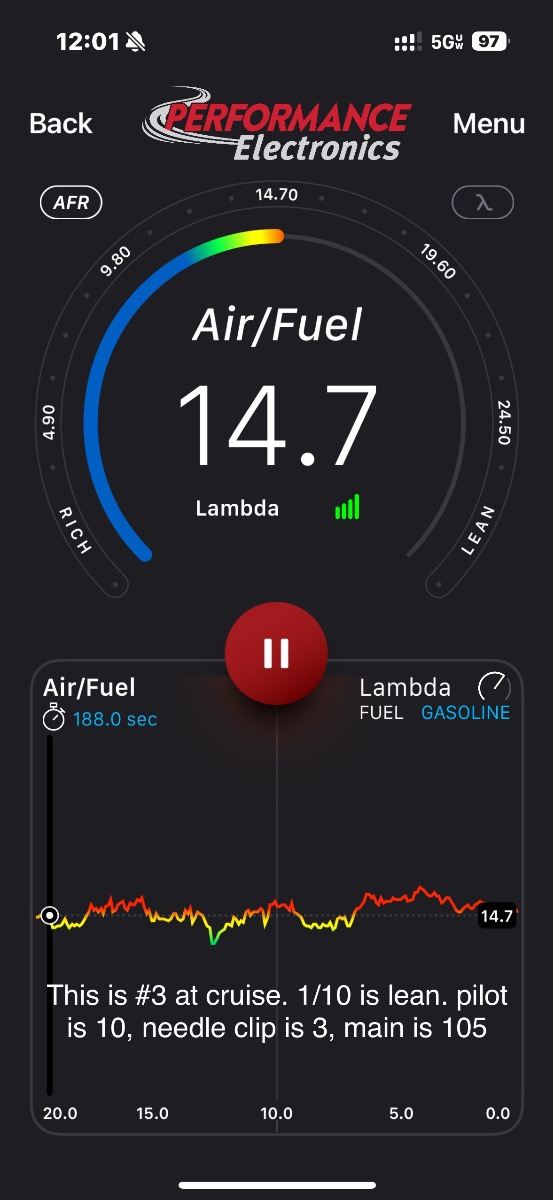

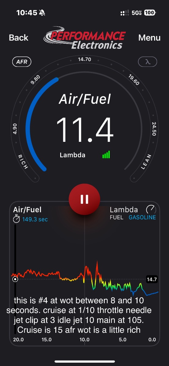

added the air corrector jets. set all the needles to 3 and set all the fuel service levels to 3mm and put pringle petcock on. Bike is much more responsive. these are the afr curves after the changes. it an improvement. I still have problems but thats what happens when you change everything. I havent compared the before and after on the afr curves yet but i will. I dont know anyone uploading afr curves to chatgpt to tune a carb but it does seem to do a good job of reading the curves and making suggestions. you still have to take it with a grain of salt but here is its suggestion.
FINAL PER-CYLINDER INSTRUCTIONS (PRINT THIS)CylChange needle clipChange pilot jetChange main jetNotes#1Clip 3 → 2 (leaner)Stay at 15Keep 102.5Rich low/mid, good WOT#2Clip 3 → 4 (richer)If still lean → 12.5 → 15Keep 102.5Lean 1/10 only#3Clip 3 → 2 (leaner)10 → 12.5Keep 105WOT dead perfect#4Clip 3 → 4 (richer)10 → 12.5Keep 105Lean low, rich top

Looking at how rich #1 is at 1/10 throttle you may have a leaking choke plunger

I’m leaning towards needles because I have to make a few changes on the needles anyways but I cant say it’s not on my list too. Im leaning to needles because all 4 carbs idle perfectly and they respond to the idle adjustment screw like i would expect. However, I cant remember if it was #1 or #4 that was probably closer to 2.25 turns out than 1.33. If the needle doesnt bring in the 1/10 I’ll do another leak down on the choke circuit or maybe it will be convenient and I’ll do it while im setting needles. I always have to convince myself that carbs take a long time of fiddling with and if I get in a hurry I’ll lose patience.
#3 needle valve was stuck open and may have skewed things. I got lucky and closed the petcock and drained the bowl to put the fuel service level tube on. I assume that when I opened the petcock back back up it reset the needle valve or flushed some crap out because it sealed right back up and went to 3mm and didnt stick open again.
It was really nice to jump 4 or 5 jet sizes by having ai analyze the curves though. Its allot of work to define what area of the curve ai should analyze. you have to tell it which carb and the time segments, and feed it information about all the jets and what the afr is on other circuits that arent in the curve its analyzing.it doesnt help that i have to be very careful to not let it run in a lean condition under load for too long becasue that how you destroy valves and pistons. So it was critical to get the idle circuits correct right away so that I had a safe place for the motor to recover when tuning wot and mid that would go very lean.
The air corrector jets definitely helped in the transition from cruise to wot and im certain it will get even better. I wish I could just take everyone’s proven suggestions but I think this bike probably in rougher shape internally than what it should be.

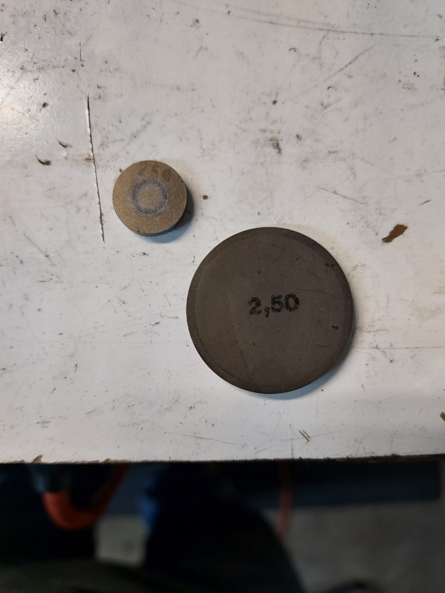

Nice thread and discussions on carb tuning! You asked for ideas on getting more oomph out of a 47 year old KZ. If you do pull the head off, consider changing over to a shim under bucket valve train set up. KZ650/750 retainers and buckets make the switch from 29mm diameter to 13mm diameter shims a breeze. Saving quite a bit of moving valve train weight on quick throttle responses. Also, makes for a little peace of mind if you tend to rev at higher rpms. The drawback--- you need to pull the cams when you make valve clearance adjustments. Ultimately, a personal decision for most folks. I don't mind the extra steps as I've had multiple KZ550s, KZ650s and KZ750s over the years and am comfortable with the procedure.
13mm on the left (3 gr), 29mm on the right (13gr). Both are 2.50mm thick

Thank you and that is a fantastic idea. The stock shims are gigantic. I do love the feel of a free revving engine.
