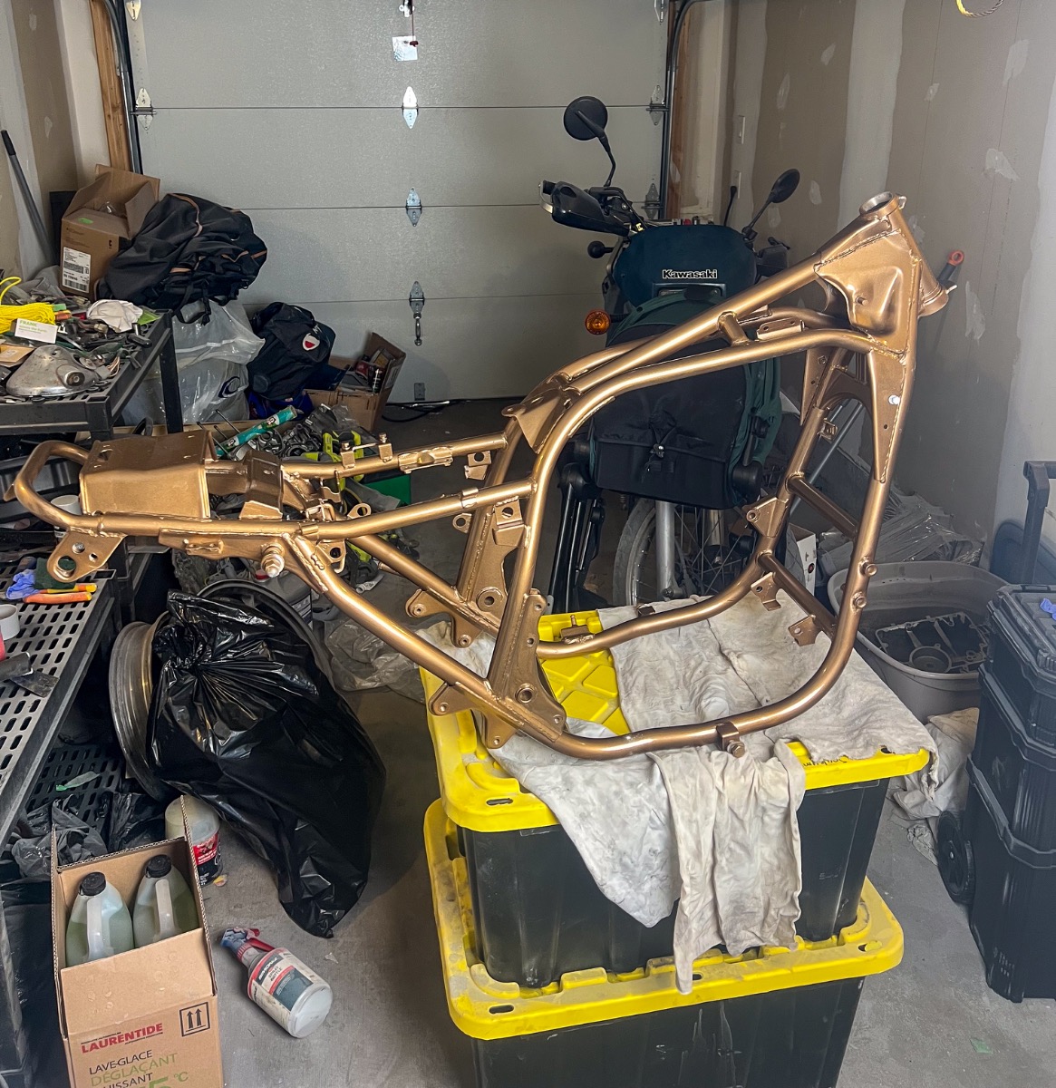

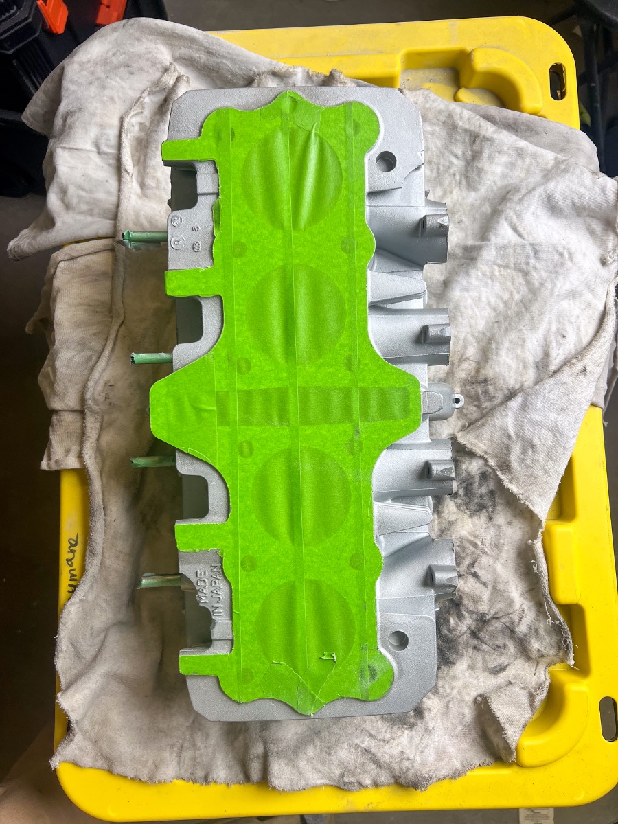

Hello fellas, three months since my last post. Hope you guys enjoy the holidays and I hope you're all having a great 2025. Happy new year! I have been busy with work and family, my son is now six months old and he crawls. He he assaulted me a few times by trying to rip my beard off of my face or to simply rip my face off of my skull. He has very strong hands and sharp nails. I have been working on the bike. Here are the updates:

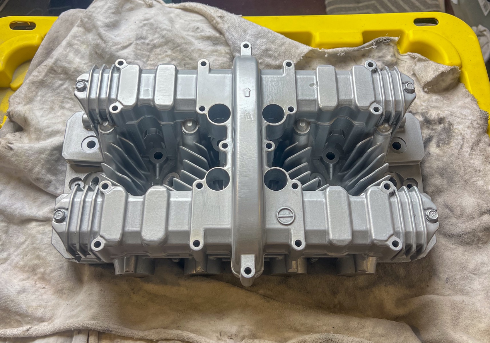

The head is finally back from the machine shop!! They gutted me with a 2,000$ bill, apparently the head was not cooperative. Lesson learned, should've just bought a new engine, I saw some upgraded ones for around 2,500$. Oh well, you live and you learn. It does feel good to have a "Brand New" head though. I painted it too.

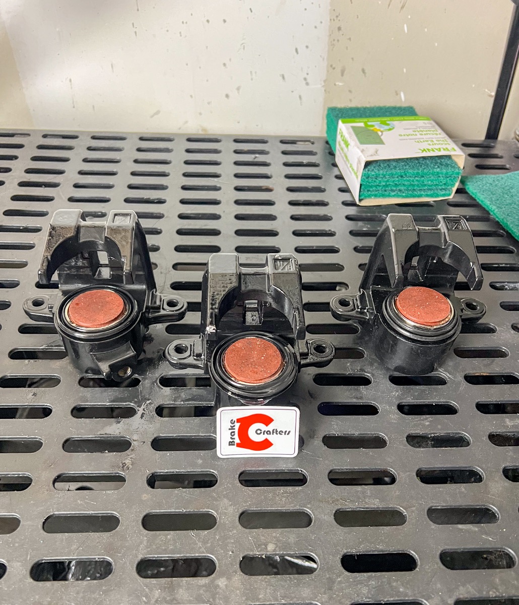

I also rebuilt and painted my brake calipers and brackets :

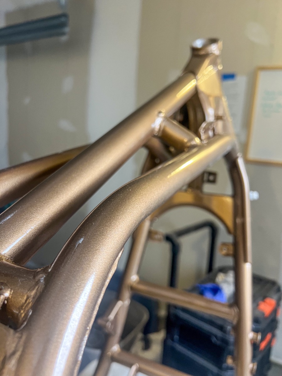

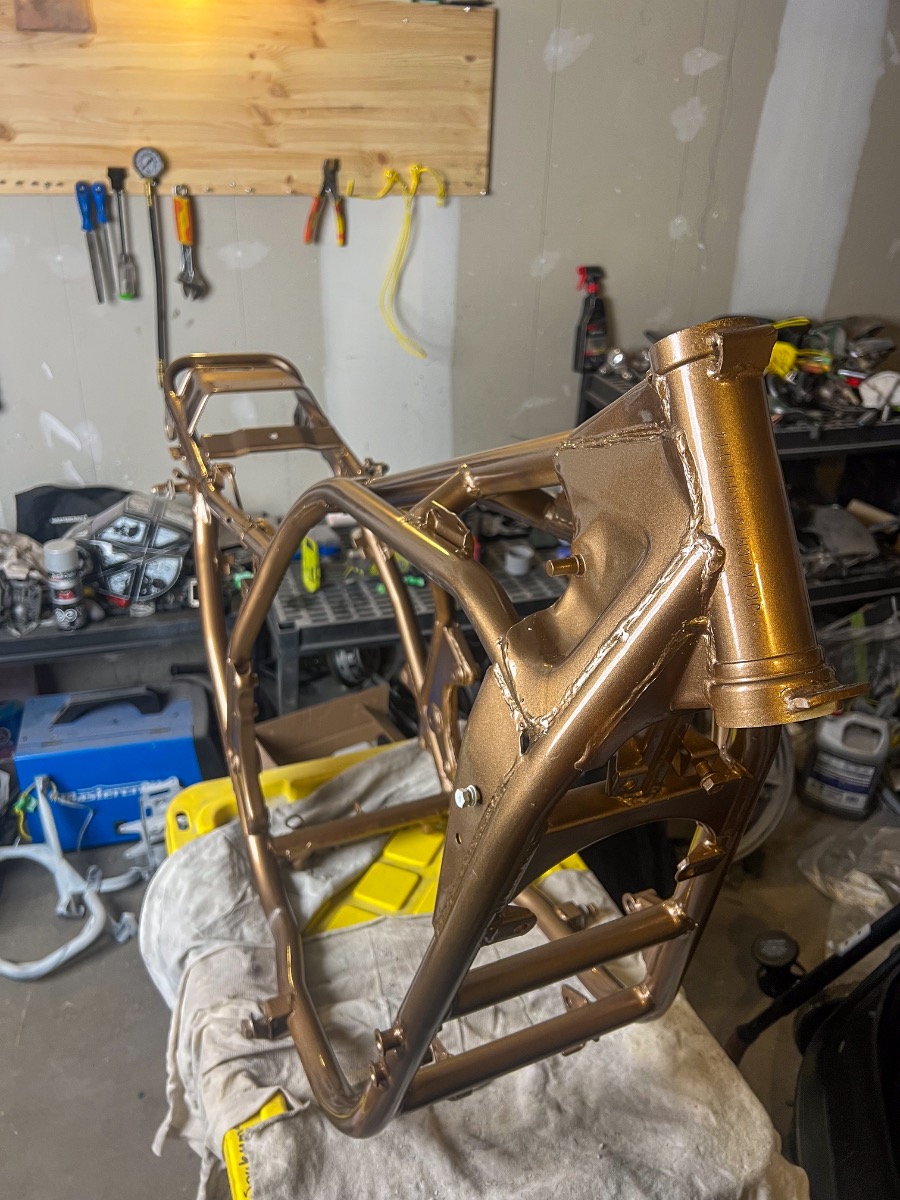

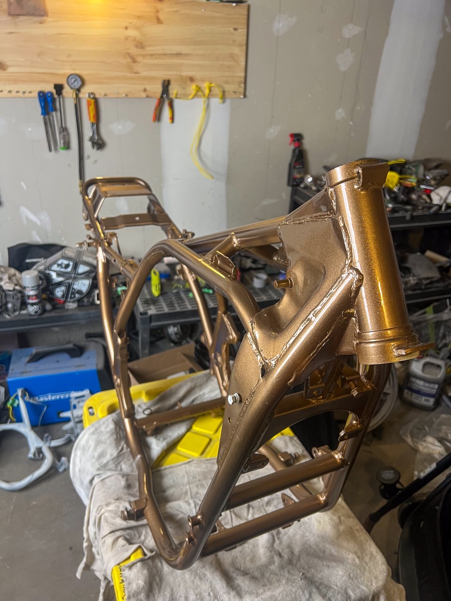

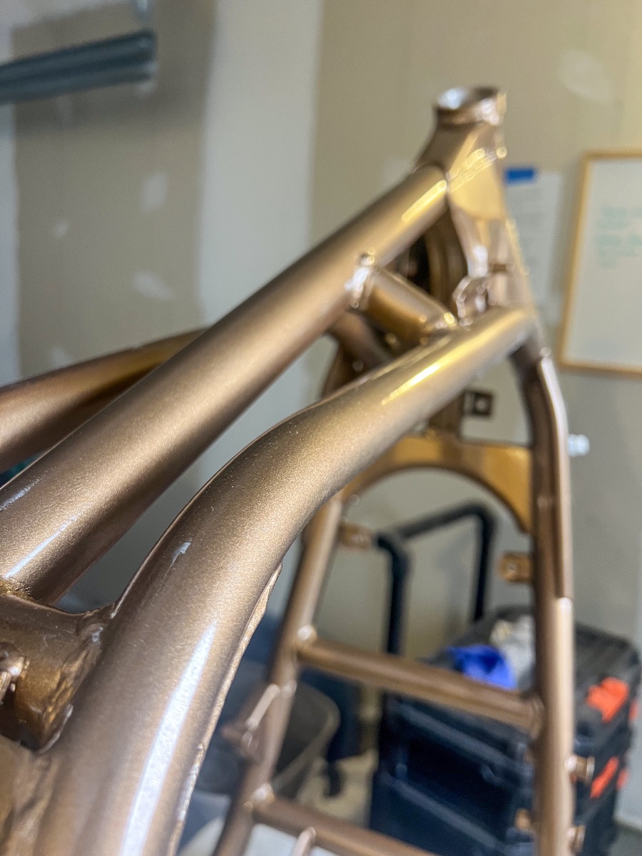

The powder coating guys took too long so I took back my frame, reinforced it in a few places and painted it myself with the coolest brown/copper I could find. Chrysler Saddle Brown

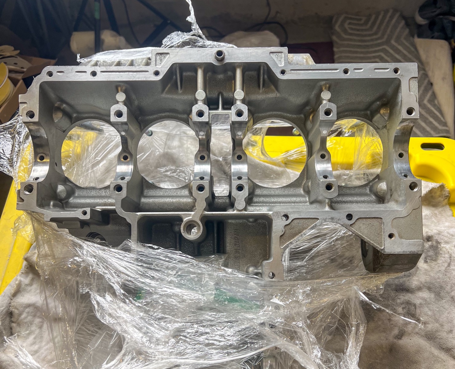

I also brought the engine casing in which I had broken 2 bolts to the machine shop. I was unable to take them out and they are well known in our area for taking out broken bolts. They did a really good job and cleaned up the casing as well.

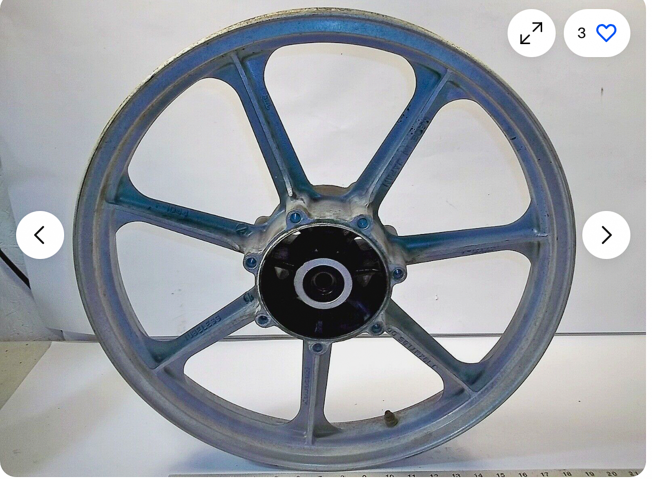

And that's all for now, I will keep going with the painting & reassembly. A member of the forum that lives around my city named Steve might help me for the engine rebuild. I'm super excited about that. Oh I also bought LTD wheels from him

1- Where do I get bearings for the wheels?
2- Any tire recommendations? Sizes? I would like a sporty look but don't mind a sprinkle of off road
