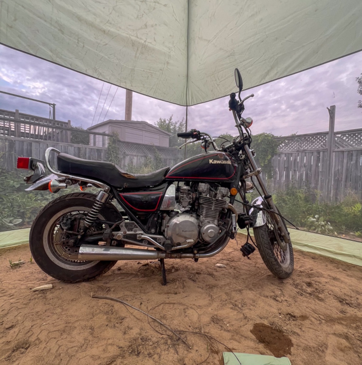

Here is an image of the bike the day I fell in love with it :

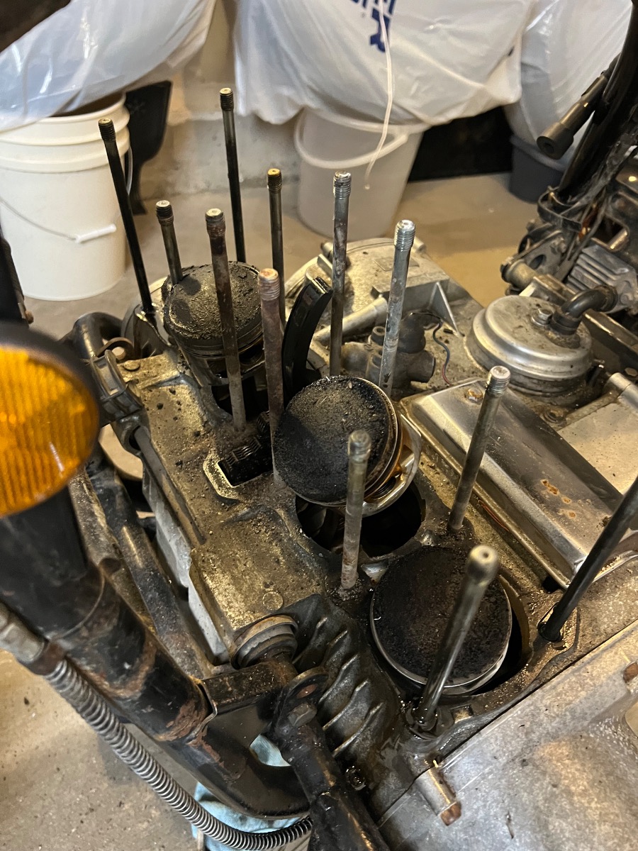

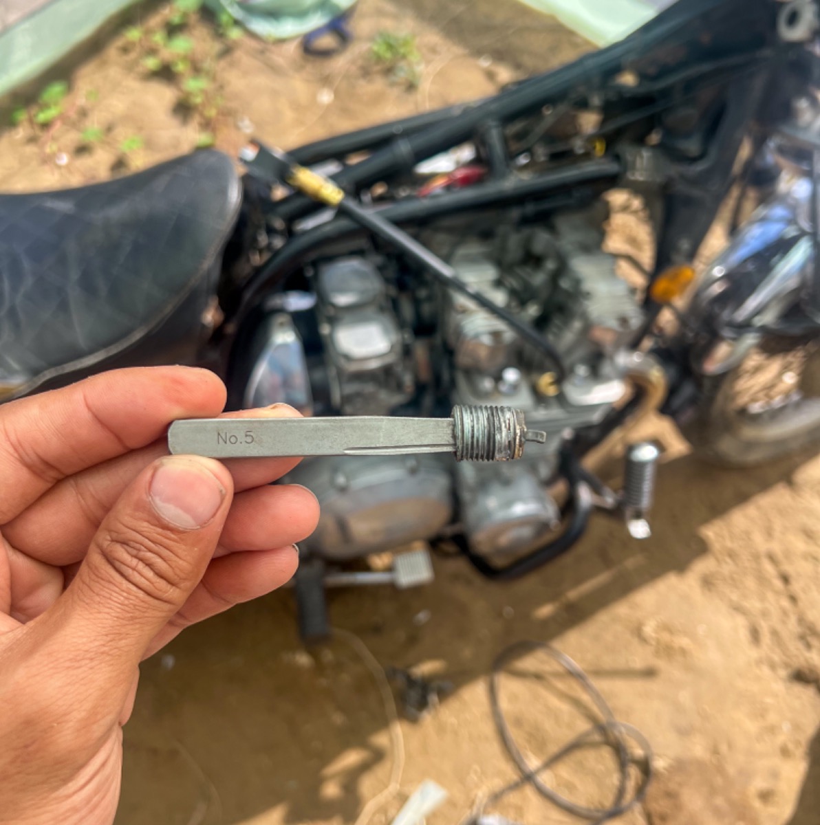

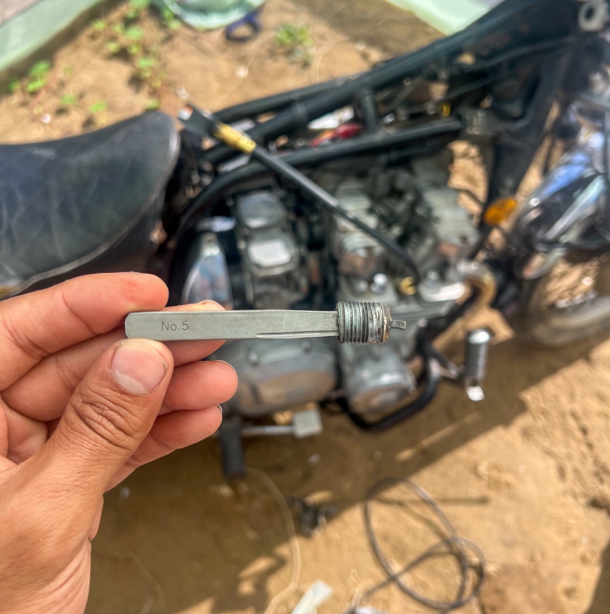

I was able to get the spark plug out without damaging the threads!
I noticed scoring on the cylinder wall where the spark plug repair attempt was made. The more I investigate the issues on the KZ, the more my dreams of riding it this summer are fading away. At least I am practicing with my driving school so there's that!

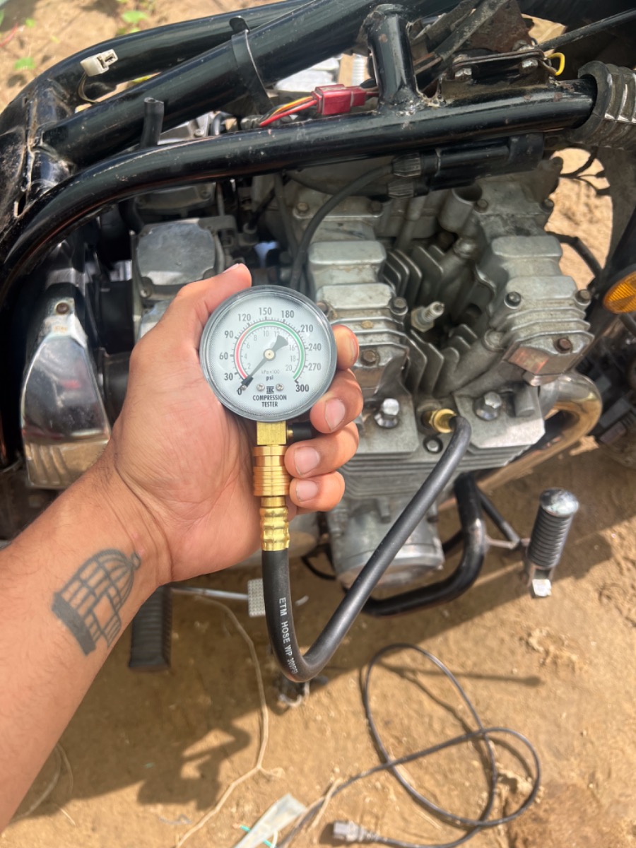

Compression time!
The results are:
with oil in the last two cylinders :
3. 180 PSI
4. 135 PSI

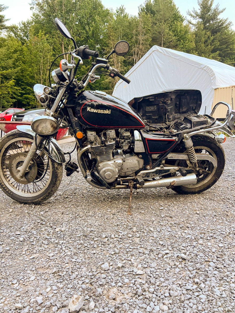

Compression time!
The results are:
- 130 PSI
- 140 PSI
- 15 PSI (Broken plug one)
- 65 PSI (I was surprised by this one)
3. 180 PSI
4. 135 PSI

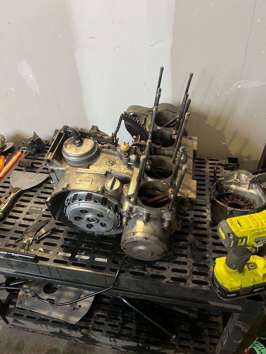

Since the engine was clearly not going to start, I started taking everything apart.
Head
Carbs

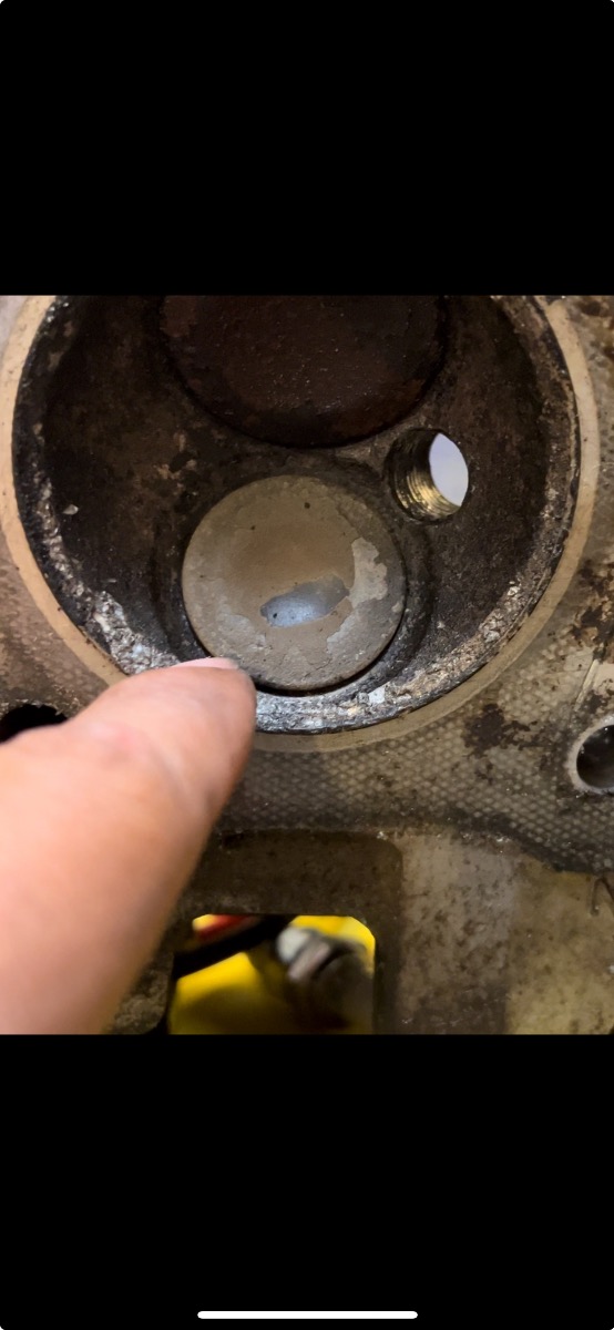

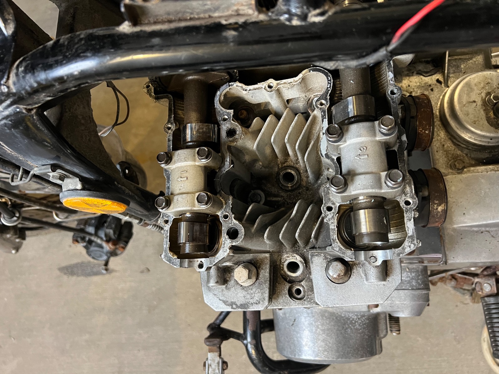

The head had some obvious damage, I did the fuel test and 3 out of 4 cylinders were leaking like crazy. I took it to the machine shop right away for a rebuild and a resurface.

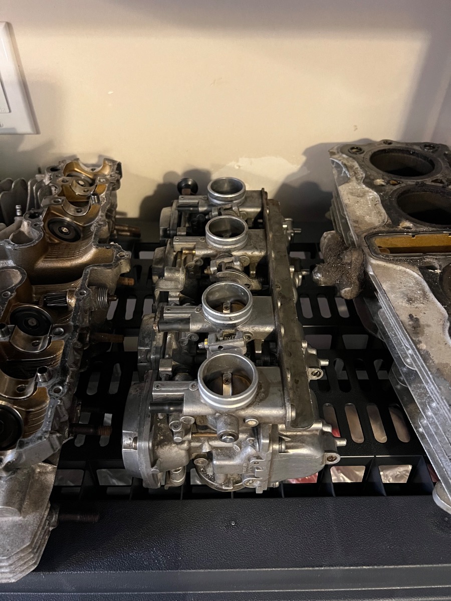

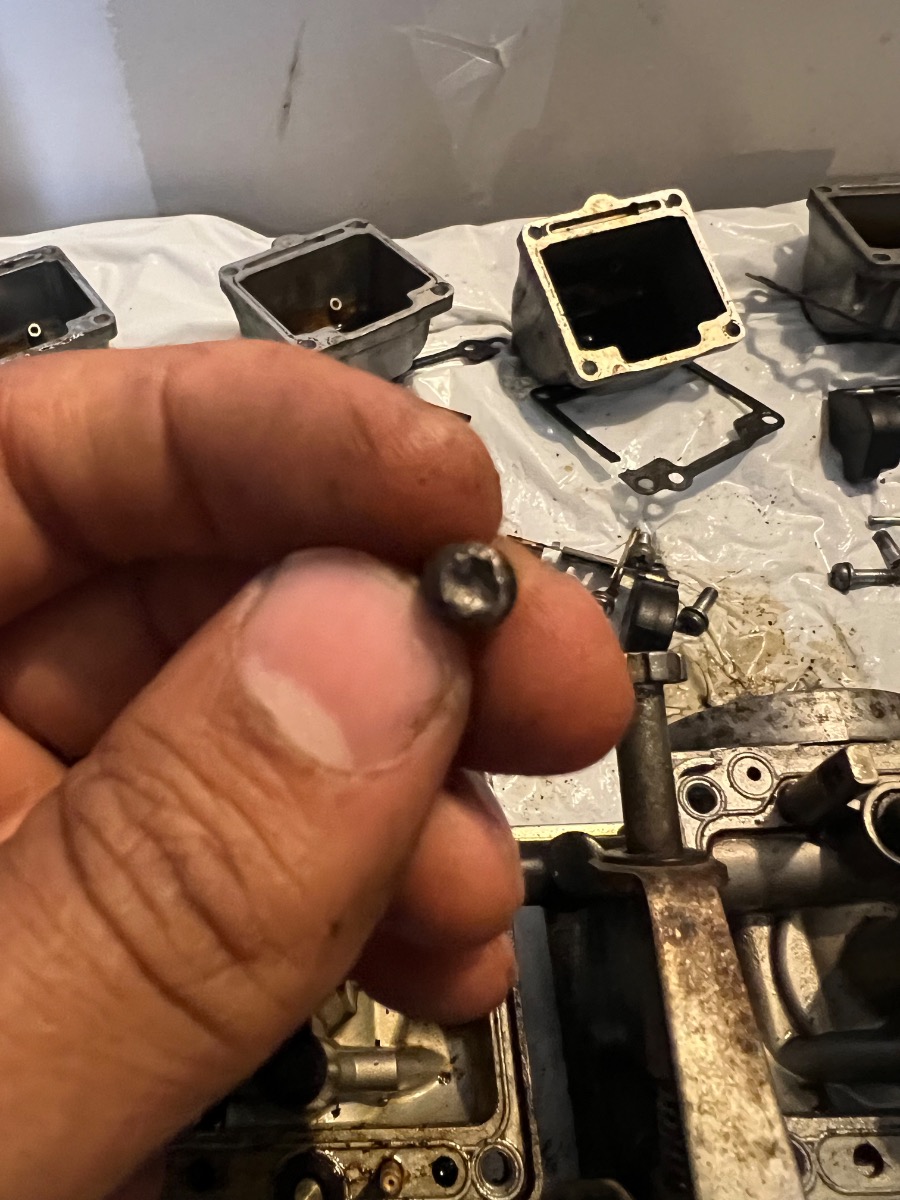

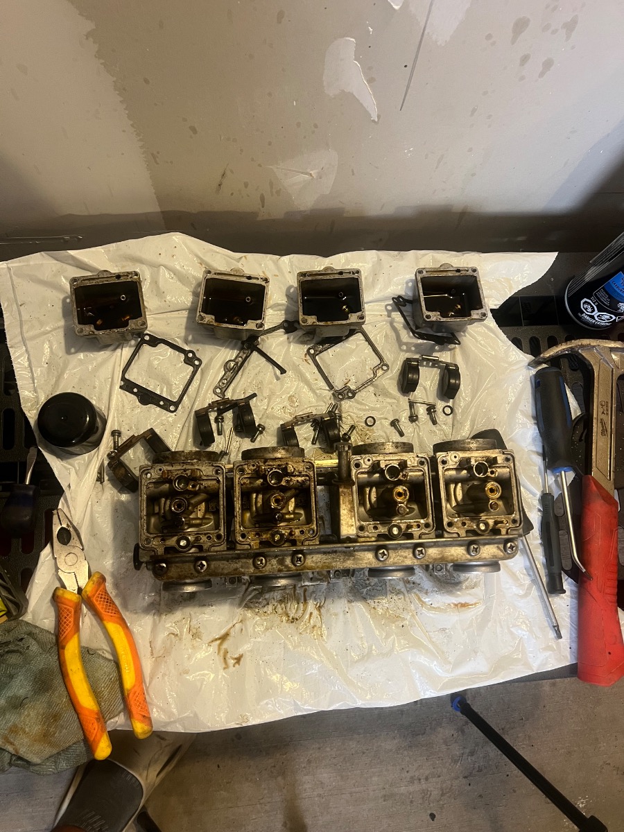

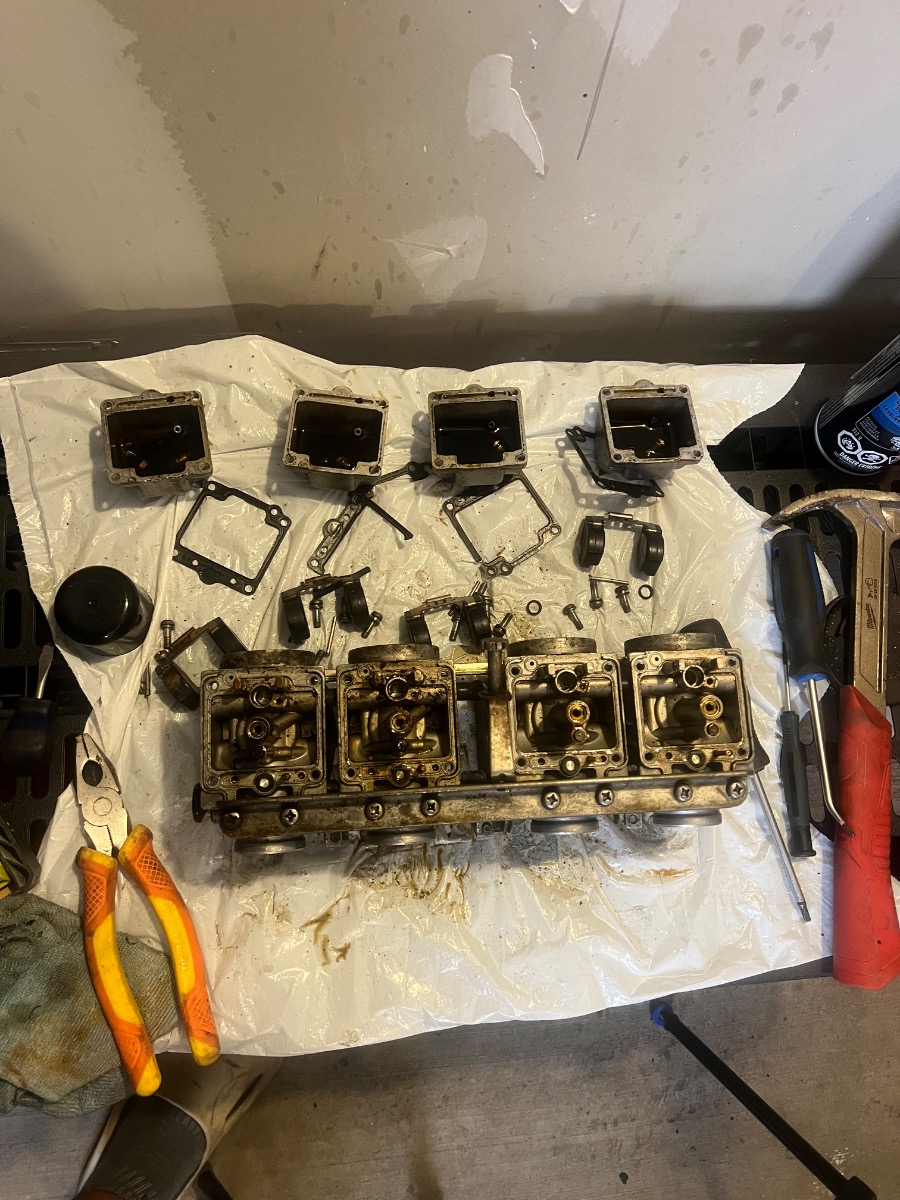

The more I dug in this Shady KZ, the more I understood why they were selling it. I started rebuilding the carb.

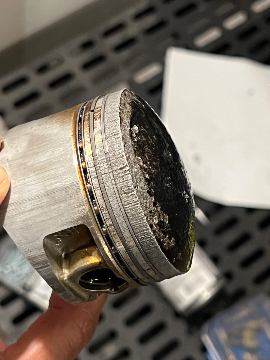

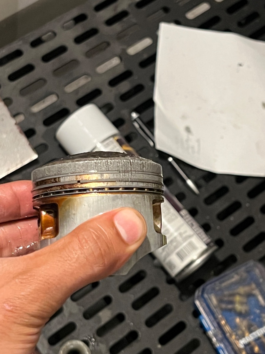

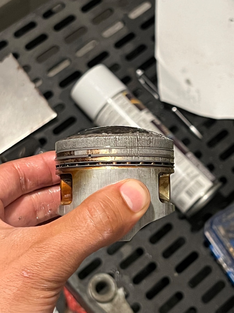

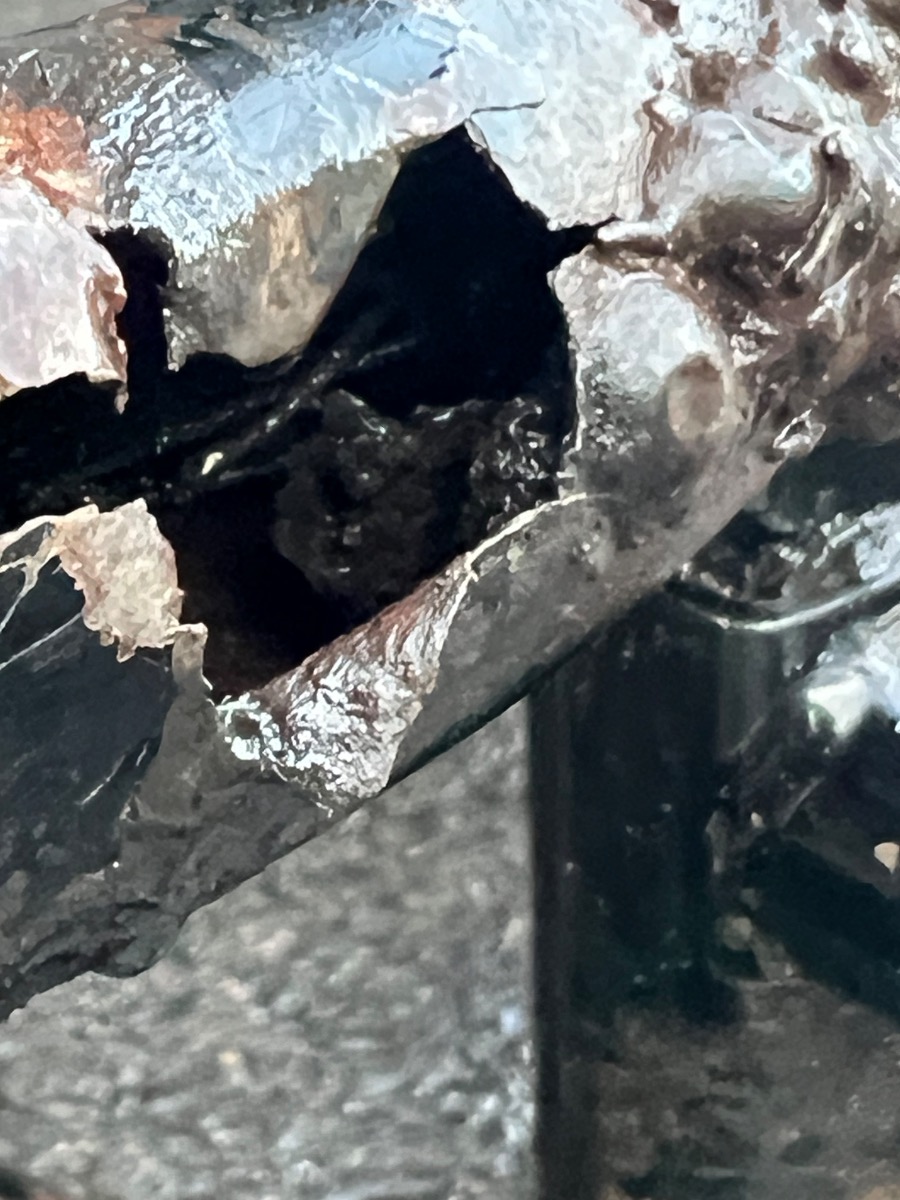

Number 3 of course, the one with the broken spark plug glued with caulk. Previous owner probably ran it like this for a bit with the broken spark plug tip in the cylinder. The result? Scored cylinder wall, seized rings on the piston and a broken piston. Here are photos of the damage.

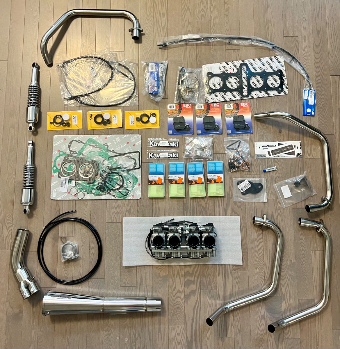

Sooo.. I started looking at a big bore piston kit Turning a negative into more cc's! Then I figured with new pistons why not new carburetor?? The exhaust was pretty rusty too, I could'n find 4 into 2 so I had to settle for a 4 into 1. Basically I ordered a bunch of things off of Z1 Enterprises. Here is a cool photo I took.
The pistons are not in the image as they were at my local machine shop so they could bore out those cylinders and take out the scoring from #3.

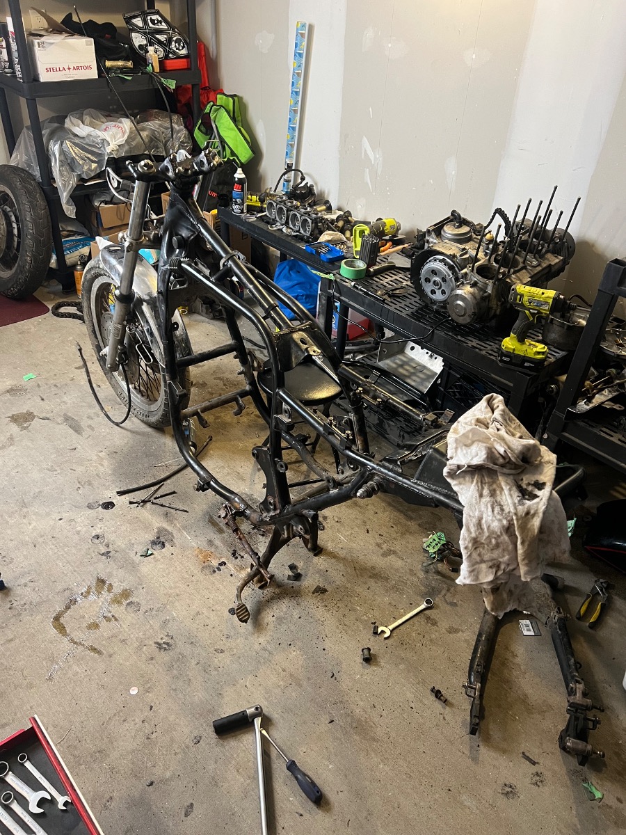

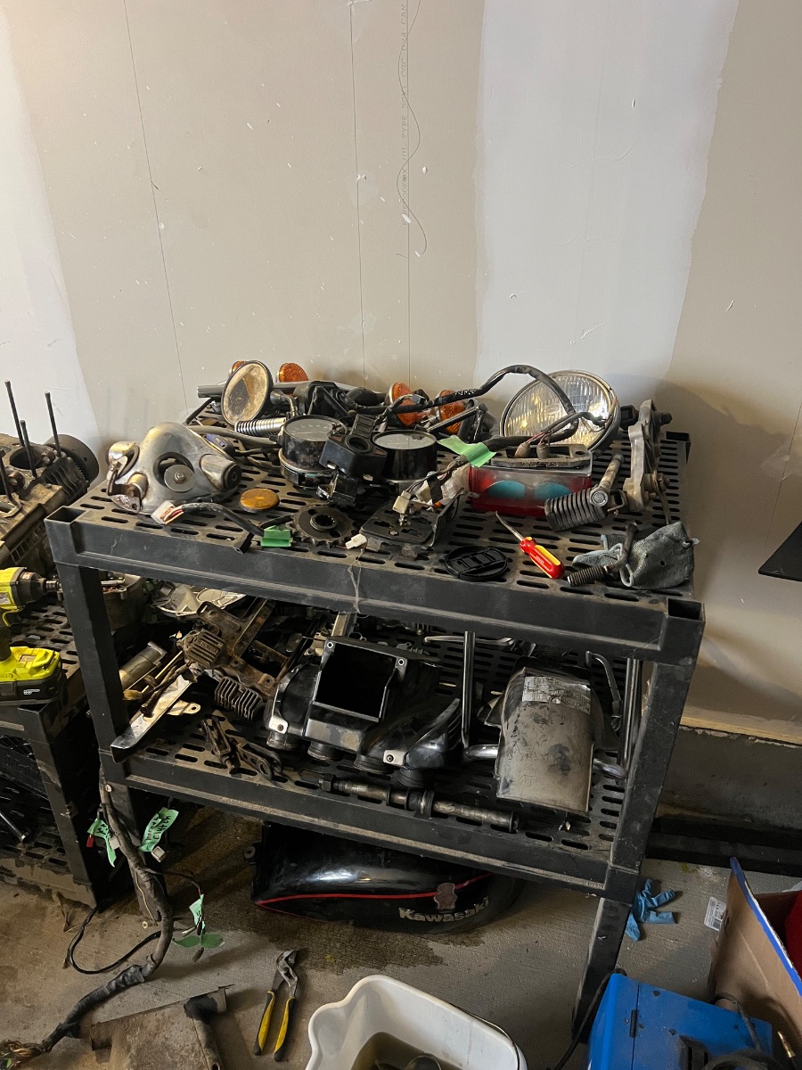

I started digging more into the bike and figured I might as well start from scratch. My bike was basically on shelves now haha

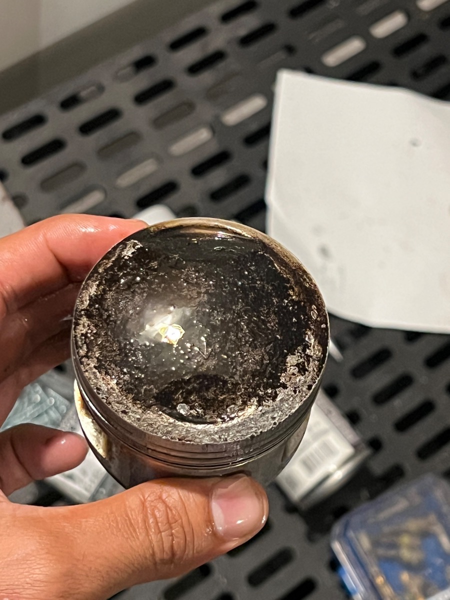

But before I could finished my attention shifted to one of the DIRTY pistons.

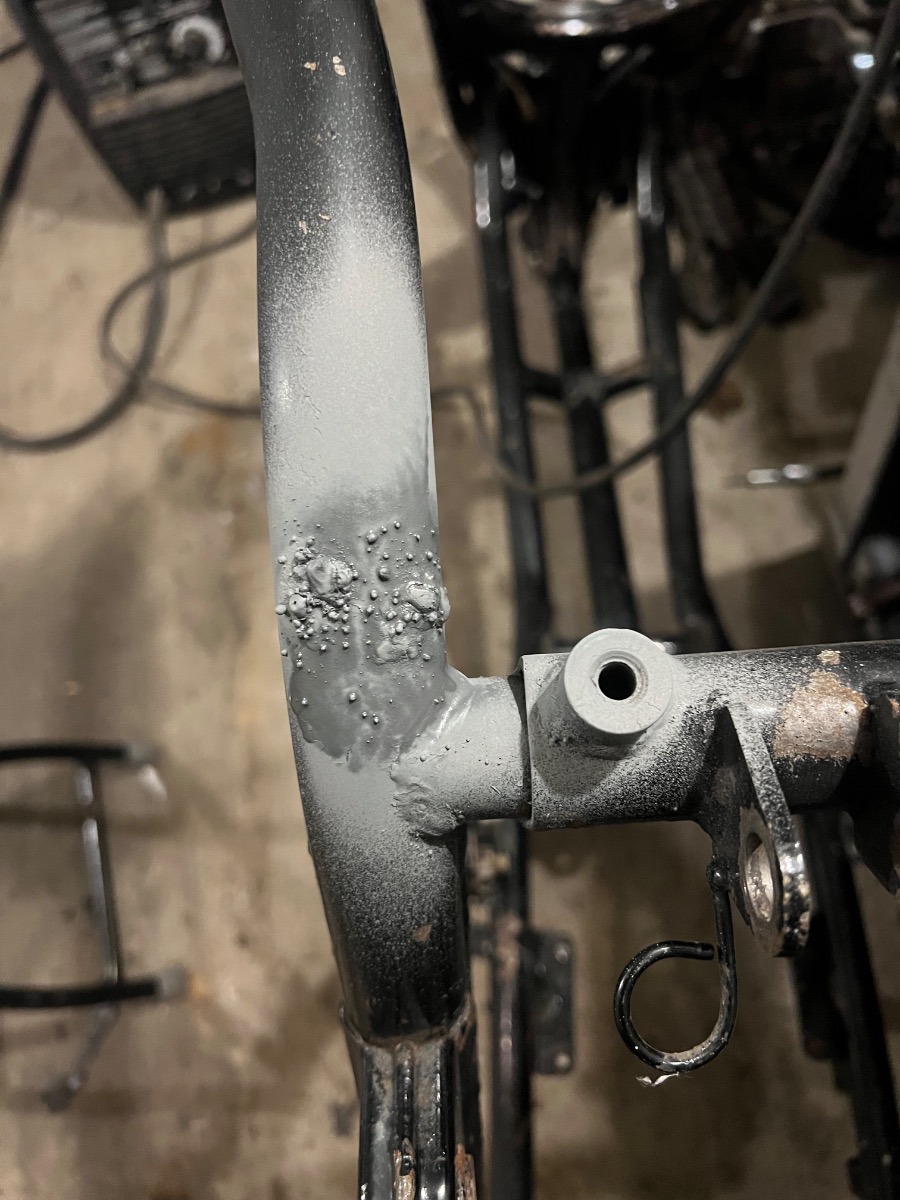

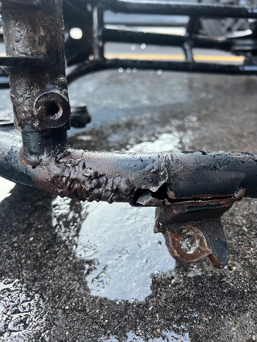

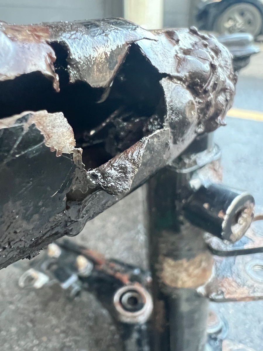

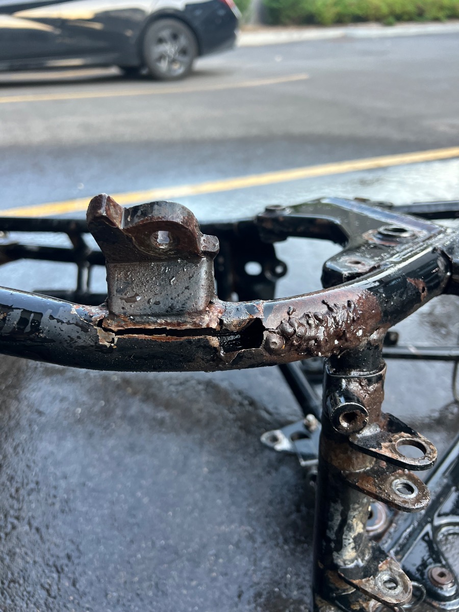

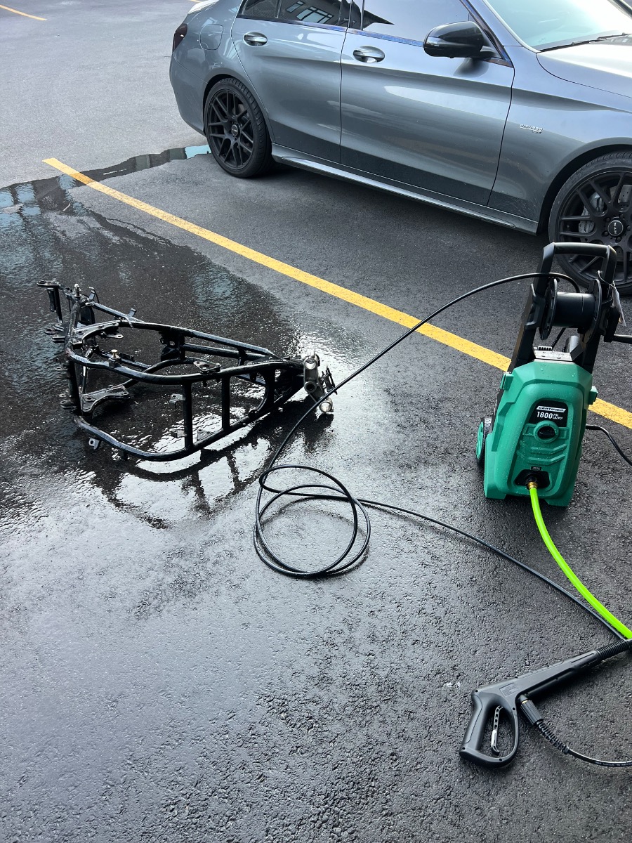

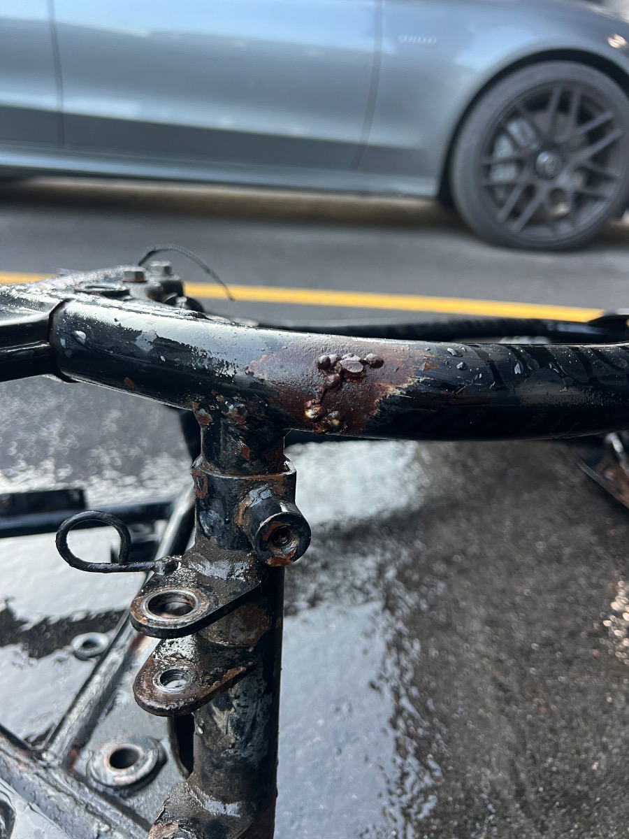

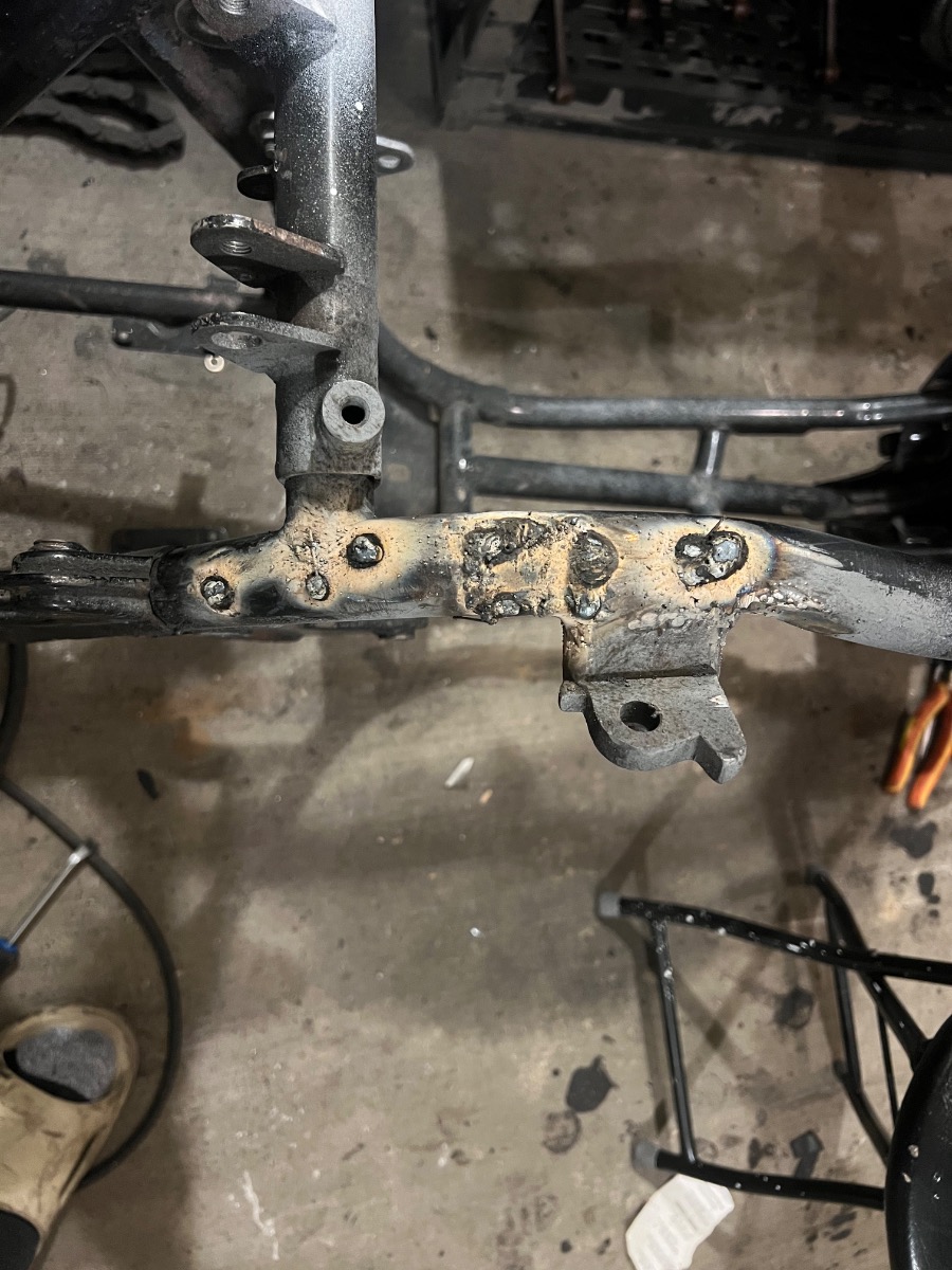

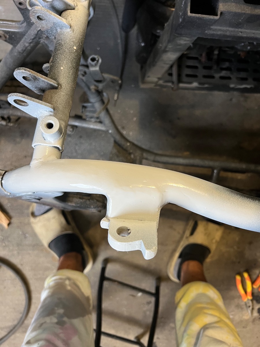

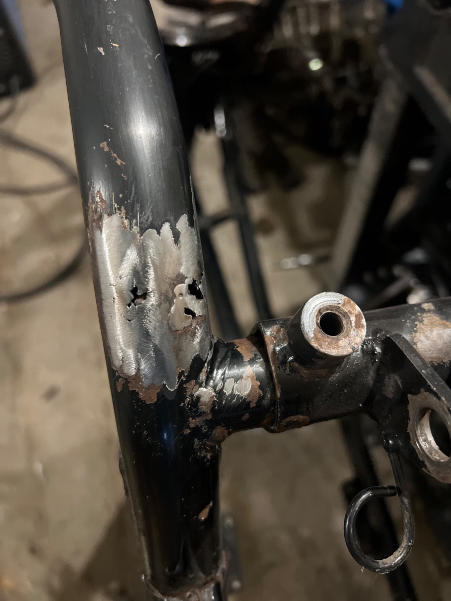

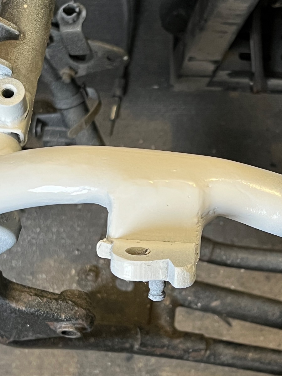

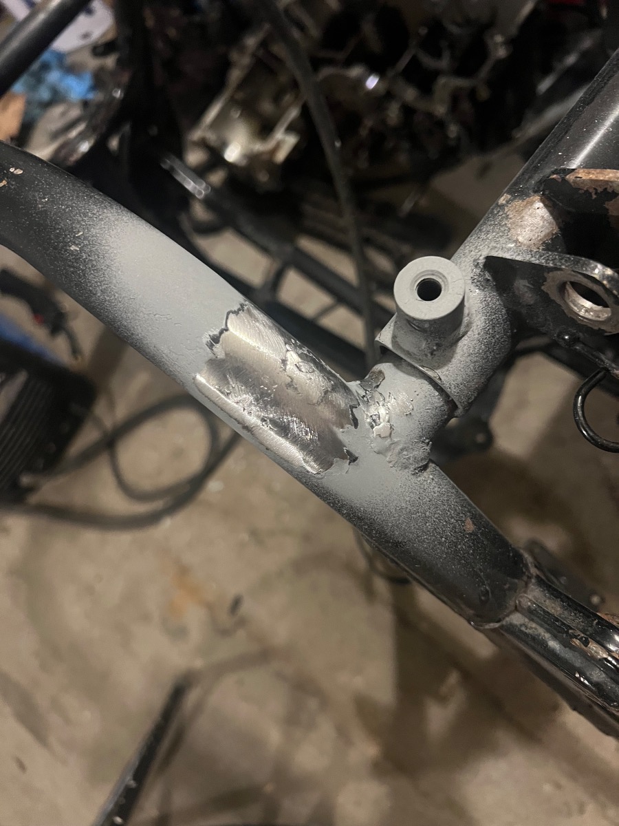

Once I had the bare frame, I started cleaning it and noticed another reason why the bike was sold to me lol. I have never seen a worse welding job and I'm not even that good of a welder . A good excuse to pull out the welder though! I started repairing the frame!
This was actually pretty fun to do but the metal on this frame is super thin which was a real challenge. I took the frame to a local powder coating shop with other parts I want coated. I am basically bike less aside from my oil burning KLR650. I am waiting on some parts on eBay to get the powder coating started and I just got the parts to fix the head today, some seals, a new valve and guides. Things should start moving soon.

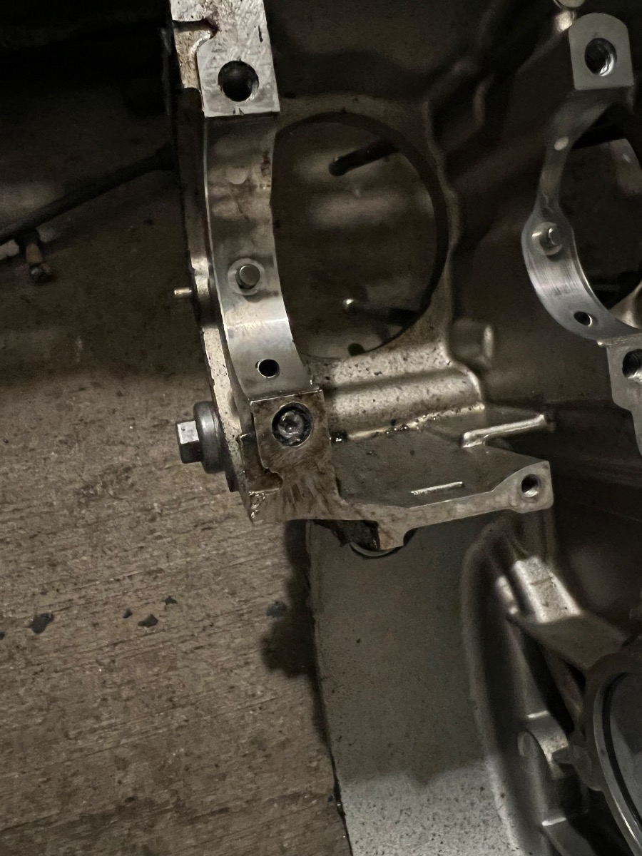

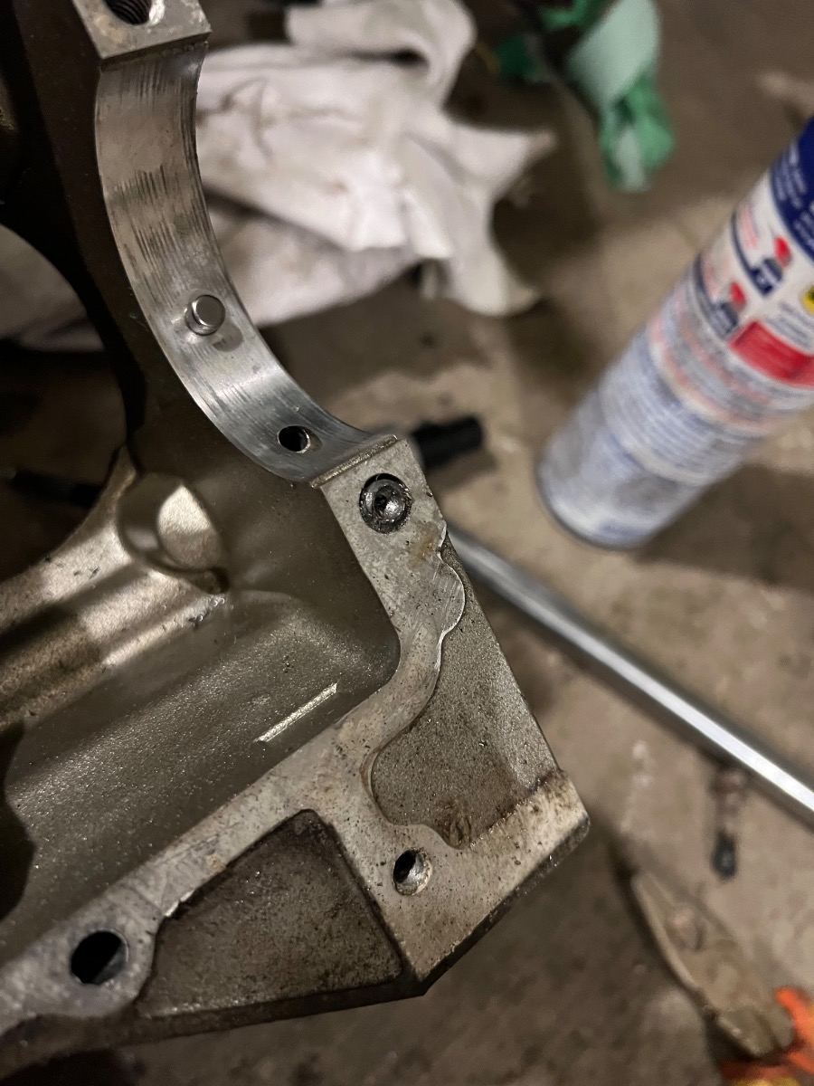

Had a bad luck when digging in deeper into the engine... TWO BROKEN CRANKSHAFT BOLTS.. And I can't find replacements online anywhere. Let me know if you know where to get some. I thought ARP made bolts for everything!?
