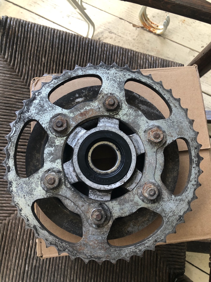

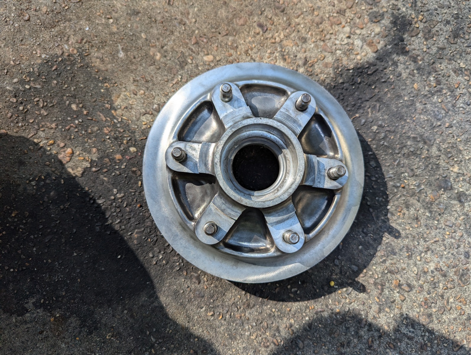

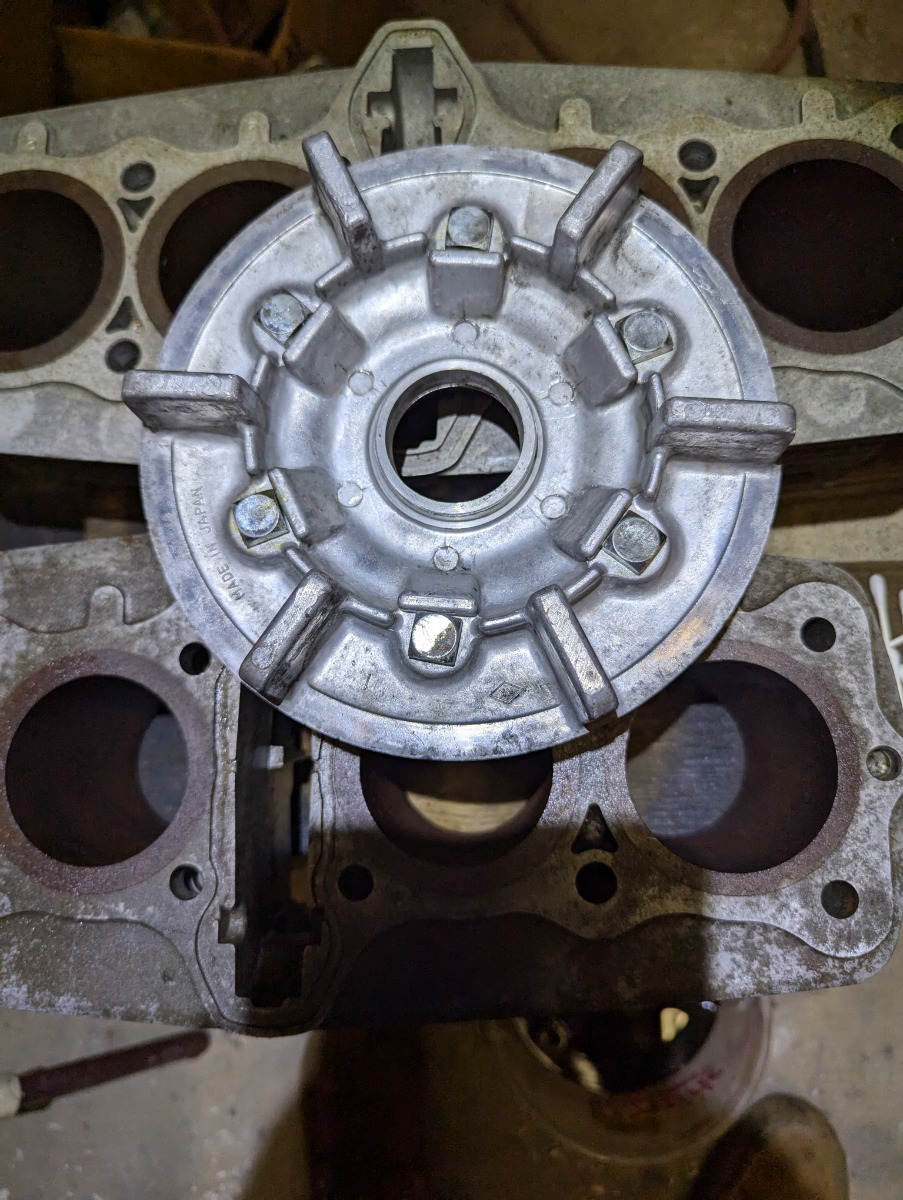

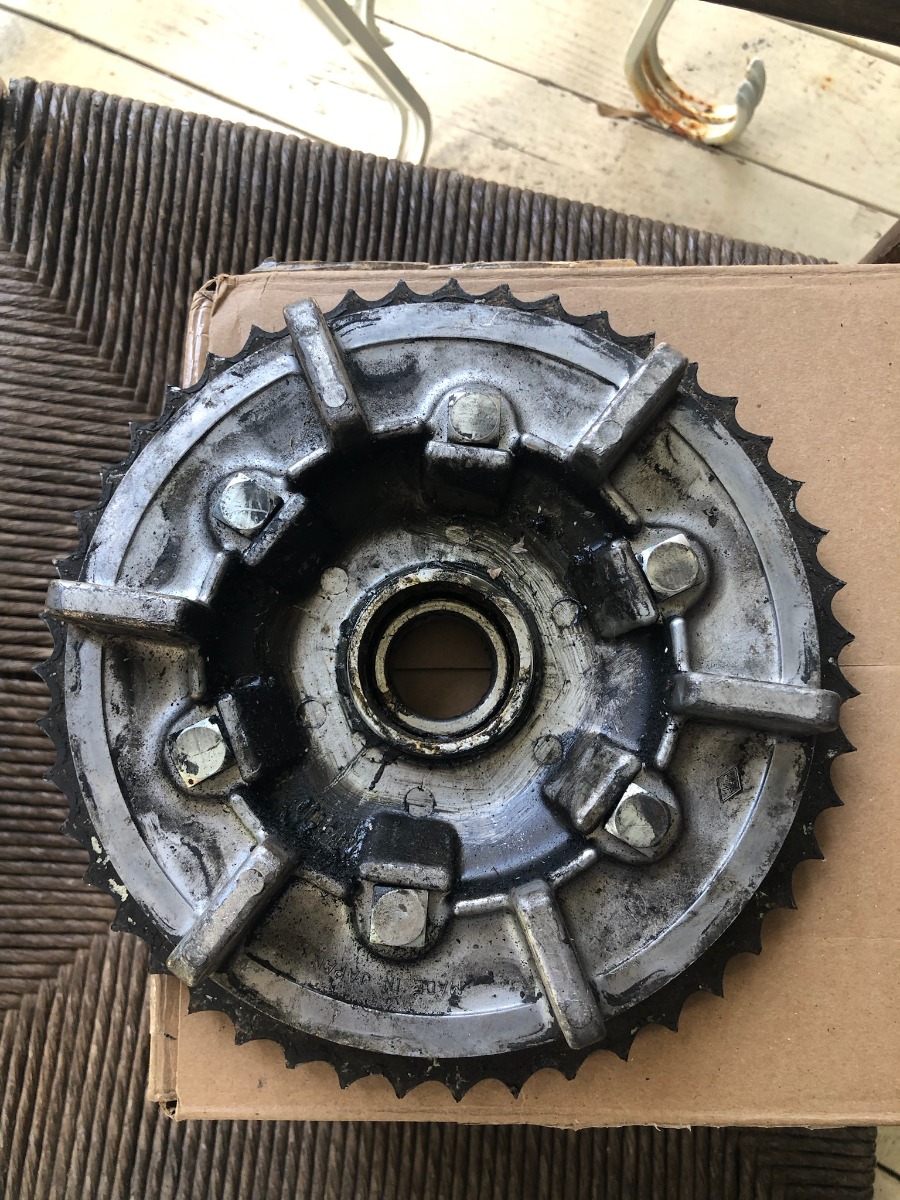

16 Jul 2024 15:34
Got the correct sprocket hub in today. Yeehaw One more box checked in a good way this time. Before and after picture light cleaning
77 KZ 1000 A
21 Z900 RS
Project 73 Z1
21 Z900 RS
Project 73 Z1
