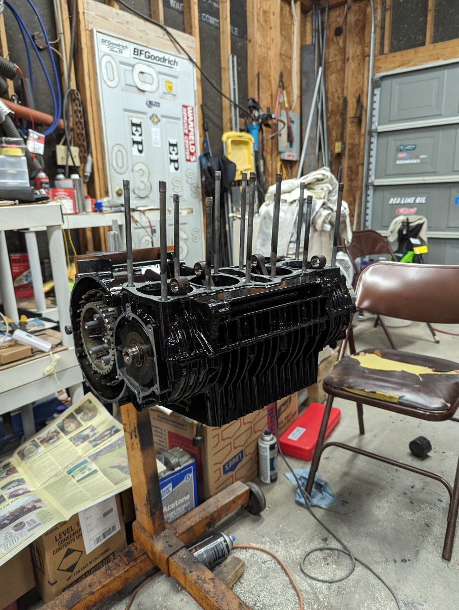

Re: 73 Z1 mutt/mixed breed Build
27 May 2024 06:56
#899806
Engine cases painted yesterday

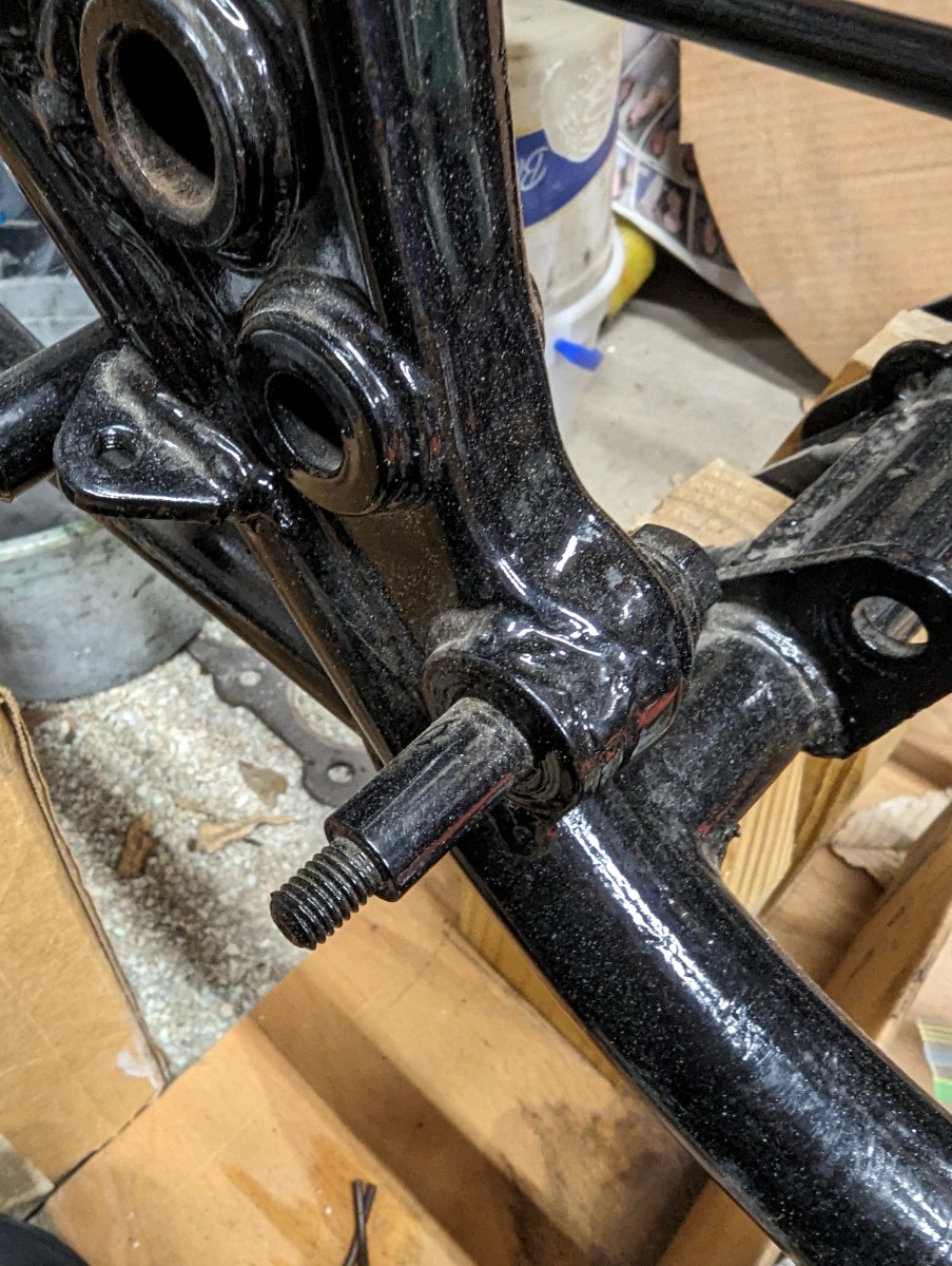

  • Coyote
  • Coyote's Avatar Topic Author
  • Posts: 78
  • Thanks: 23
27 May 2024 07:03
#899807
Does anybody know an easy way to get the foot peg studs out? I need to rob one from the 76 frame I've got to put in the 73.

  • slmjim+Z1BEBE
  • slmjim+Z1BEBE's Avatar
  • Enjoy Life! IT HAS AN EXPIRATION DATE!
  • Posts: 1493
  • Thanks: 983
27 May 2024 07:45
#899808
Does anybody know an easy way to get the foot peg studs out? I need to rob one from the 76 fraime I've got to put in the 73.
Remove the nut behind it.  Should unscrew with a pipe wrench or curved jaw channelocks.

  • Coyote
  • Posts: 78
  • Thanks: 23
27 May 2024 08:27
#899809
Great, just got one loose with a pair of vice grips. When I was building my 77 I tried it on it and I couldn't get it to budge. The end thread was twisted off so you couldn't put a nut on it. I basically scarred that one up so bad I had to grind it with a stone to get it roughly smooth and still don't have a nut on it.
This one came easily thank goodness. Thank you very much

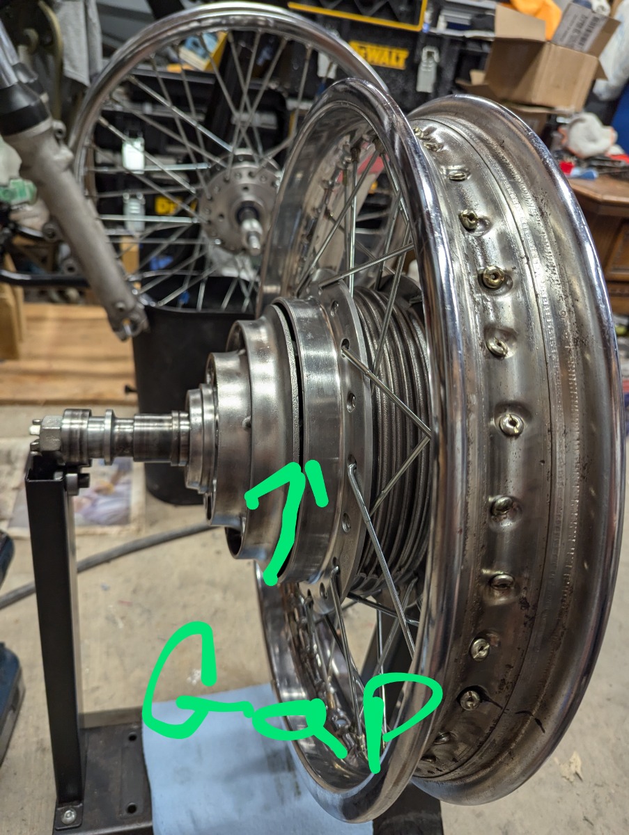

19 Jun 2024 07:58
#900966
After respoking the front and rear wheels I decided to do a mock-up of the rear axle. Of all the parts I recently purchased I did not have sprocket hub. I found one on eBay and purchased it and in the mock-up I seem to have a mismatch between the sprocket hub and the wheel hub. The paddles that fit into the rubber cushions seem to be too long on the sprocket hub. See photo. I don't know if I have the wrong sprocket hub or wheel hub. When I compare it to my 77, the outer sprocket hub rim should fit inside the wheel hub with no gap. If I remove all spacers and rubber cushions, The hub bottoms out leaving the same gap
