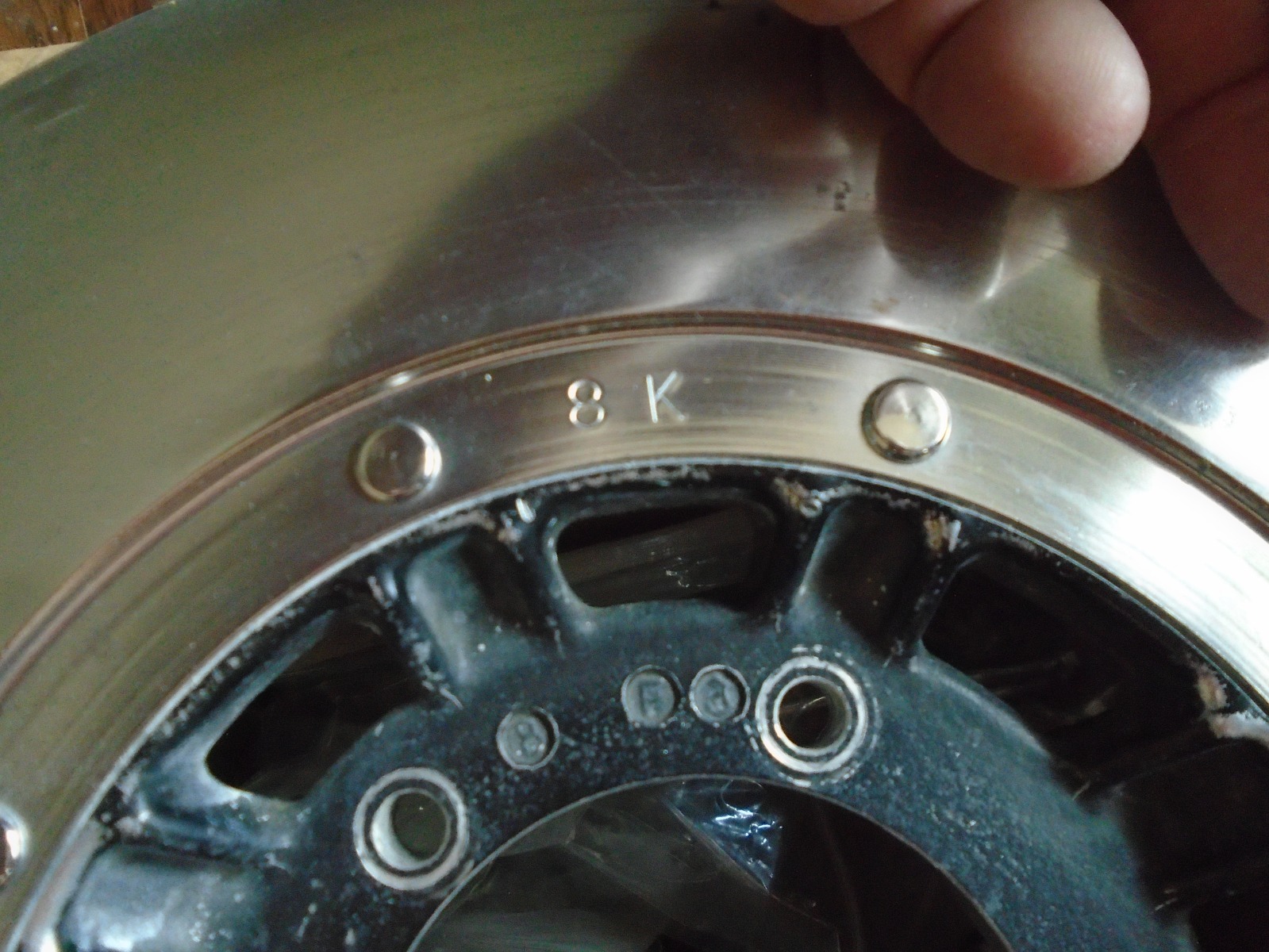

Got a set of used front forks in good shape with integrated reflector to rebuild with my new inner tubes, a pair of replica rear shocks with integrated reflector, and a used 6 bolt front hub coming this week.
Next question came up, I only have one 6 bolt front rotor and I'm confused on the date codes. It has F9 in the usual place but reversed. What little I've come up with identification methods have the number before the letter. It also has 7H2 stamped between two bolt holes. See picture
Any ideas on what this came off of?

It looks Kawasaki but it's not from a Z1.

Don't recognize it. Date code format of Z1 disks is 'digit alpha', stamped on the disk itself between the rivets. Other undocumented characters do appear on the disk carriers.

One thing I would say is if you are planning to use it I would advise "stripping" the surface that sits against the wheel. That coating looks real thick and will cause the disc to run out of "true" which can cause pad "knock back" (nothing spoils your day like grabbing a handful of brake and nothing happens)

Ya need a 1973 disc? I have one, thanks to Marty! Have no immediate need for it. That looks like a Honda or Suzuki disc btw. No Kawasaki discs were marked that way.
