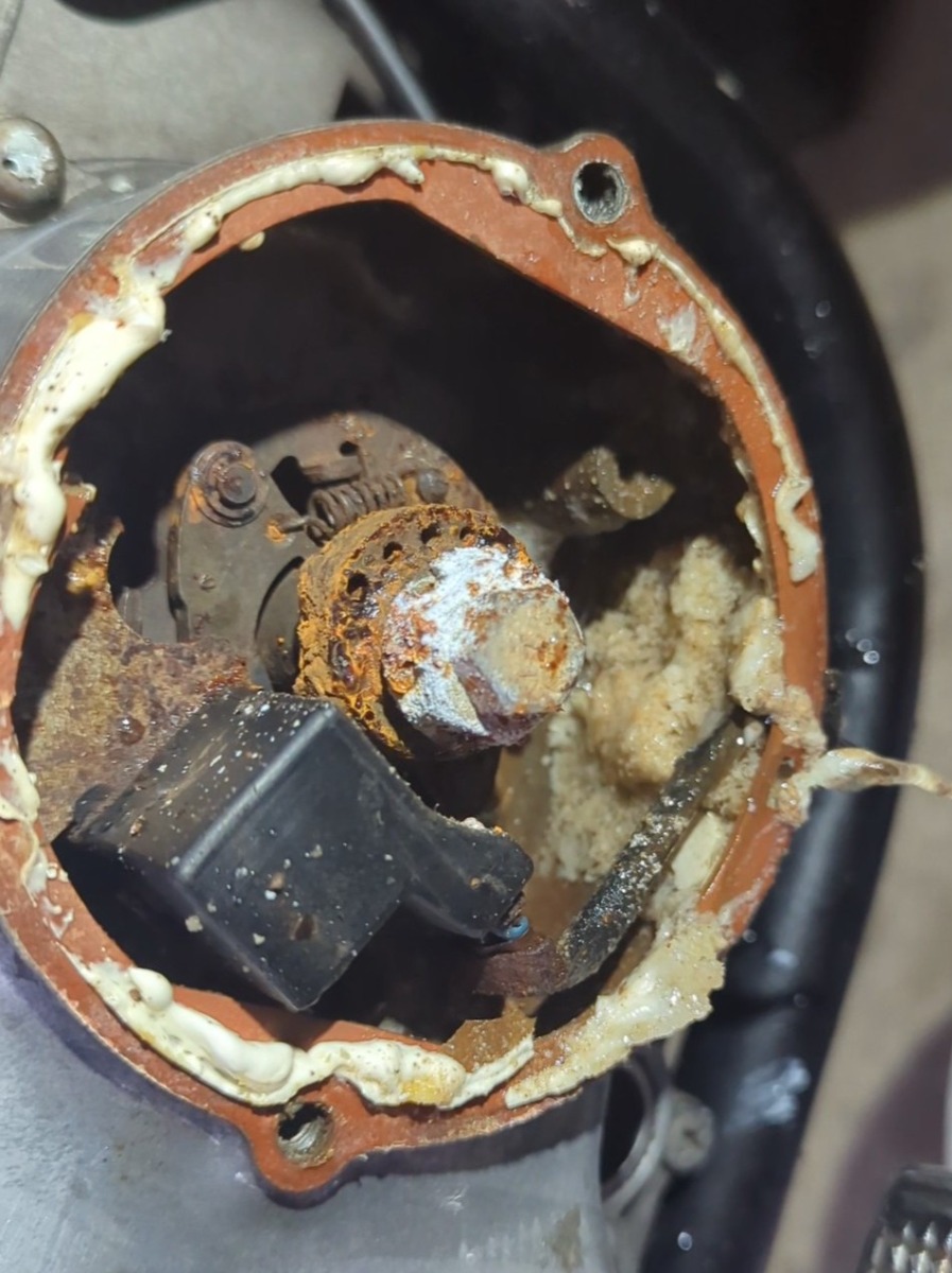

Well went to look at the timing advance unit and found this:

18 May 2024 19:25DOH! There's your problem...

Do I try to clean this up or do I try and replace it? How exactly do the weights work, can this assembly spin at a different speed than the crankshaft?

Clean it the best you can as it sets. Then disassemble and give each part a good cleaning.

20 May 2024 03:35Clean it the best you can as it sets. Then disassemble and give each part a good cleaning.
Agreed... start with this: www.google.com/search?q=electrical+contact+cleaner

Wow, what a mess. I would clean it all up and assess, but I bet the rotor is too far gone to save.
The rotor spins at exactly the same speed as the crankshaft. As rpm rises, the springs allow the weights to move outward, slightly advancing the point at which the plugs fire. As rpm goes down, the springs pull the weights back, thus retarding the spark a bit.
Be very careful with that 13 mm bolt in the center. If you break it, you will be very sad. Lots of good penetrating oil and patience will pay off. Kano Kroil and Liquid Wrench are among the best penetrants. WD40 and such, are a waste of time here.

20 May 2024 15:34Well that would explain the lack of power of the timing is too slow at high rpm.Wow, what a mess. I would clean it all up and assess, but I bet the rotor is too far gone to save.
I sprayed the whole thing with deep creep on Friday and will check it again tomorrow. I don't even want to touch that 13mm lol

Managed to get it cleaned up. Deep creep and a brass brush worked well. The weights move freely now.
So while the bike is idling, it will occasionally backfire through the carb. Also as the RPM's climb, power depletes. I can't tell at what RPM as the tachometer isn't working for some reason.

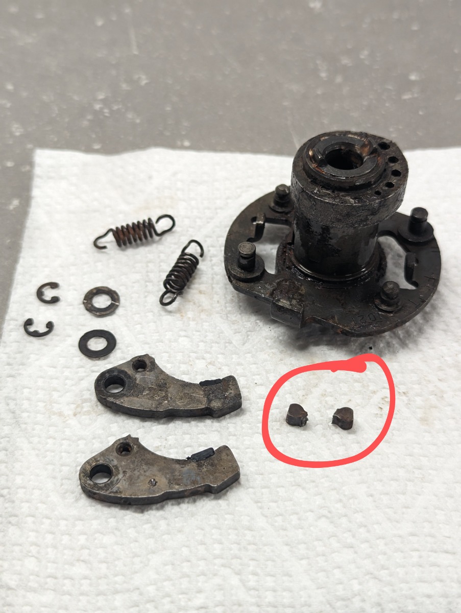

Managed to get that crank bolt out and take the whole timing assembly off. Going to soak everything in vinegar overnight and scrub it down again.
I did notice while removing it that something is broken.
