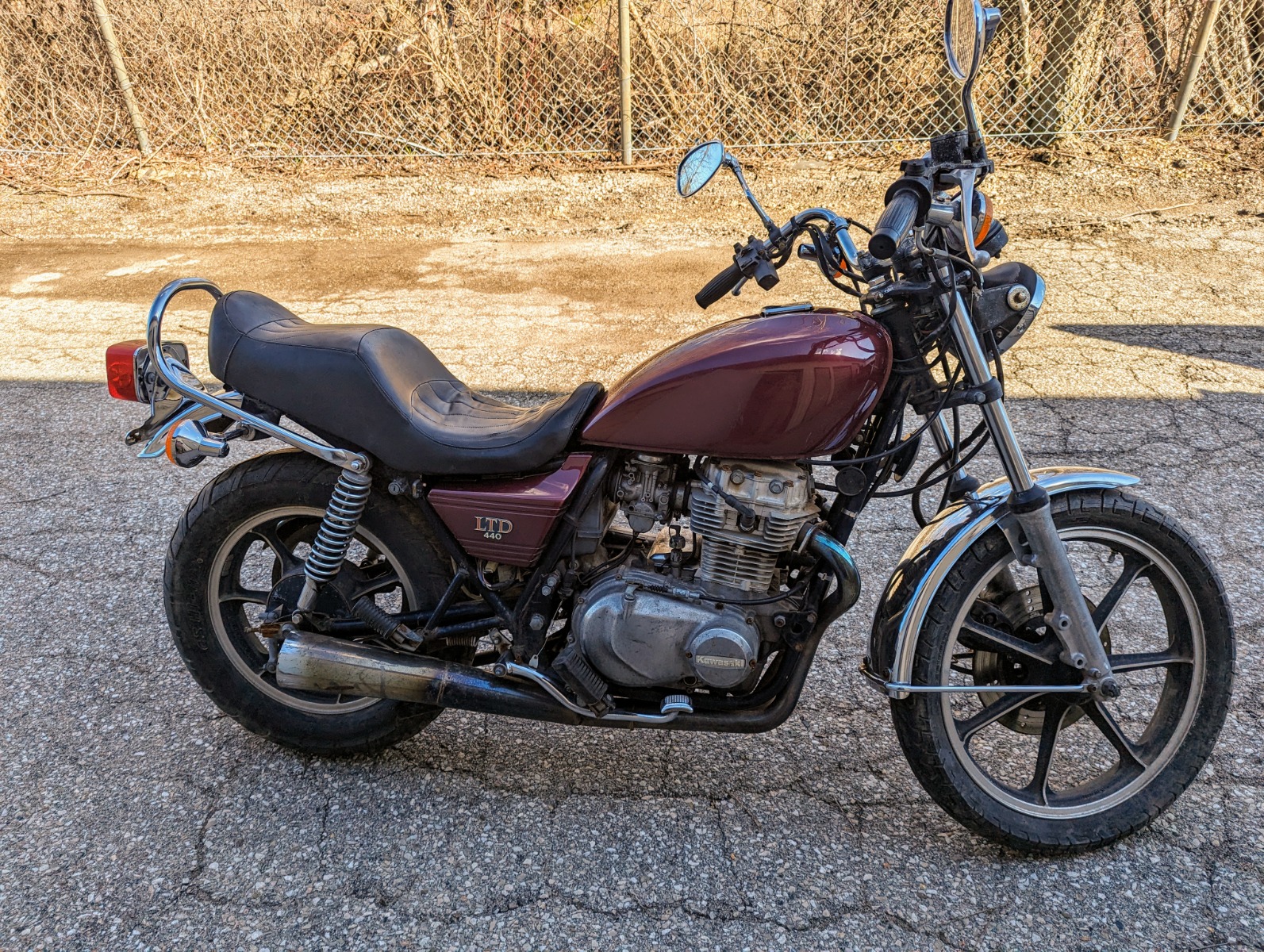

I've always been a big scrambler fan. Something about a old school motorcycle with knobby tires just clicks for me.
For this build there were a few prerequisites; Double cradle frame, Two cylinders, 400cc+, Chain/Belt drive, and Japanese.
...Enter the 1982 KZ440D LTD Belt drive.
I paid far too much money for it, it "ran when parked", and it needs a new seat pan(found out after getting it home), buts its mine.

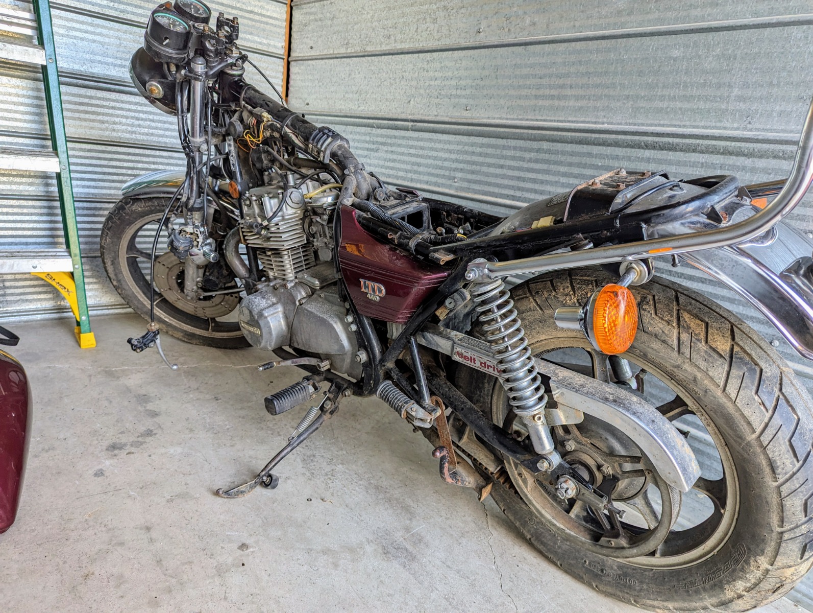

Today's find
The front pulley rotates back and forth on the output shaft, I assume its not supposed to do that.
And there is a splice in the wiring harness near a fuse holder.

The splines on the belt pulley are worn out allowing it to move around on the output shaft, so that's garbage. I guess I will go ahead with the chain conversion now.

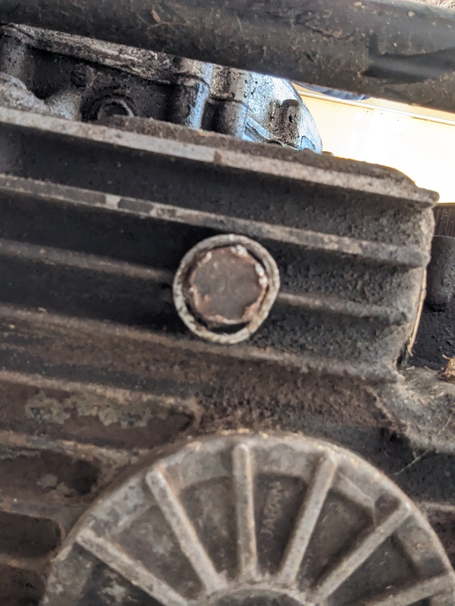

I have been unable to remove the drain plug bolt. Vice grips, big ass channellocks, and even a chisel & hammer. No dice. It's in there good. I'm going to try and drill the whole thing out tomorrow.

Success!!! I got the drain plug bolt out. Had to drill it.
The engine had 1.5L of oil in it. No metal in the oil or filter.
