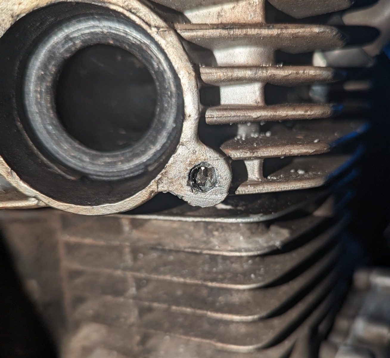

Dealing with a broken off tap in the god damn exhaust stud hole right now. Tomorrow i'm going to get a large o-ring to cut into a plug for the carbs as I lost the originals.

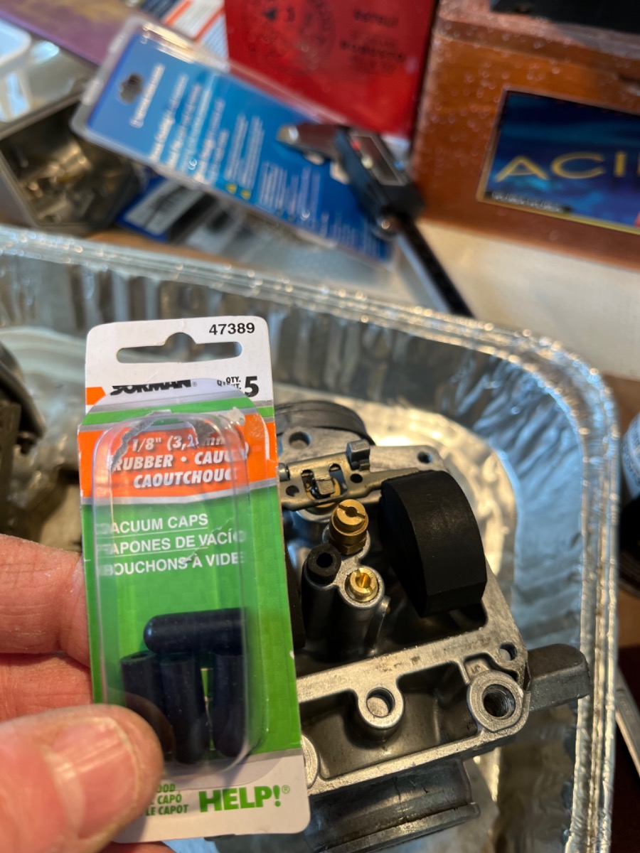

Vacuum plugs work for the carb plugs if you sand them down a bit.

If these carbs a like my KZ305 carbs, be carfull not to push the plugs in so far that it blocks the fuel passage from the main jet. Also, they should extend long enough so they are held in place by a tab in the bottom of the float bowl.
I had to faburcate those plugs when I first got this bike, but your solution looks much simpler.

Alright so I bought a rubber gasket for some agricultural equipment and cut it into little plugs to fit the carb.
I got it running today, on break cleaner as I didnt have gas on hand.
Next issue:
