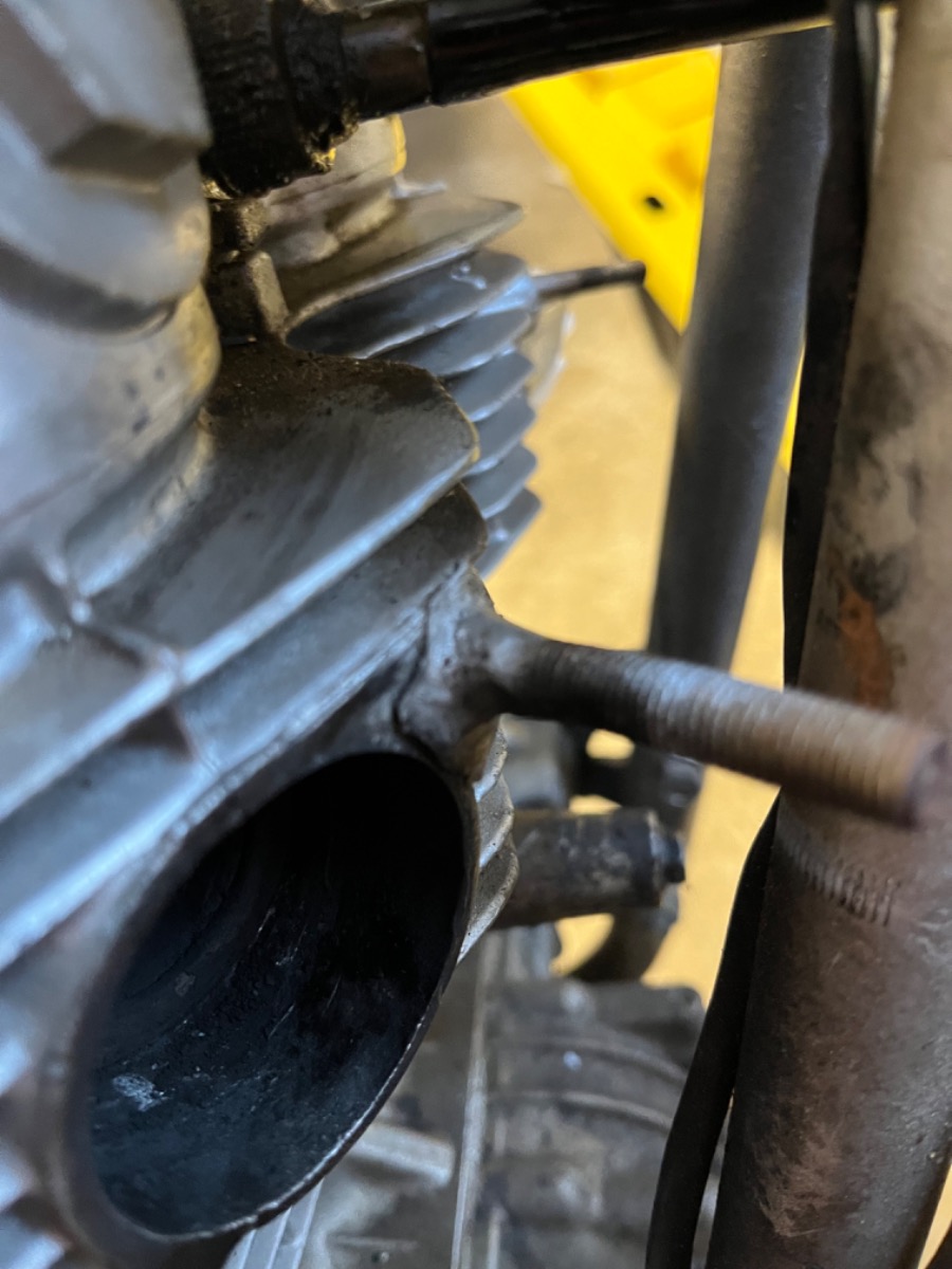

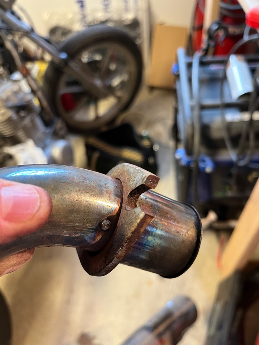

A quick update / question on the exhaust. The existing bolts holding the exhaust flange were very loose, not much more than hand tight. The header pipe is very loose in the head, is it supposed to have a lot of slop?
The welded bolt appears solid for the moment despite the crack in the weld. I feel my options are to leave it alone as suggested above, or snap it off and try to install a Heli Coil or better yet a Time-Sert so a new 6mm stud can be installed.
The existing flange is held in place with two small welds that I can grind off, but the sleeve (not sure what to call it) does not budge. There is a flair at the end of the header as you can see in the picture.
Thoughts?
Thank you.
Bruce

There should be 2 half circle collars that fit against the flare in the tube, and the flanges should be loose on the tubes not welded. See the partzilla diagram for your bike. The factory used the ribbed flanges but a lot of aftermarket pipes use the flat flange like yours has. Both would use the split collars to keep the pipes tight to the head. And there are copper gaskets that go between the pipe and the head to keep a seal.

Regarding what you should do with the welding on bolts, it's great you have the helicoil or timesert to fall back on, but what I would do in that situation is try and go with the welded on bolt, once I have the exhaust flange collars and steel collets (and copper/fibre gaskets) in hand. You never know - there might be enough exposed thread on the welded bolt to fit the exhaust properly without having to take on more work. Then again, if you encounter problems from what the previous owner did, then just cut off that bolt and helicoil/retap or whatever (in which you'll need a new exhaust bolt).
The little tab welded onto the exhaust header is silly - just grind that off.
Here's how the exhaust attaches:

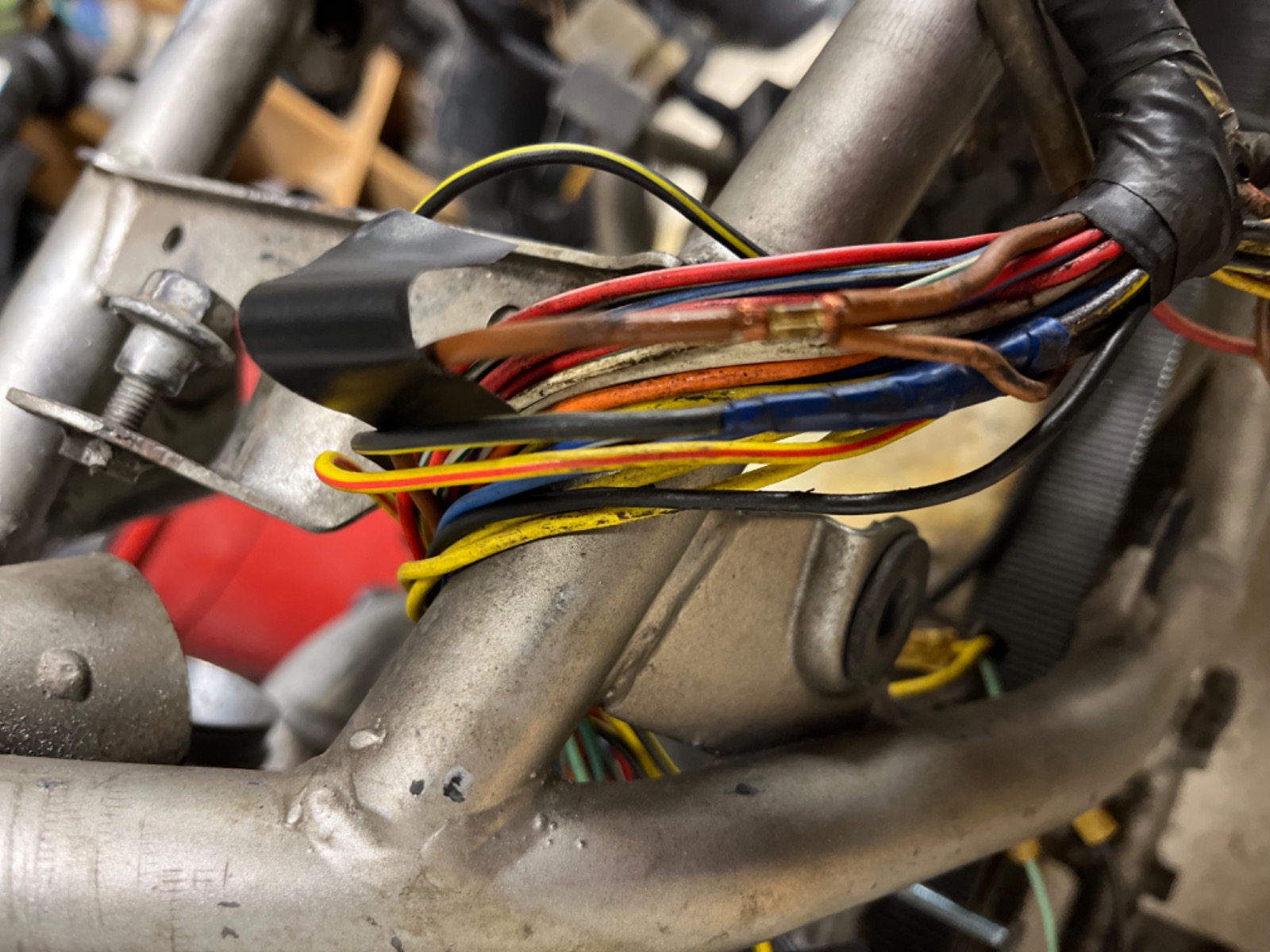

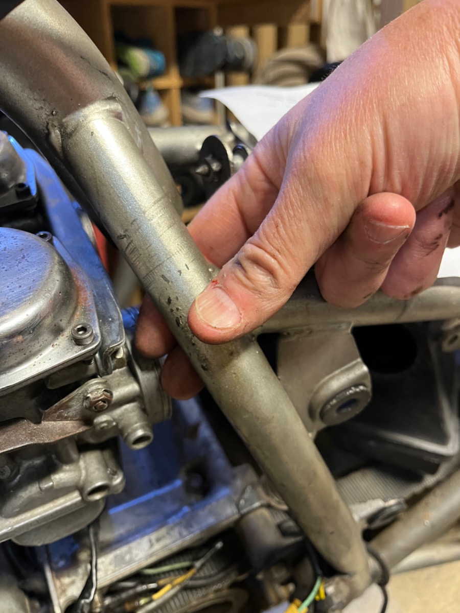

I am trying to route the chopped up harness, and the way the PO had it does not make sense. Everything is too tight.
Does the main harness Travel on my finger or thumb side of the frame? Thumb side and the airbox fits, finger side seems more natural but still not right.
thank you!
thank you!

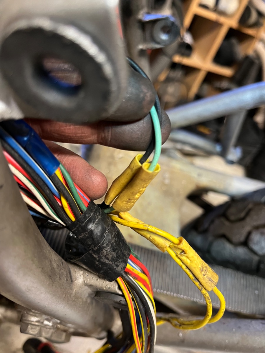

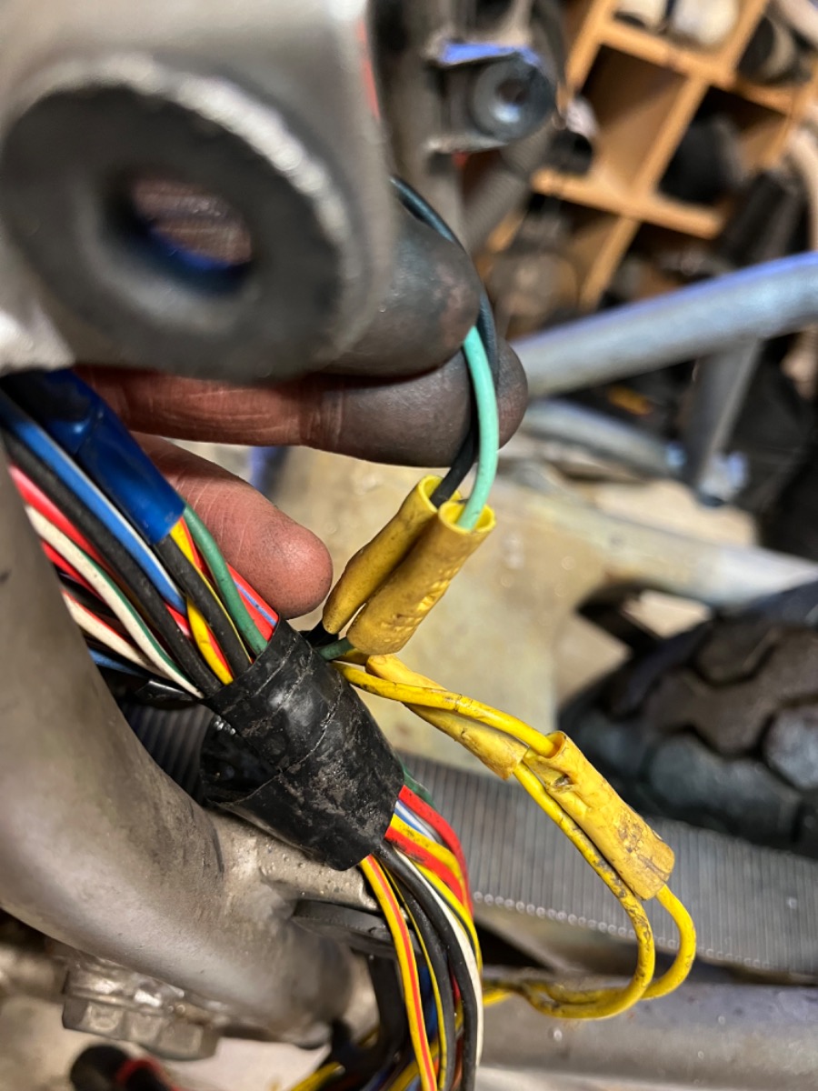

I think I have it.
The alternator, neutral and oil light lines have all been cut and badly spliced. Once unraveling the mess and removing the plastic corrugated POS tubing the layout makes sense.
I wish I knew what the hell he was trying to do.

all wires inside.

Sorry for all the dumb questions. The repair manual provides some guidance but having to undo what I can see is wrong without seeing the way it should be is proving difficult.
I was able to reroute most of the harness so that it rides along the inside of the frame rails. The cut wires for the prior post need to be fixed before I move forward, so I hope the bullet connectors come in soon.
As I go through the harness I keep finding little blue packets that have crimp connectors. They kinda line up with the wiring diagram so I assume that is factory? The problem is where the loom has been unwrapped the blue tape is falling apart.
