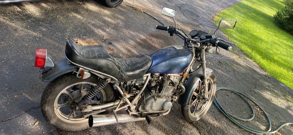

So two weeks ago I bought a 1981 KZ440 LTD belt drive, almost running, $500. I am affectionately calling her the Pig.

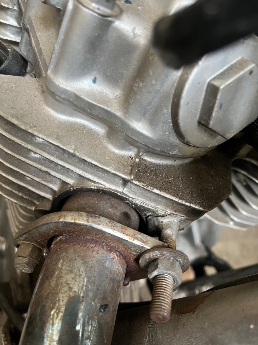

I will admit up front I do not have a lot of experience with this, so my initial walk around did not reveal the welded on exhaust bolt, broken master cylinder, and a few more surprises yet to be found most likely. I was hoping to buy, fix and modernize an older bike as a project, and I have one.

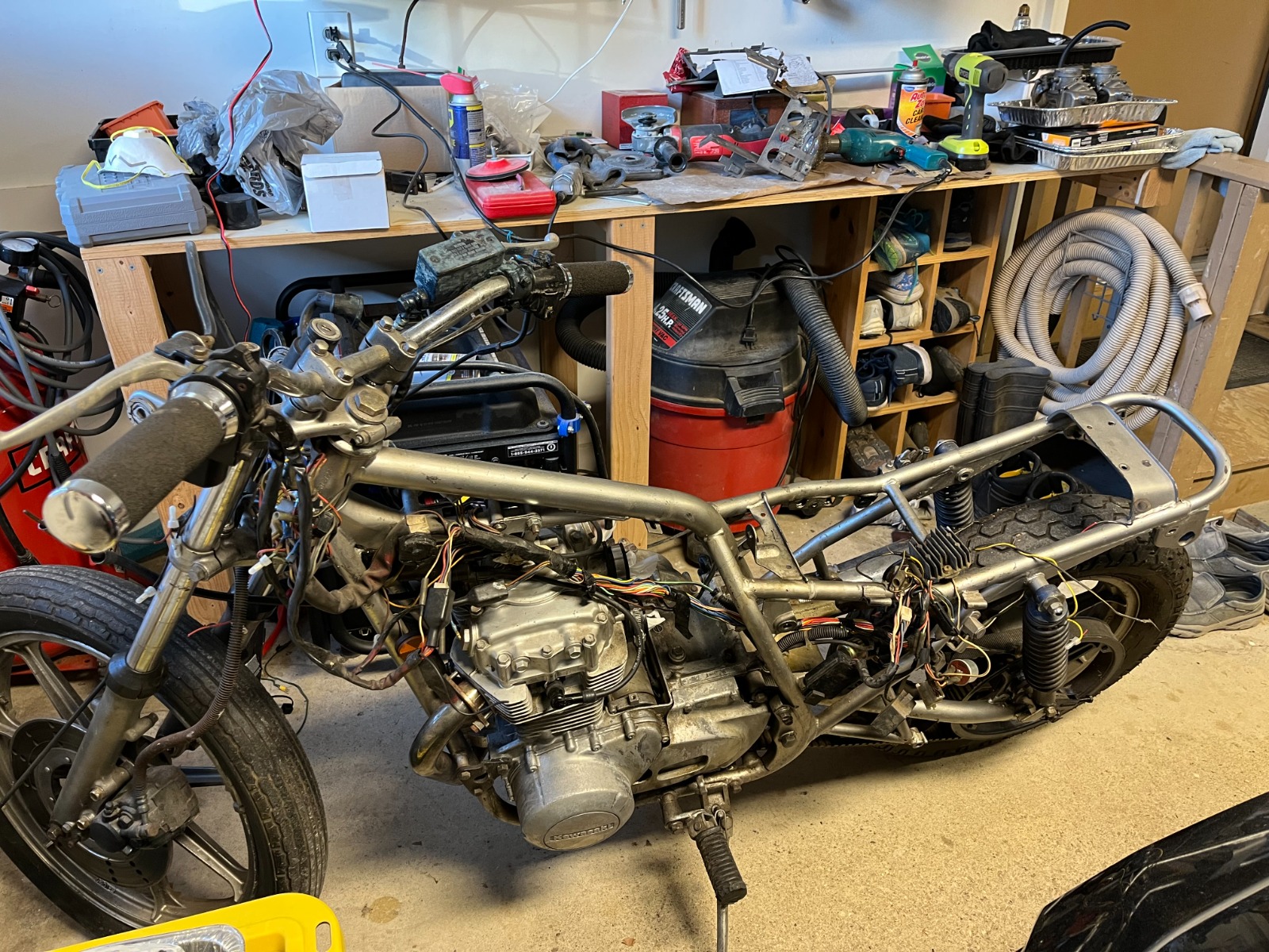

So the more I looked it over the worse it looked. A prior owner took it apart to paint the frame but did not do a good job of putting it back together. The wiring harness looks somewhat hacked into, new turn signals and such, and a number of stripped screws and bolts broken off in their mounting holes. I was hoping I was not going to have to tear it down to the frame, but off I go.
I am cleaning up the battery box, need to order new clutch and throttle cables, replacing the various buggered bolts, and trying to remove the awful rattle-can paint that is everywhere.

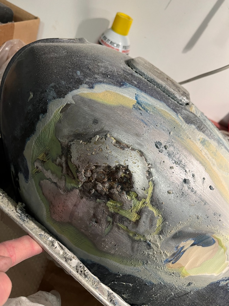

"Pig" is right.
That tank...
That's one for the books. I'd buy a replacement tank right away. That is junk.

That tank...

ditto on the tank. Just replace it.

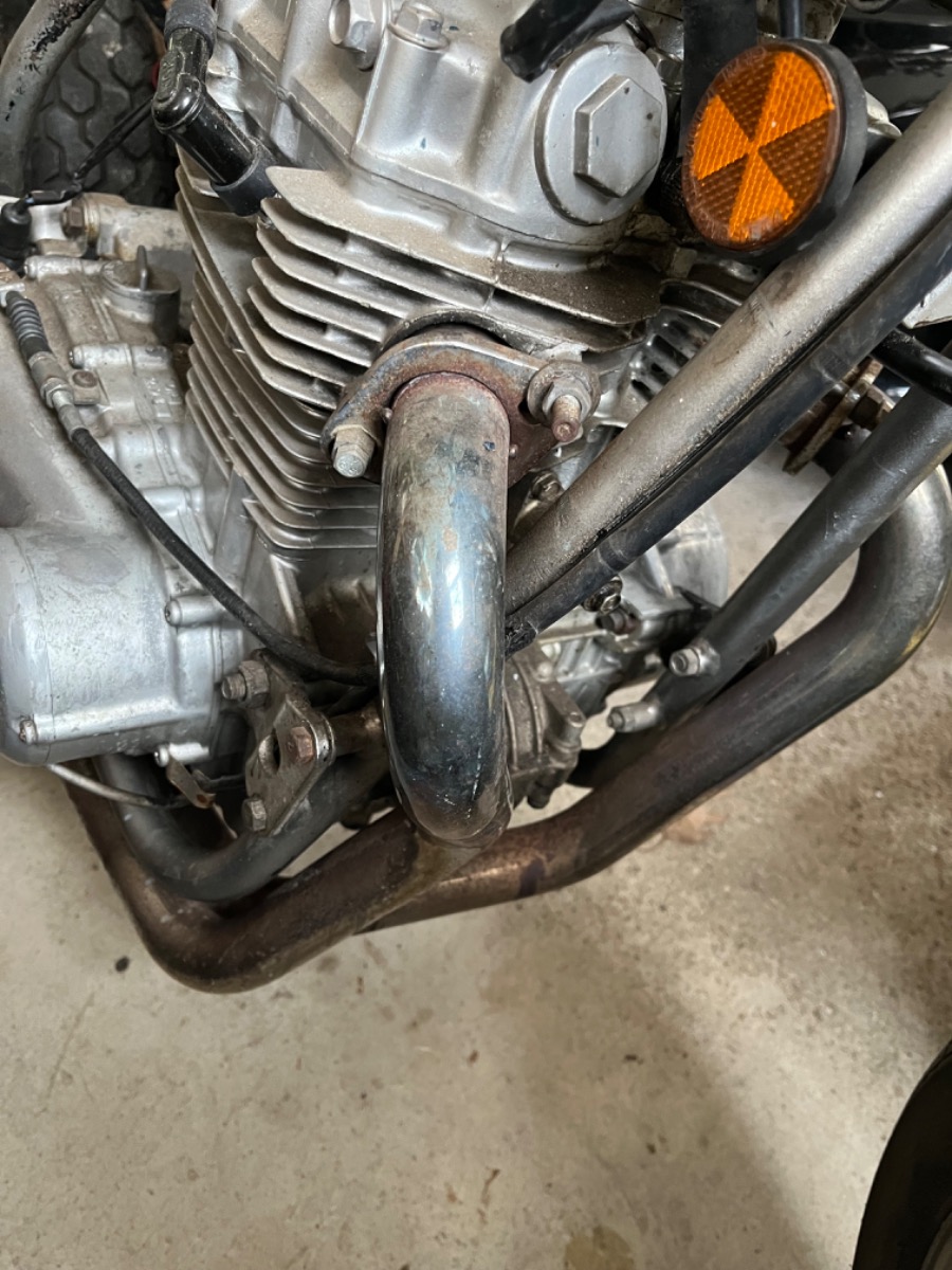

Has it got the correct exhaust system? The silencer part is visible on the right, and it seems correct, but the original was a 2-2 exhaust, with a pipe on either side of the bike. The header pipe for the left cylinder doesn't appear to have the correct exhaust mount retainers. I could be wrong on this as there are differences between the models which are not documented in the manual. But maybe that's why he damaged the exhaust bolt and bodged it on.

Thanks for the replies, advice and encouragement. I will be ordering a tank and replacement MC. There are some on EBay, not very good looking but hopefully functional.
And it turns out I had a Tank-O-Lantern!

Not the original exhaust. I might try to get replacement exhaust mounts. Maybe helicoil assuming what it looks like under that welded exhaust stud?

That's not helicoil, that's some dude's solution involving welding... I just wonder what the problem was. I think the problem wasn't that he couldn't remove the stud, but that he damaged the thread. But if it works and there isn't a crack going into the head, I'd keep it, because your only alternative would be to replace the head. The original exhaust mounts have little cooling fins on them, but more importantly they have a recess to fit steel half-collets which press against your exhaust gaskets to form a seal. I just wonder why he did that. Maybe he had the original exhaust mounts but couldn't push them far enough down onto the studs to fit the nuts?
Also, your photo confuses me because I stated you had the older style of clutch cable, but I see you've got the newer one going straight to the clutch side of the engine. But the right-hand side of the engine has the clutch adjuster for the older model.

According to the VIN it is an ‘81 D3.
i will have to look up the proper clutch cable.

07 Apr 2024 19:22Also, your photo confuses me because I stated you had the older style of clutch cable, but I see you've got the newer one going straight to the clutch side of the engine. But the right-hand side of the engine has the clutch adjuster for the older model.
I believe the front sprocket (pulley) cover on the left side of the engine is not the right one, and the adjustment in the middle (under the missing cover) is not being used. There appears to no clutch cable going to it, so I guess it was replaced for some reason.

The fiche for the D3 model has the clutch cable on the right side. Part 11012C - Adjusting Cover Plate is also listed but I need to look through the service manual to understand what is going on.
