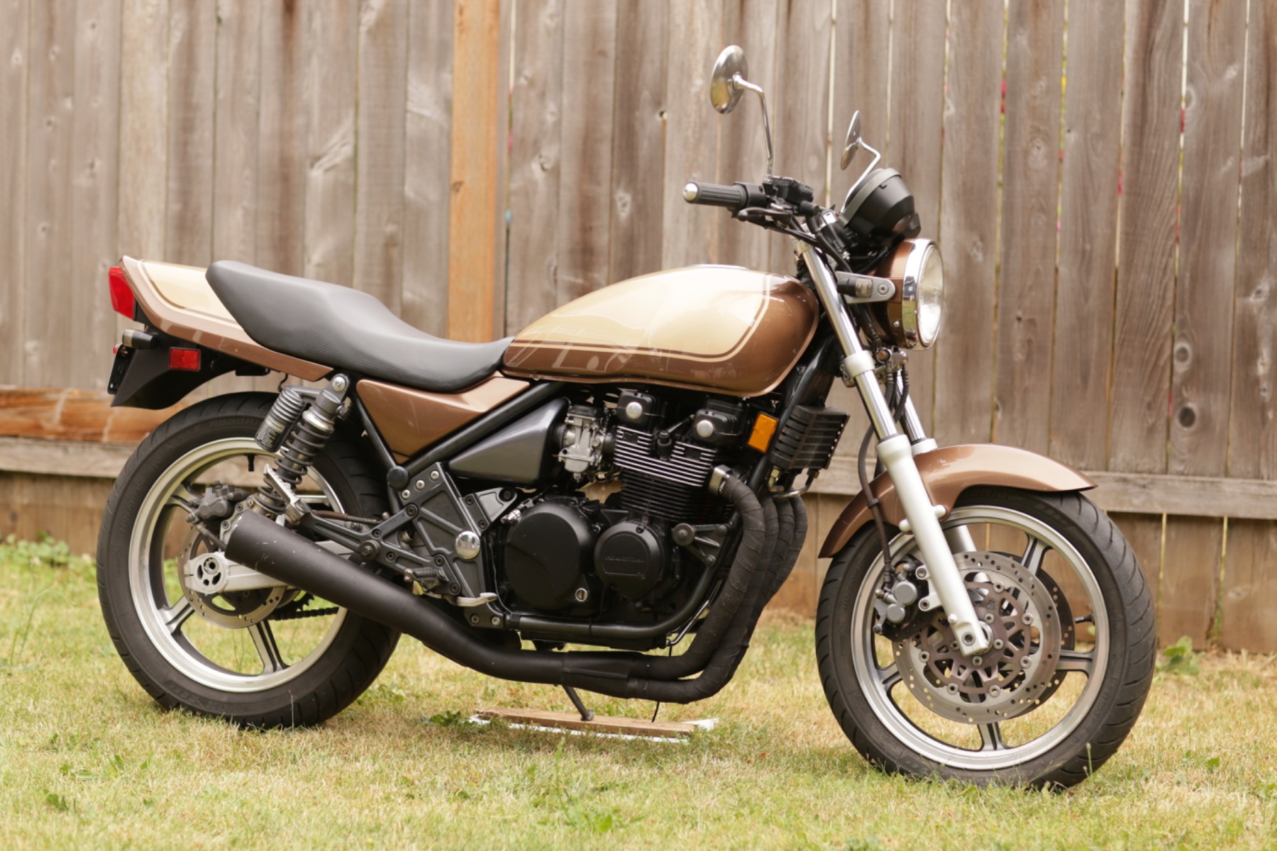

15 Jun 2023 10:06Got a better photograph and the front fender is on now.
And yes, I checked, and the front tire is on the correct way.

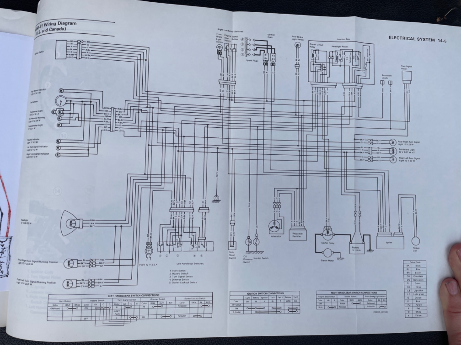

Do you have a wiring diagram for the bike (usually Kawasaki ign live to the flasher is orange and the output to the switch is orange/green) with regards the 3 wire, you don't do anything with that for the bridge test as all you are doing is taking the relay out of the circuit to check the switch and wiring. The third wire is dependent on the unit you are using (some go to the panel light some go to ground) did you get wiring instructions with the relay you bought?

If they are flashing at the correct speed and the dash warning lights are working also then you are good to go with the 2 pin (the third pin is specific to some units, especially those that aren't load sensitive but you aren't using LED's anyway) Would still like to see a wiring diagram for "peace of mind"

21 Jul 2023 09:09
