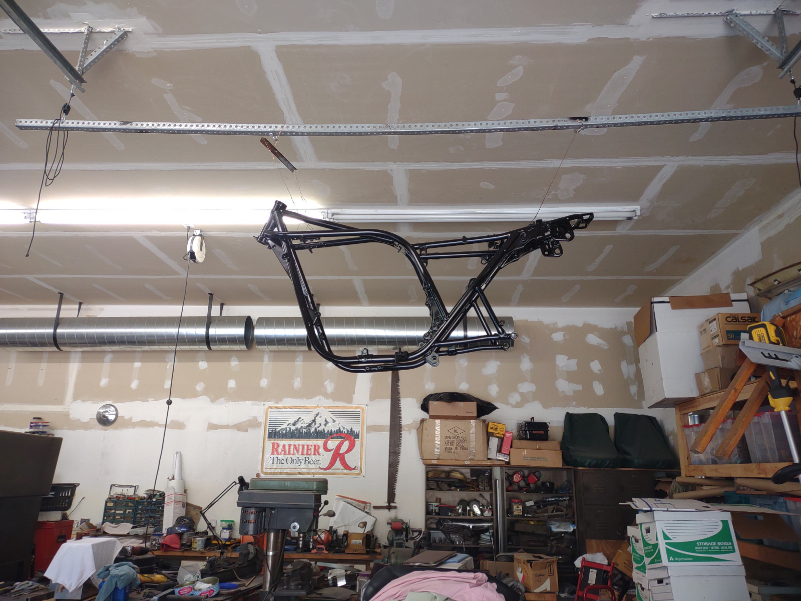

Re: Project: 1990 ZR550 Zephyr (yes, another one)
10 May 2023 08:34
Nice job on the painting parts rack.
I use two 12' lengths of perforated angle iron for hanging garage door openers. One for all of the parts and one to hang the frame from.

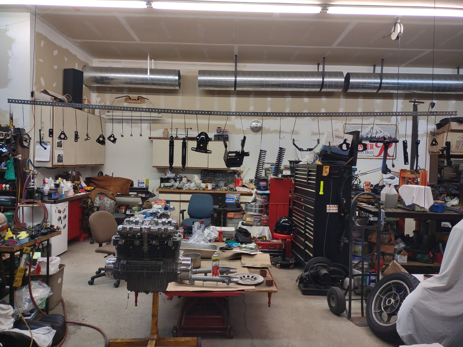

10 May 2023 08:55
- Kelly E
- Posts: 572
- Thanks: 477
10 May 2023 14:16
Thanks Wookie, it's 1400sqft with 12' 6" ceiling height and heated. It's big enough to share work space with two of my friends.
10 May 2023 21:15
Consider me jealous. I make do with the little bit of space I have, but it would be nice to spread out a bit more.

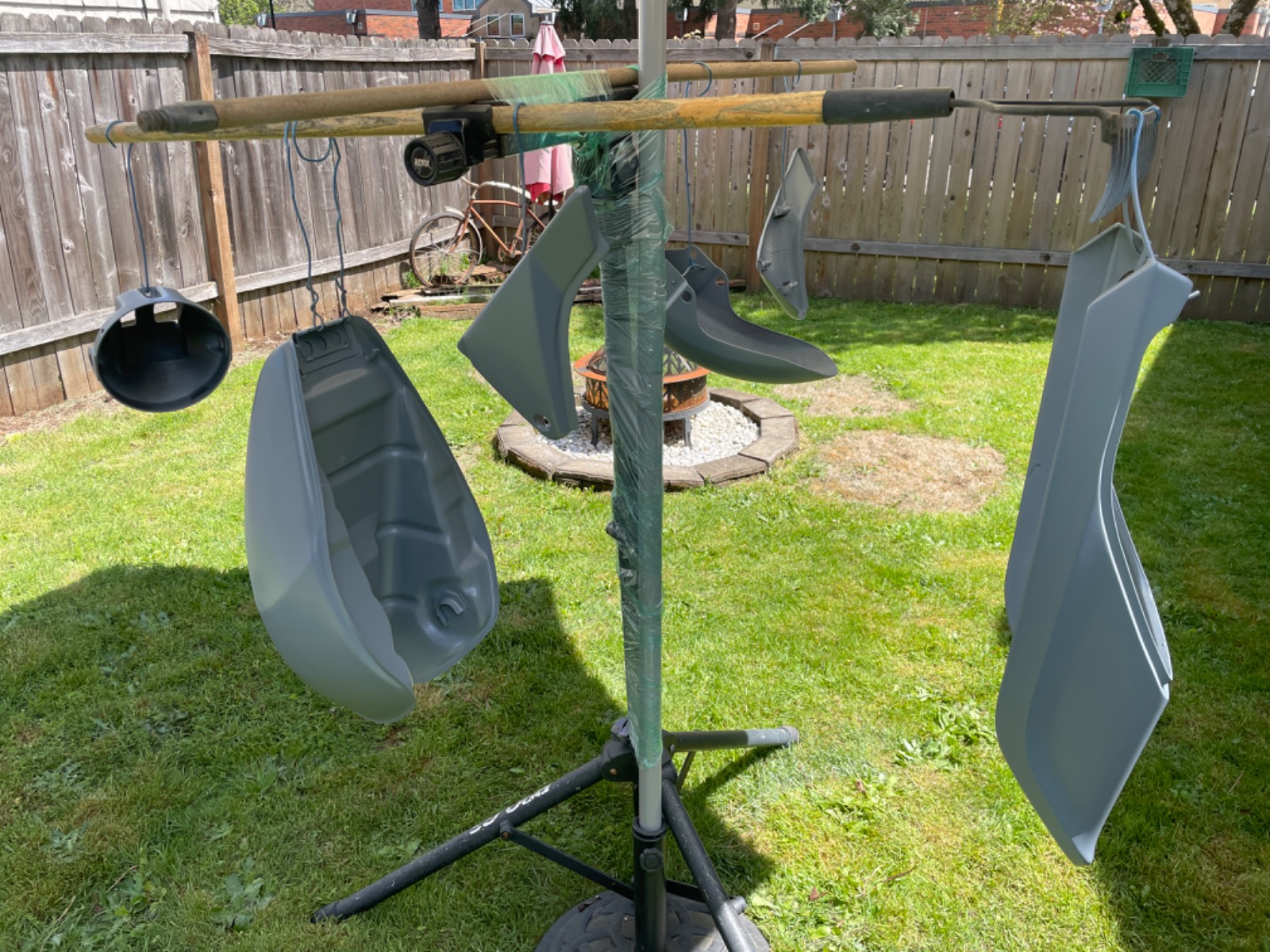

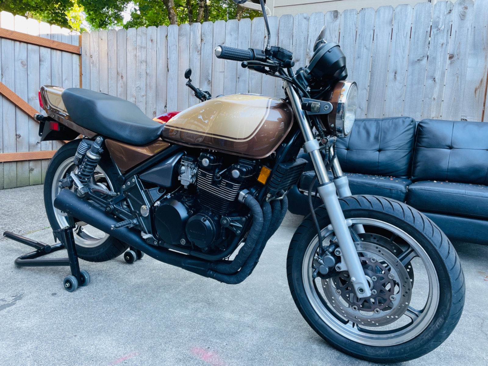

- Stereordinary
- Posts: 477
- Thanks: 192
11 Jun 2023 20:53
Painting went well I’d say.
The fender is painted brown as well, but I need to rivet it back together with the brace still. I also have some ideas for a tank badge/decal.
Tomorrow I’m gonna pick up some oil, a battery, and some gas, and see if she starts.
12 Jun 2023 08:25
Wow, you've made a lot of progress in a very short time! Good luck on the first start up I know how nerve racking that can be with an unknown bike.
One question....is the front tire installed in the right direction? I always thought the tread should wick the water away from the center of the tire.
