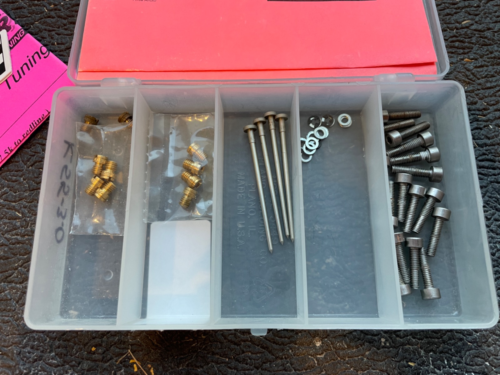

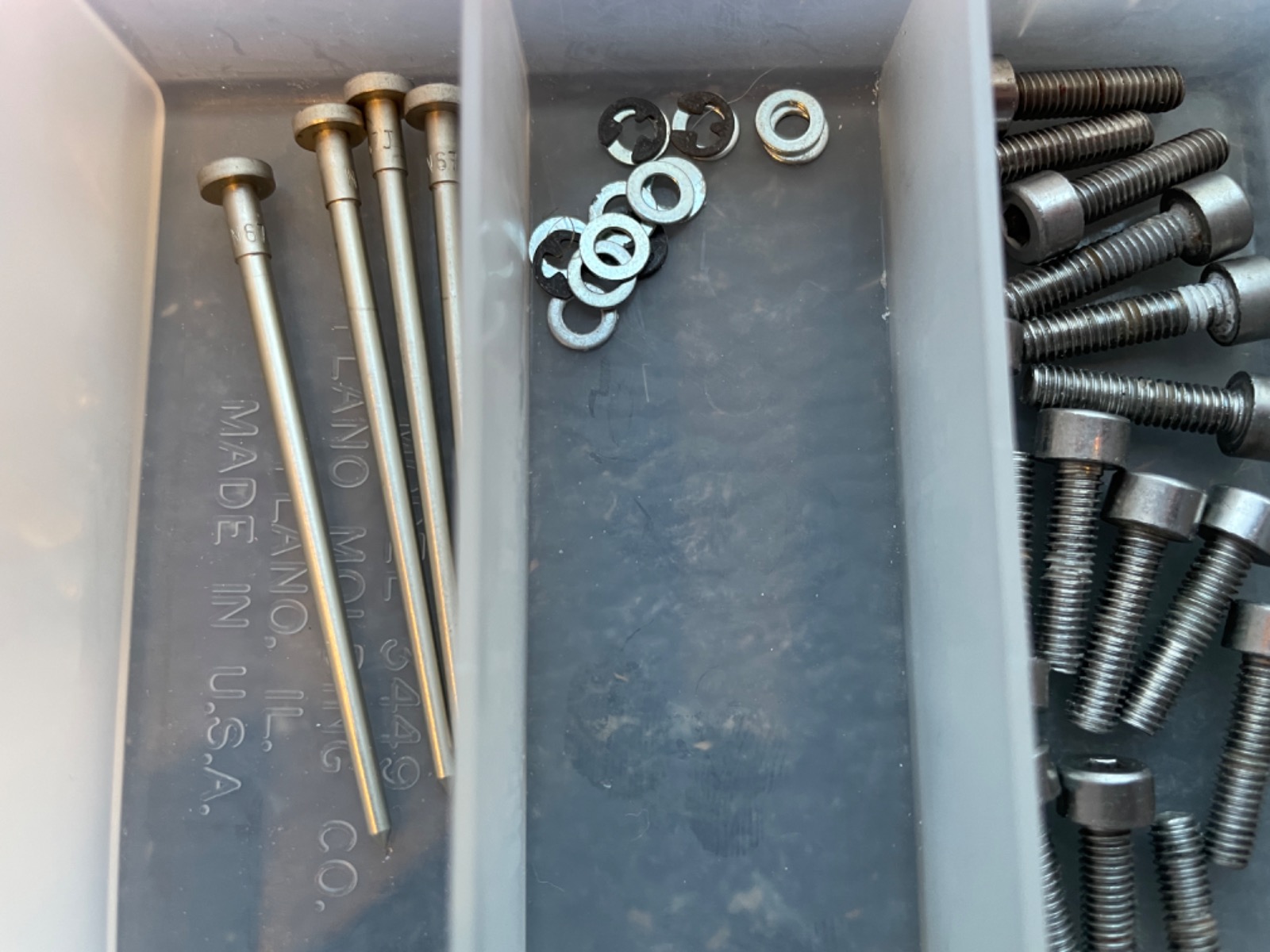

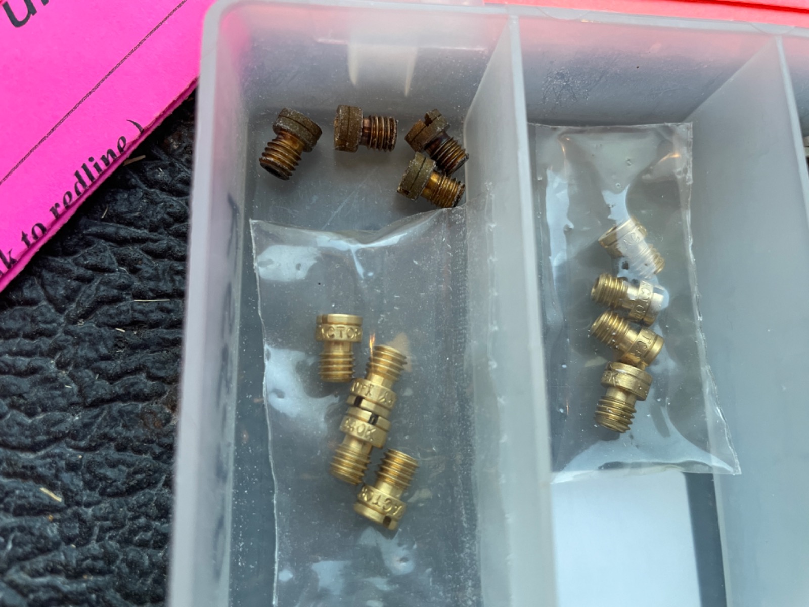

My theory is that the PO rejetted the carbs for pod filters. This is an easy assumption because when I got the bike there was a lot of parts in bins, including the carbs, and they were fitted with pods when I found them. There was also a Factory Pro jet kit in there.

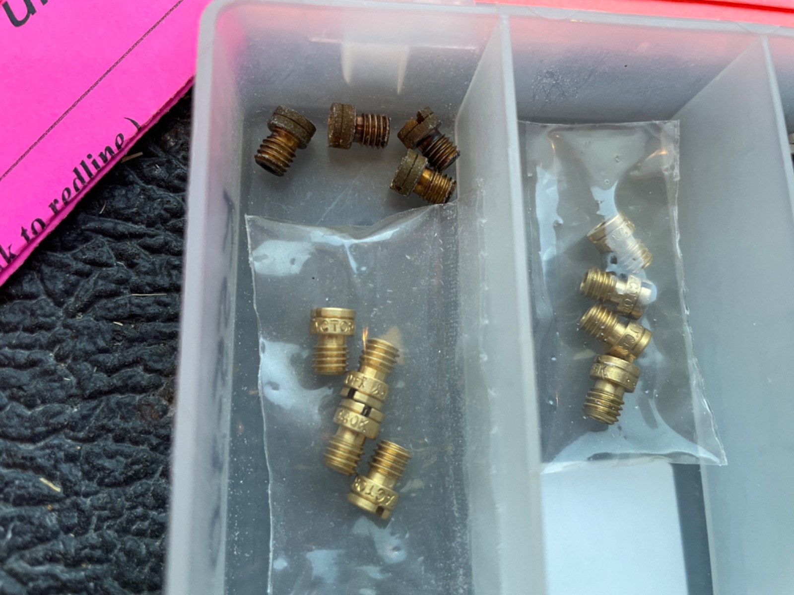

So I think the obvious thing to do is see if I have the original jets and get them back in there. It looks like maybe I do, but im not entirely sure how to identify OEM versus aftermarket jets, and where to purchase replacement OEM jets if I need them.

Keihin jets will have a "K star" and some type of number on them. At least the ones I have seen did. As to locations to find real jets, I am sure others will chime in, but there are several online locations one can find them. You might try jets r us for starters and check other locations as well.

Yesterday I took the carbs out, and found that it had the needles and main jets from the Factory Pro kit installed. I put the OEM ones back in, and readjusted the pilot jets to 2-1/2 turns out.

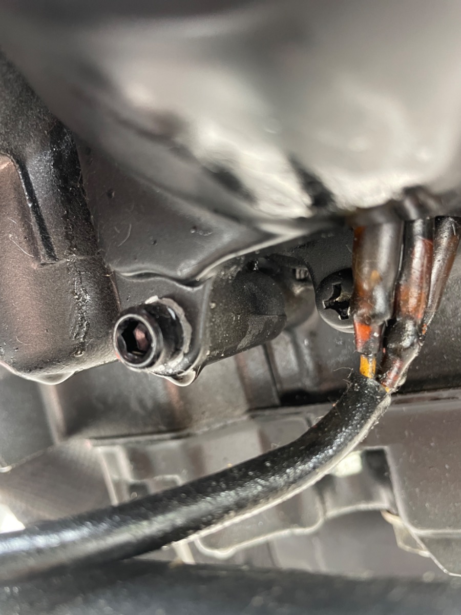

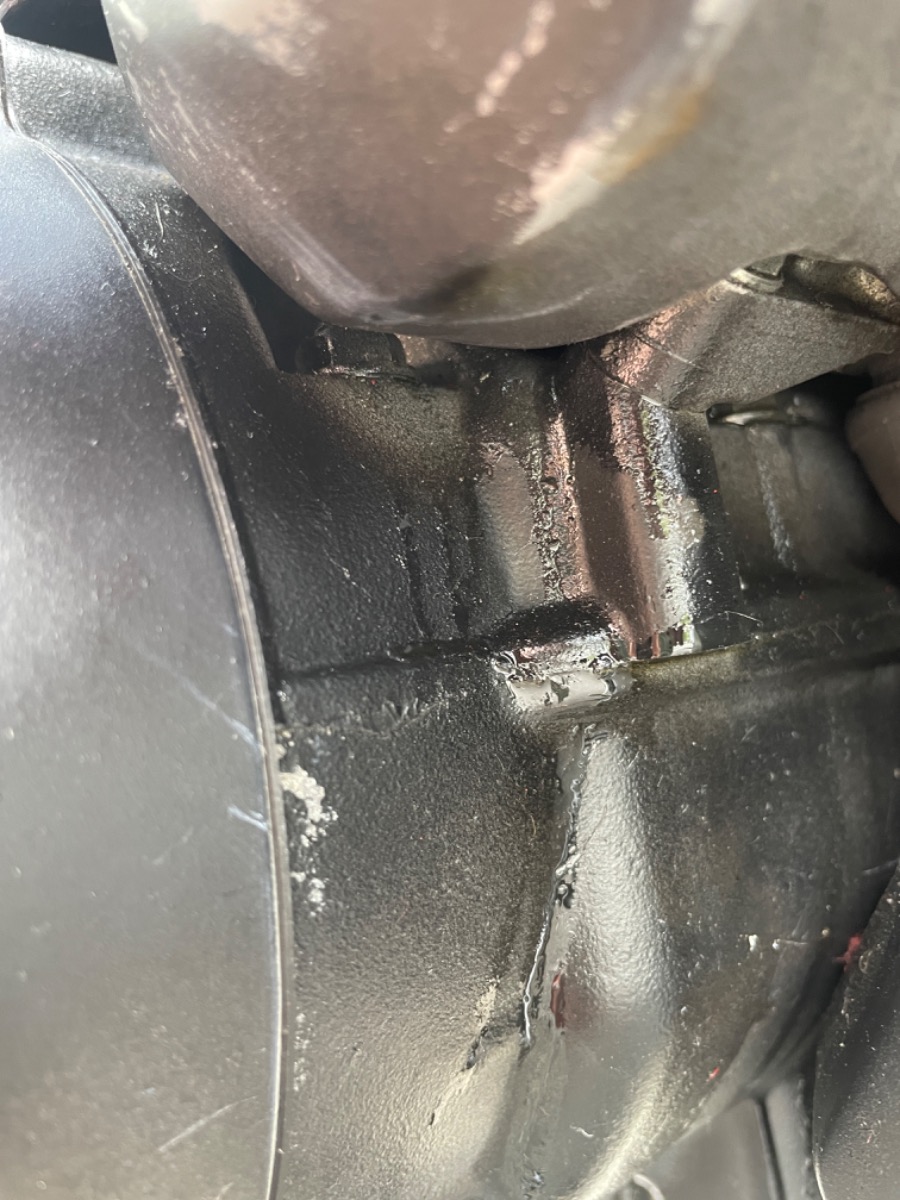

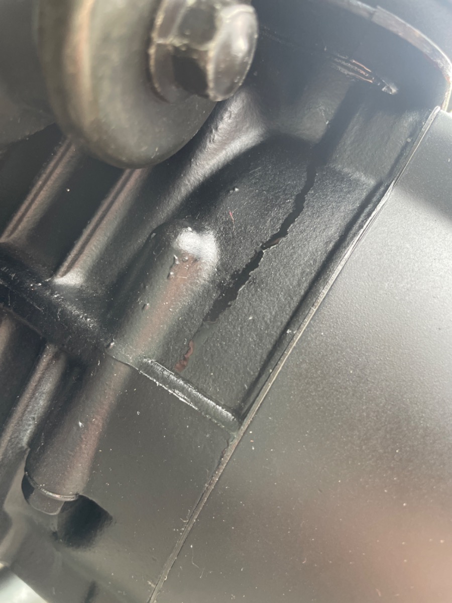

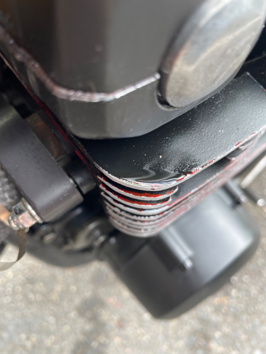

I’ve got an oil leak on the left hand side. I feel like it’s probably just a bad gasket. Perhaps the previous owner installed a non-OEM cheap-o gasket. I know for sure the cam cover gasket is crap as I installed that myself (bought it from eBay listed as OEM, but I’m pretty sure it’s not, already bought a replacement). While it does seem like some of the leak is coming from there, I think there may be another coming from under the cylinder block.

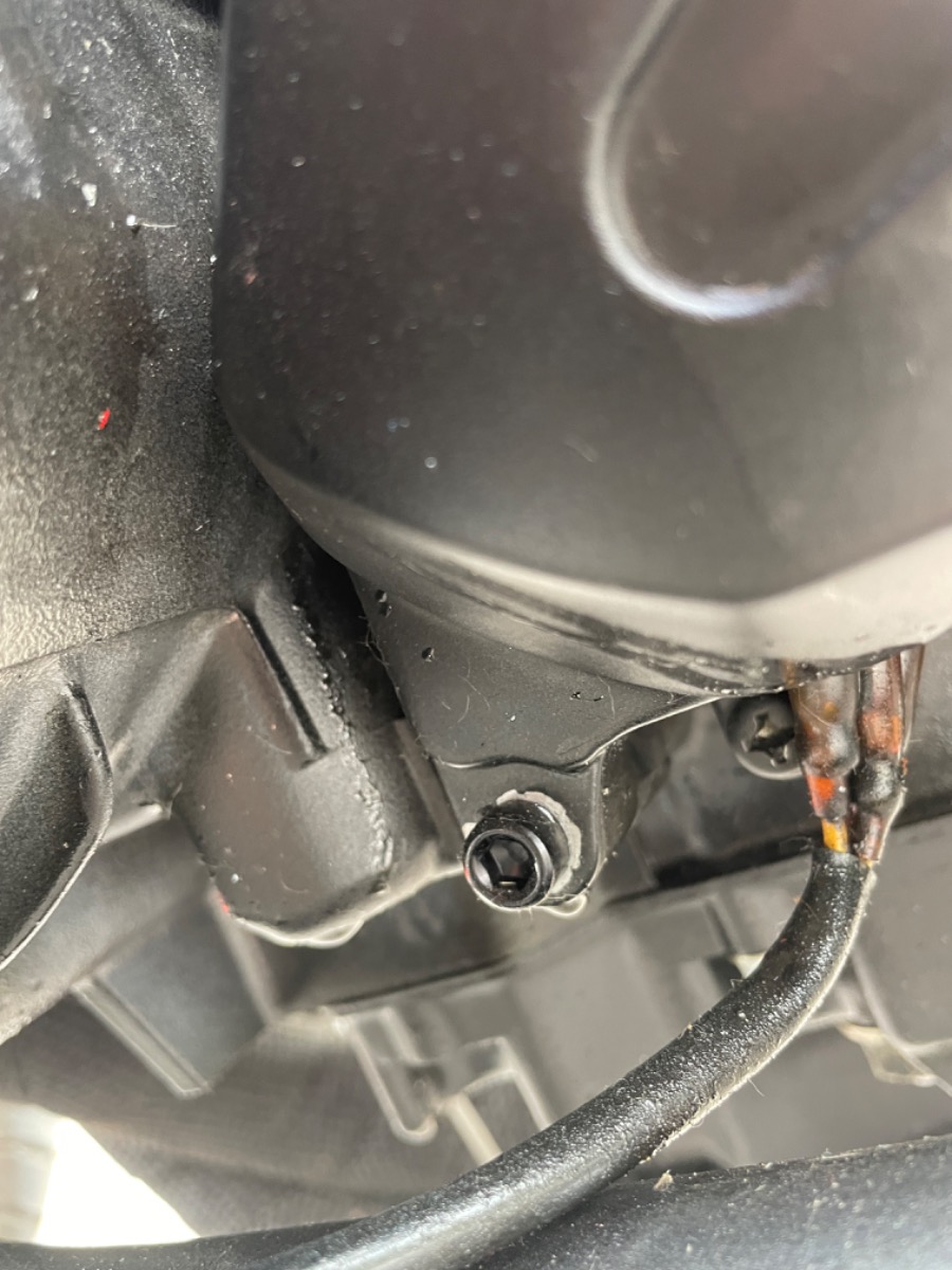

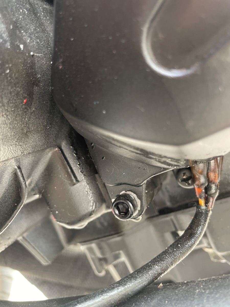

And finally, I am perplexed by the manual cam chain tensioner. I have manual cam chain tensioners installed on both bikes, but one sticks out with room to go in way further than the other one. I followed directions for installation to a T, but given what I’m seeing I feel like one of them has to be wrong.

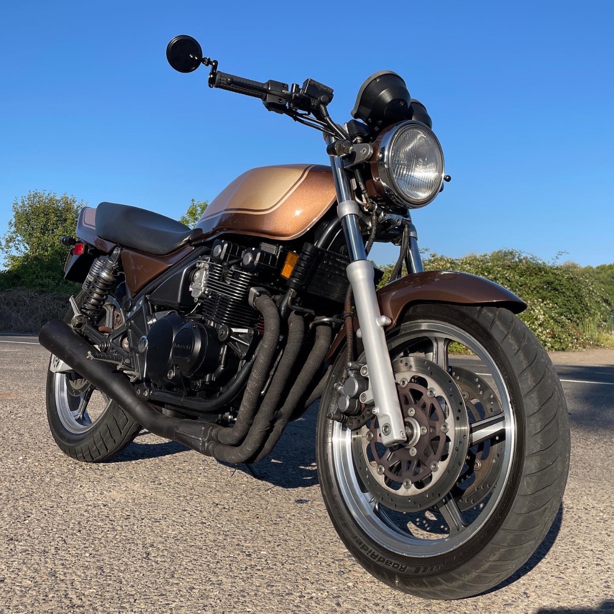

The cooling fins on your Bronze / Gold Zephyr cylinder head look uber cool!
H.

Start with a clean .. really clean bike/engine and pay really close attention?
