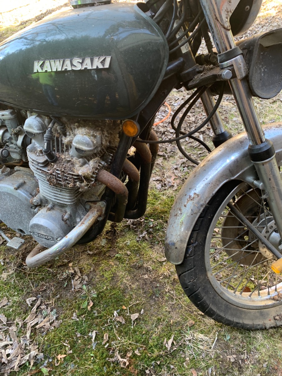

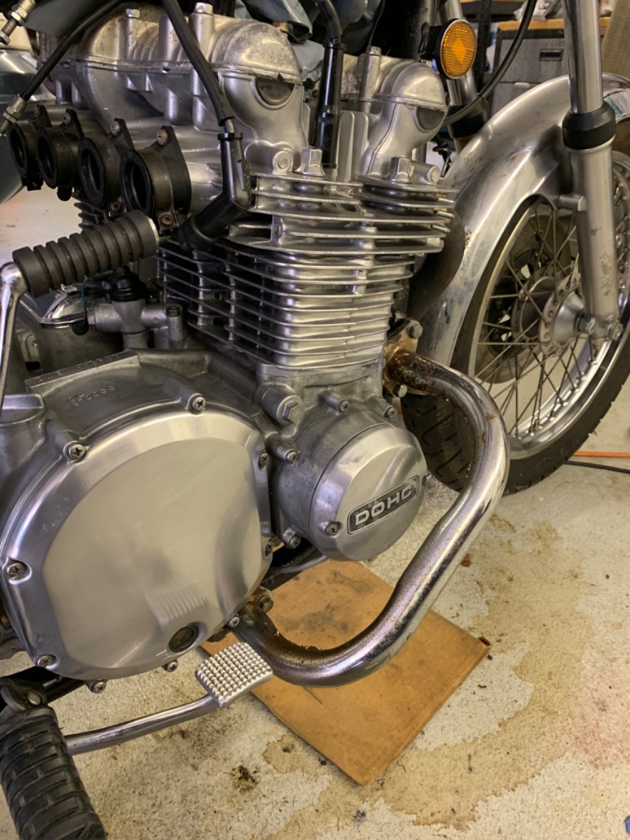

Experimenting with different products to clean engine and covers before removing from frame.
Before and after
Before and after

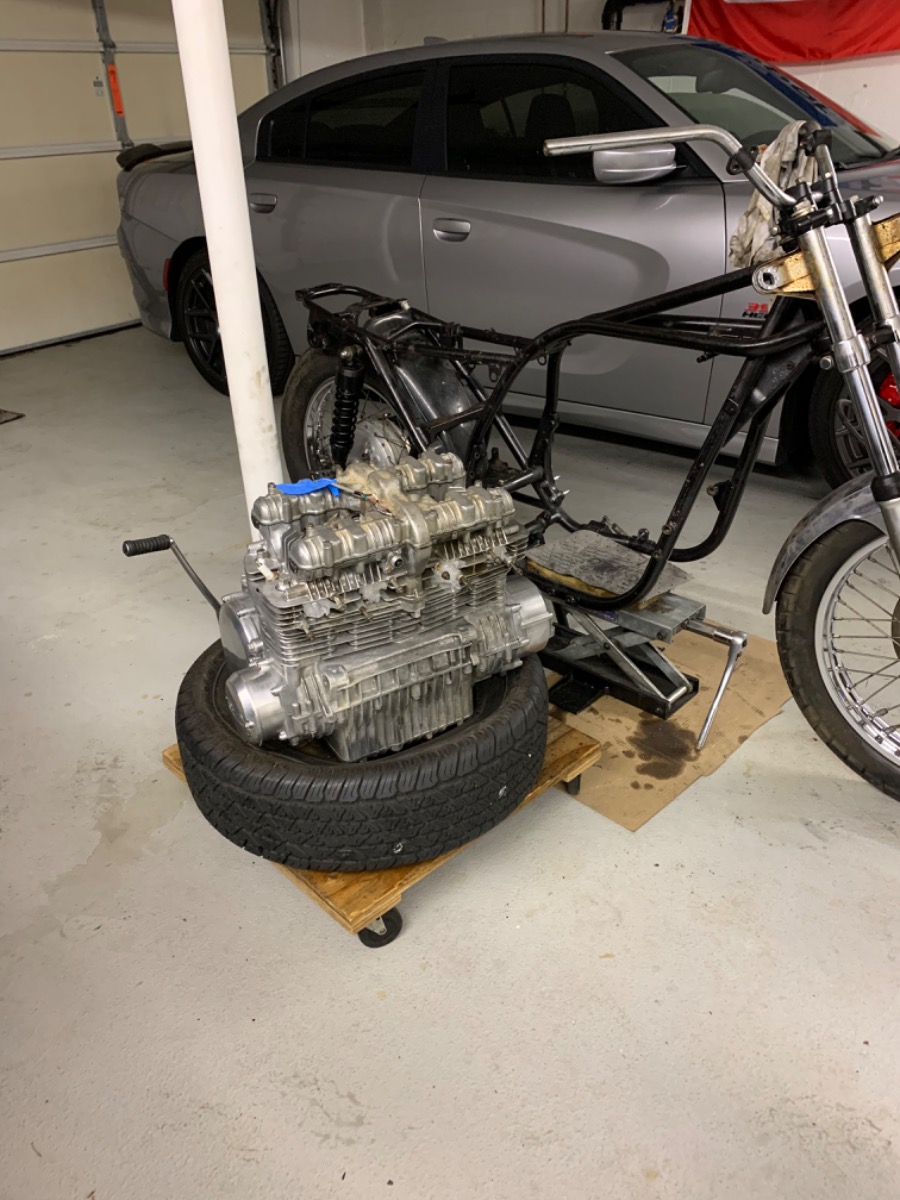

Have it mostly stepped down, engine out. Wheels and suspension later this week then off to sandblaster/ powder coater.
