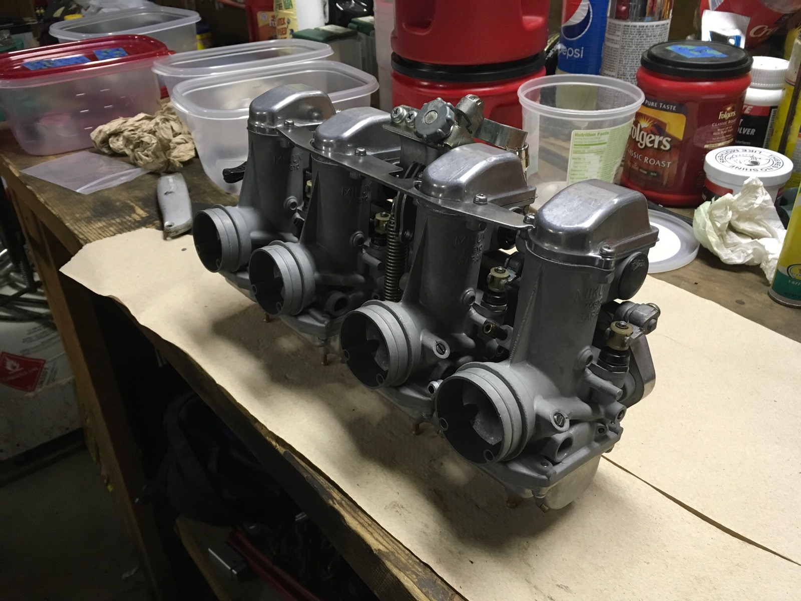

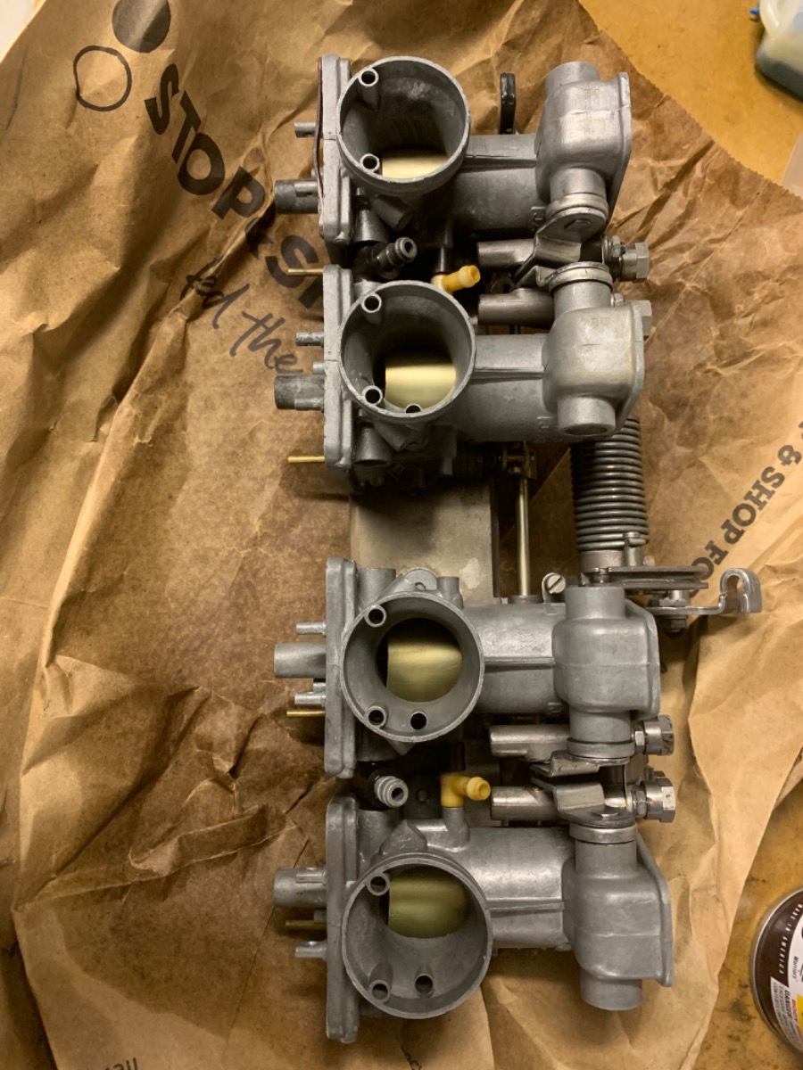

Here they are after pine sol soak, dawn and hot water, mineral spirit bath then blown out with compressed air. All brass soaked in Berryman dip.

Big difference. Nice job!

You should split the carbs. The small rubber coated fuel Tee's are almost sure to be cracked and need replacing.
