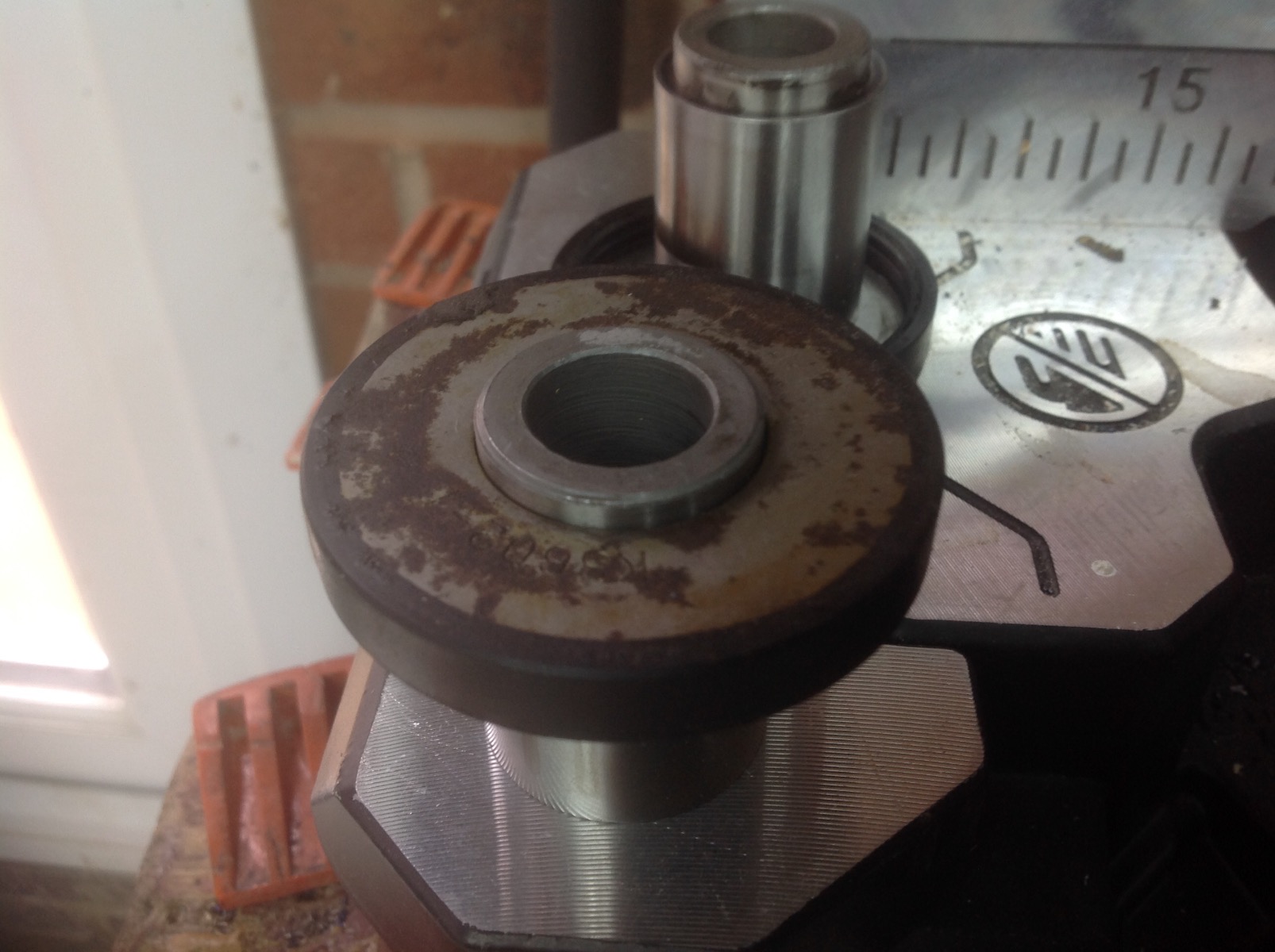

Front end:I am using ZX9R C1 RWU forks as I prefer the look for what I have planned, I bought forks, trees, front wheel and brakes all for a C1 (I prefer where possible to use parts that were designed to work together by somebody far cleverer than me) The C1 stem is a little short for what I need so it looked like I would have to go custom, however in the interim I had an idea for a fork service tool that would hold them without damage in the vice. After a bit of research I found that some ZX6R's use the same 46mm forks (with shorter tubes) so I bought a 6R bottom tree with a broken lock stop for £7 to make the tool (I love the 600 parts mountain) When it arrived I had a happy moment, the stem is longer than the 900 as it uses an external top nut whereas the 900 is a recessed flush nut, also the top bearing is the same size as the KZ. So the next problem was the 900 bearing retaining nut is too big for the 600 stem, I looked these up and found they are £12 each and on back order. So back to evilbay for another 600 bottom tree with the retaining nuts for £18 (25% less than just the nuts from Kawa
So now it has all gone to a man to make it fit together, if the stem is the same size into the bottom tree it just needs the diameter reducing to fit the KZ bearing, if not he will make a new stem and also he needs to make a custom top nut as the 900 one is made for a thicker stem (25mm as opposed to 22mm)

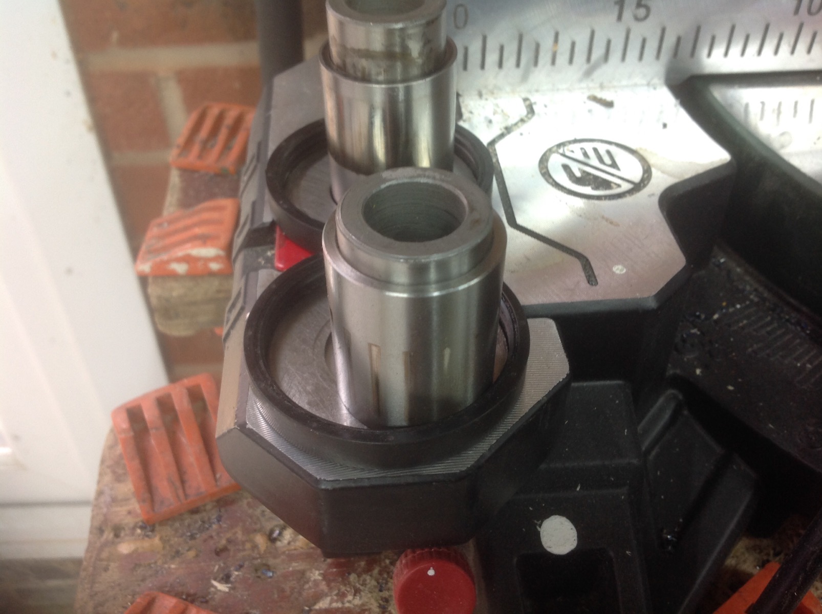

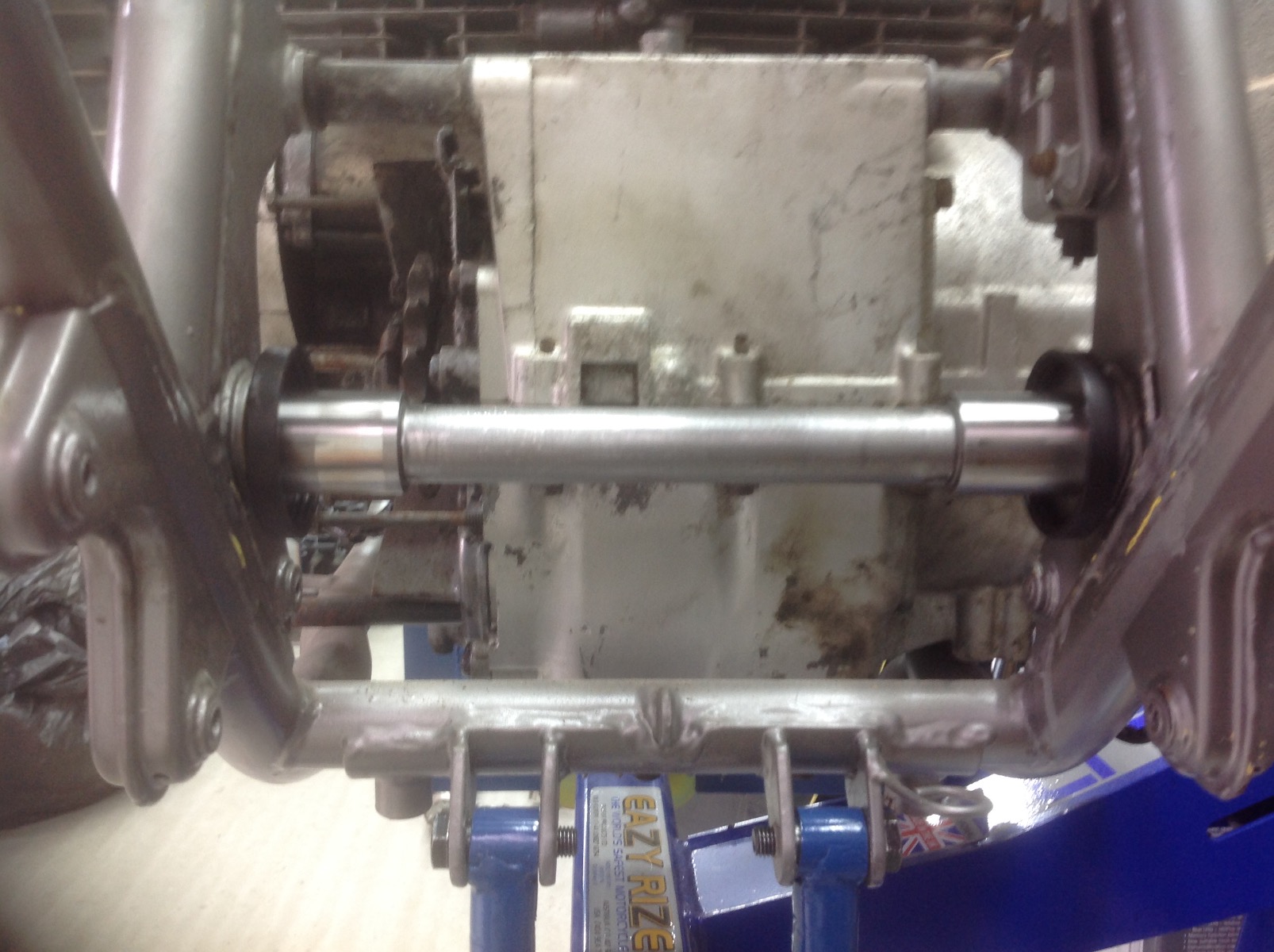

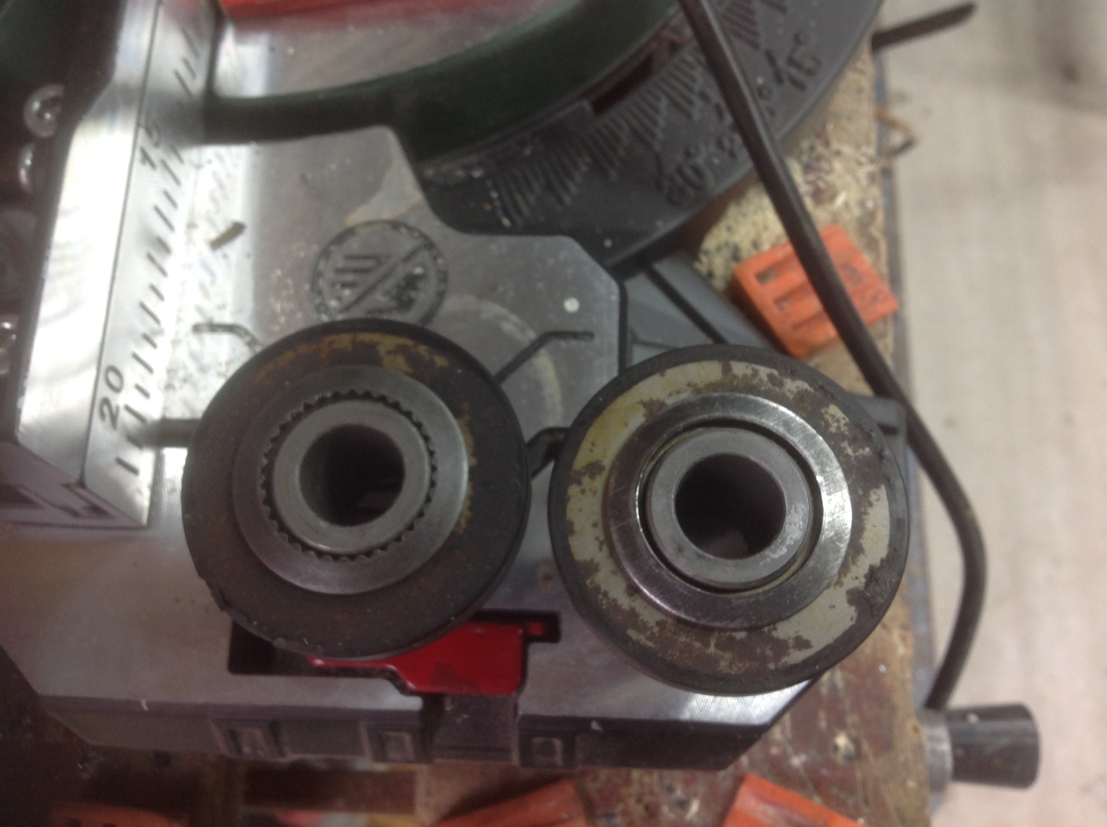

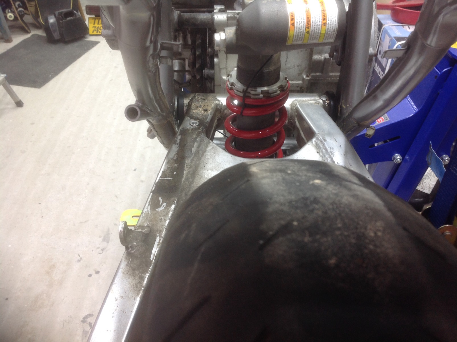

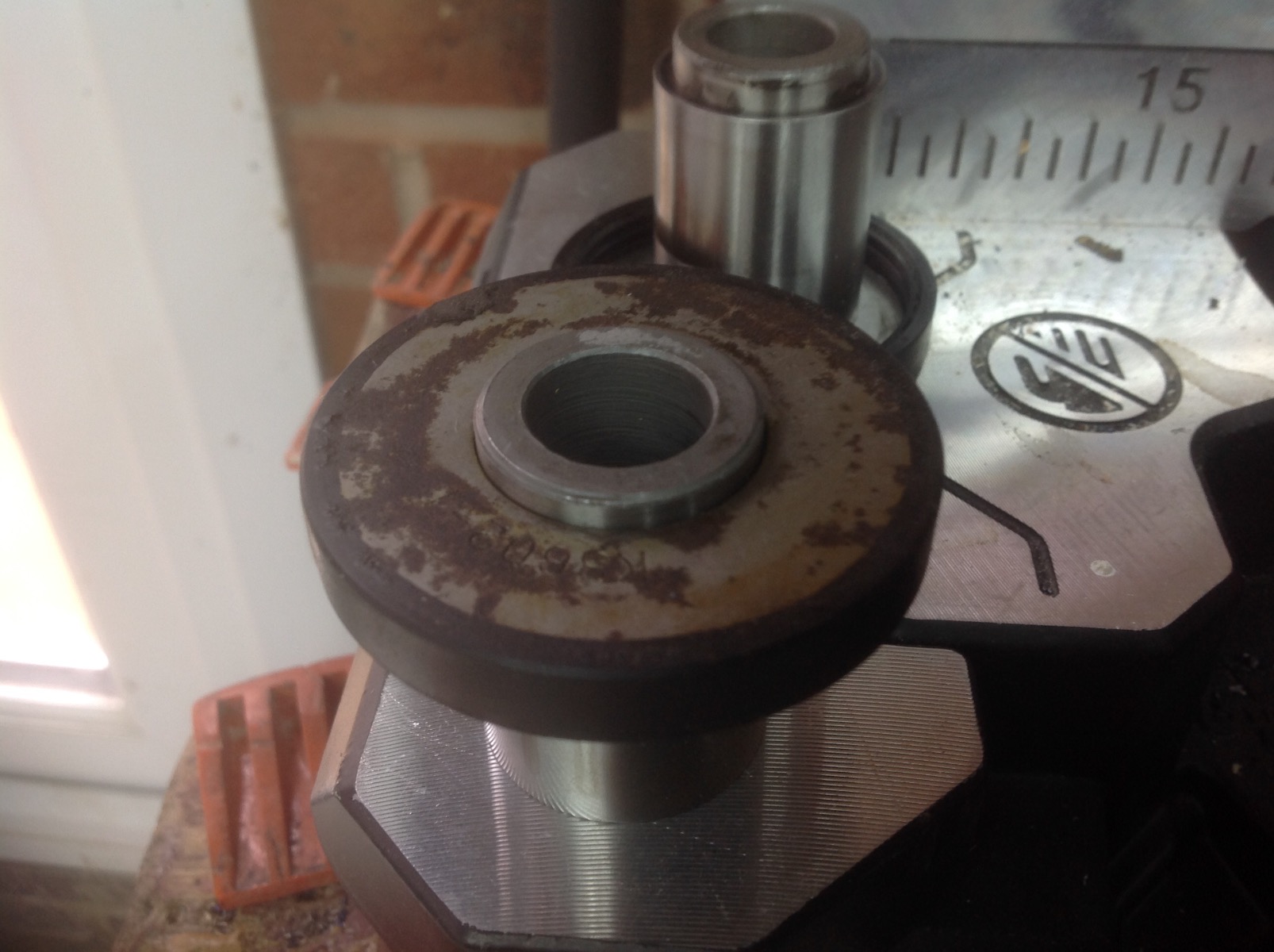

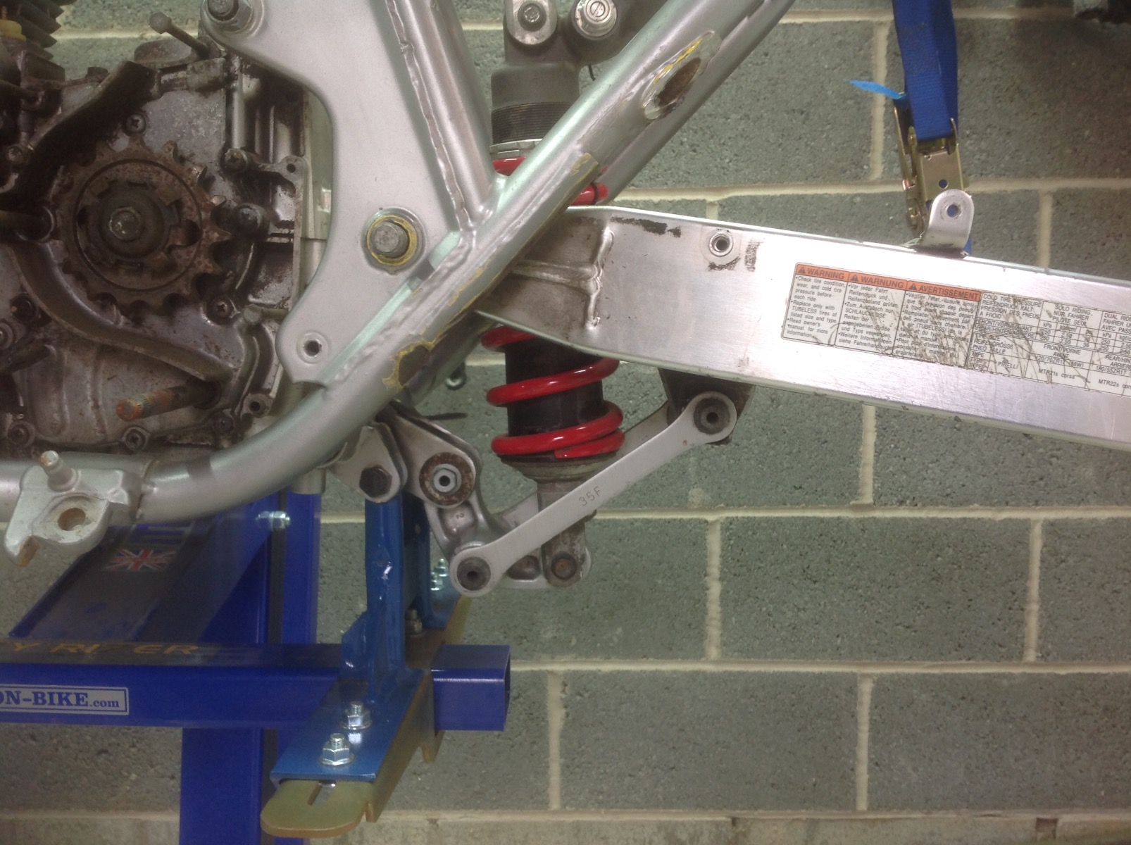

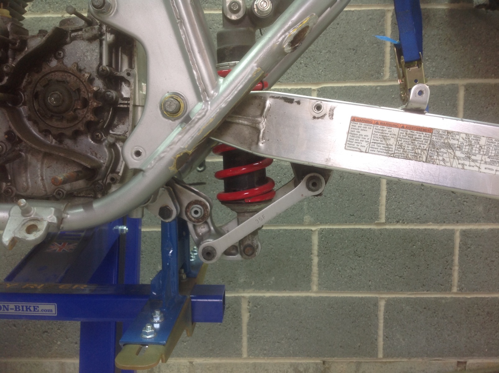

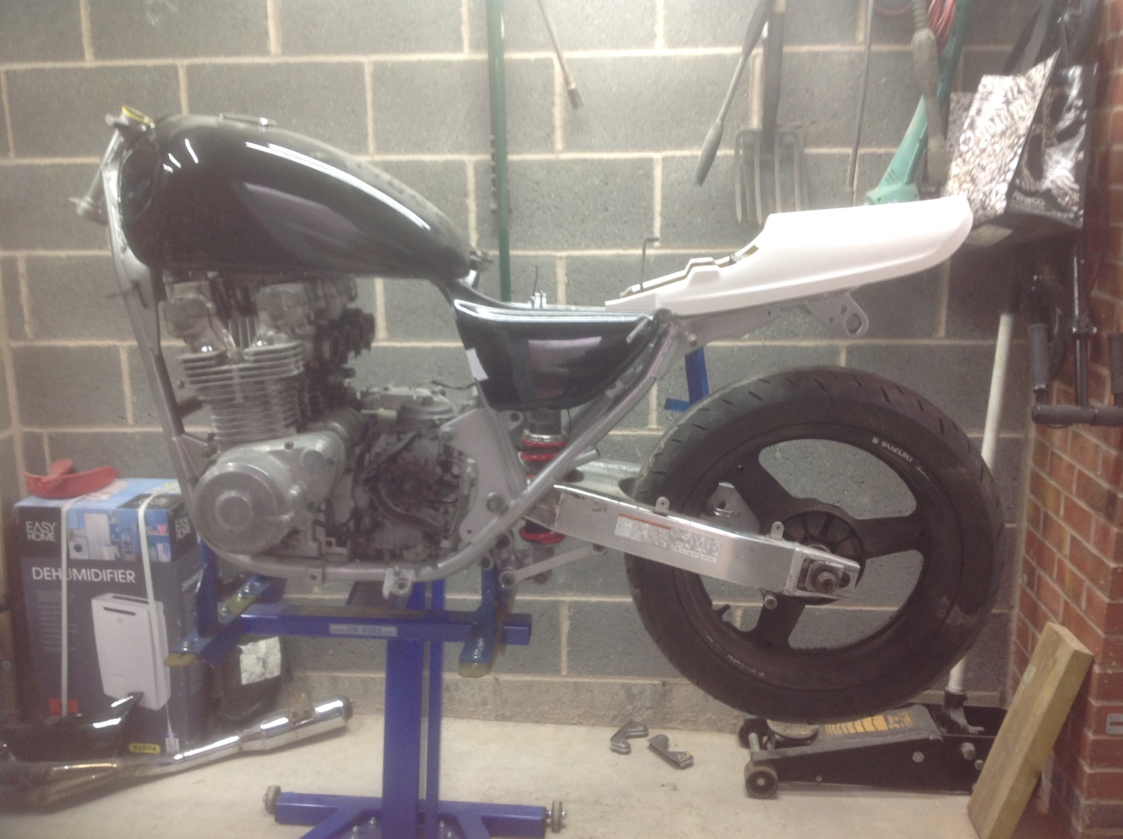

Back end: I am using a GSXR 600K swingarm and linkage with a 1000K shock (taken my lead from Davido's build which was my inspiration) also I did a bit of research ref bearing sizes etc and this must be as close to "bolt in as it gets   the OD of the KZ inner races is the same size as the GSXR spindle therefore the KZ inner races fit side the GSXR inner races and the KZ centre tube also fits inside the GSXR counterpart therefore you simply insert the KZ parts inside the GSXR parts fit the GSXR grease caps and add a 2.5mm shim either side. I paid £25 for the swinging arm so if you where sticking with twin shocks all you would need is shock mounts and axle sleeves ( depending on what wheel you where using) so I recon on a budget you have a beady alloy swing arm in your bike for around $150 a $200   this went together so easy it was almost rude

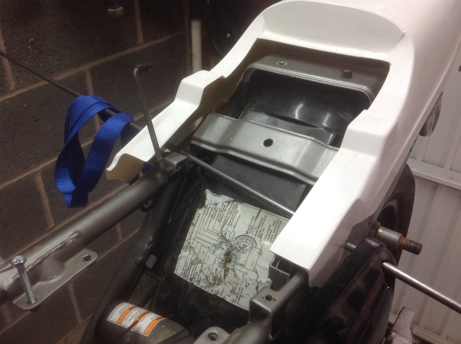

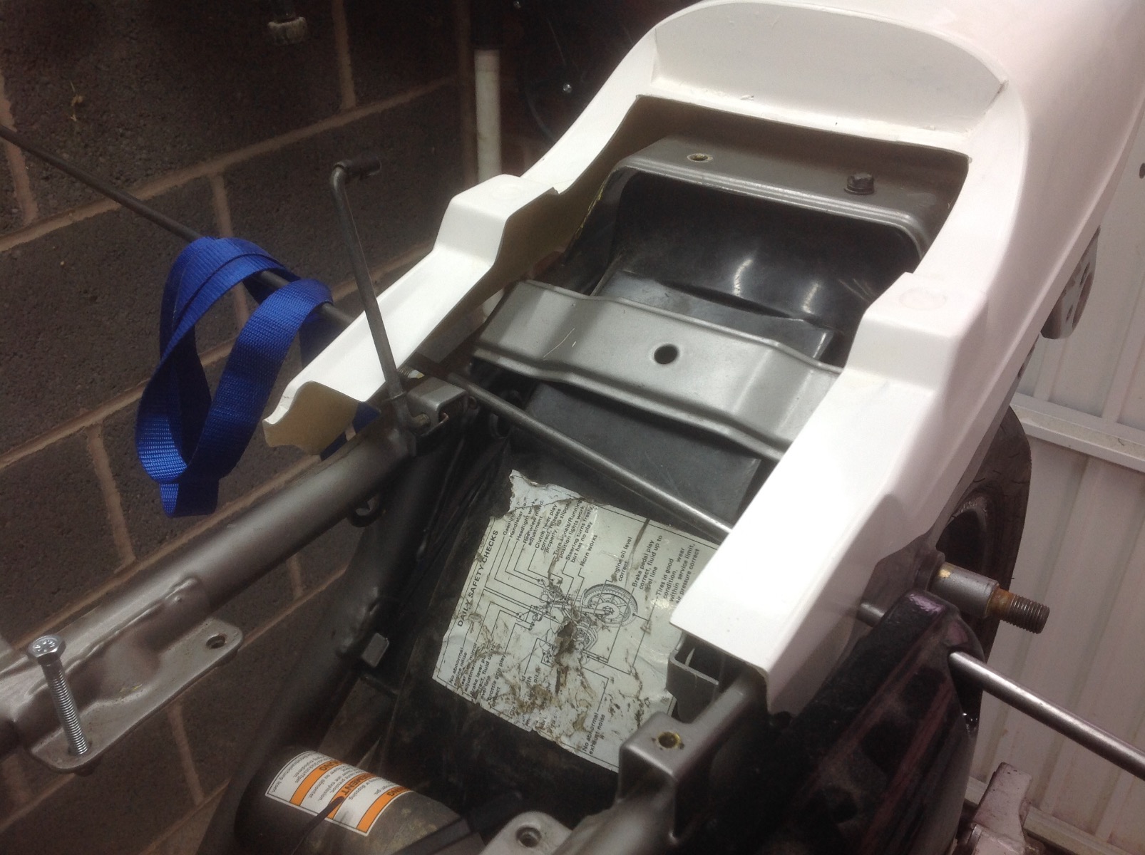

The vision: I decided to mock things up so I could share my vision (easily identified as a big Z but different to all the others) I am relocating the side panels which will mean extending and re-shaping them   I think to make random parts look like they belong together you need to look for some subconscious lines of symmetry (IMHO) so I am using the bottom line of the tank as my datum point, the top of the side panels will be parallel to the datum line from the bottom of the tank. I will probably need to re- work the tailpiece as well so the top line is parallel to the side panels and tank datum line. As a bonus the original splash guard still fits (will need a trim at the bottom) feeling good

Unloaded the J forks are 815mm and the  K are 840mm - The ZX9 forks are 755mm so with extension will be 830mm - the radius of the wheel is 31mm smaller so ultimately I should be 16mm lower than a J - I can do what I want with the rear as I haven’t made the mount yet and it will have a degree of adjustment- I need to watch the swing arm angle as Davido had an issue with his chain eating the swing arm

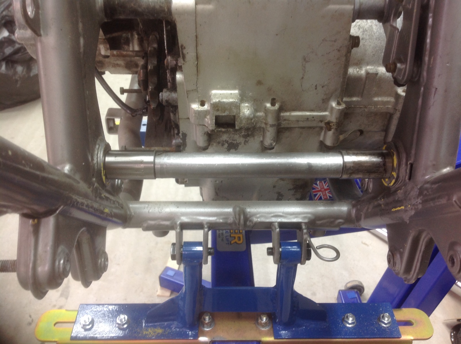

#868430
