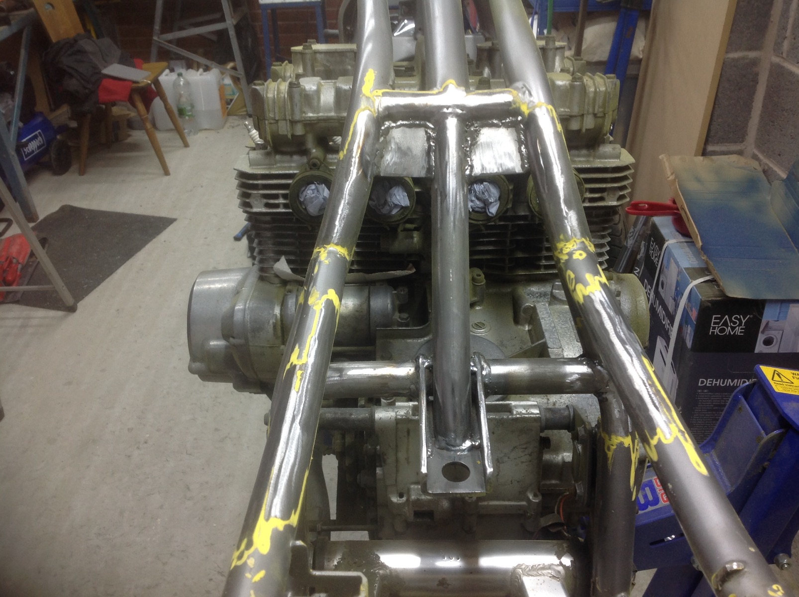

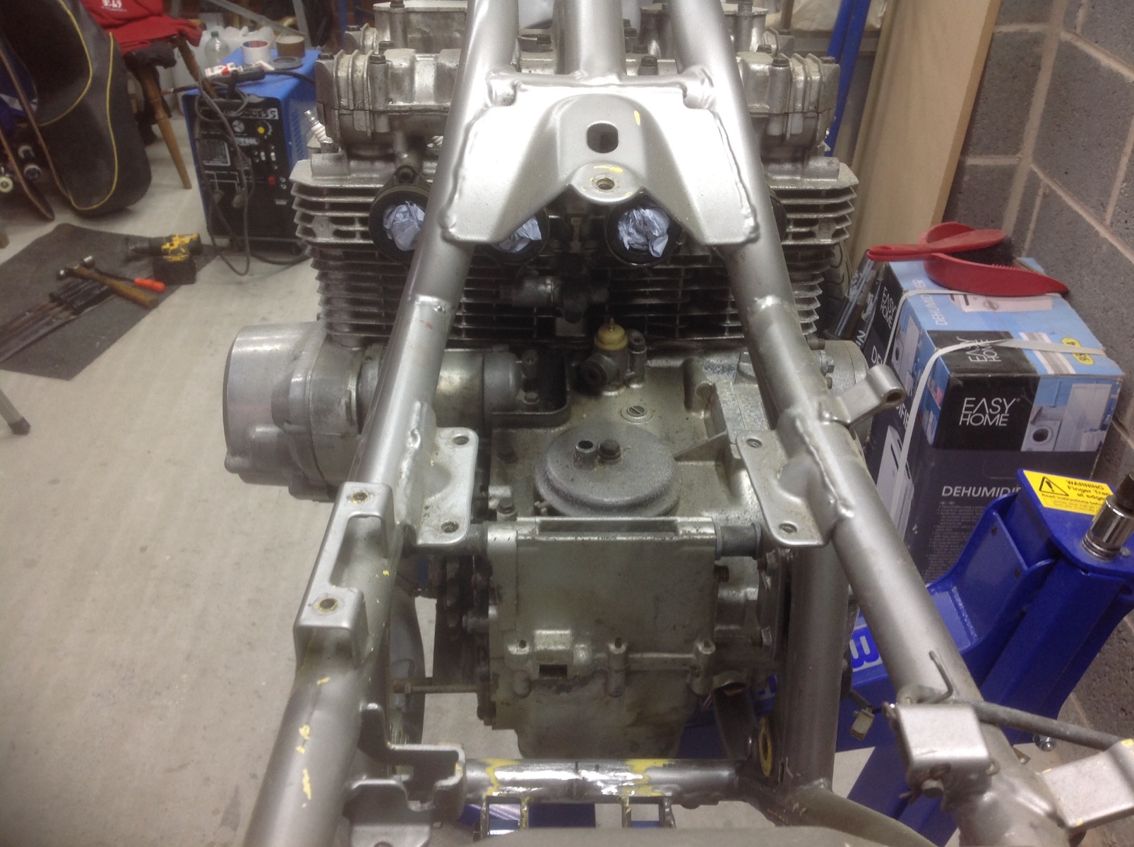

So today I have managed to get back on the build again. I have managed to get the top shock mount built for conversion. It may look a bit agricultural but with the length of the top mount being what it is to position the shock correctly I decided there would be a lot of torsional stress on the mounting point. With that in mind I have added a tube to transfer that stress into the backbone (I don't fancy the top mount letting go and the shock "hitting me in the nuts" just before the ensuing accident put's me in an ambulance)
Using the link provided by DoctoRot I have taken my measurements and am happy to report I appear to have got it right ( the below chart shows that it ramps up in the first half of the travel then goes linear for the second half) I have 125mm of wheel travel against 130mm quoted for a stock GSXR which is close enough for me and should ensure the conversion doesn't try and kill me I have added some before and after pic's (I know I need to clean up the welds, they are more functional than pretty )

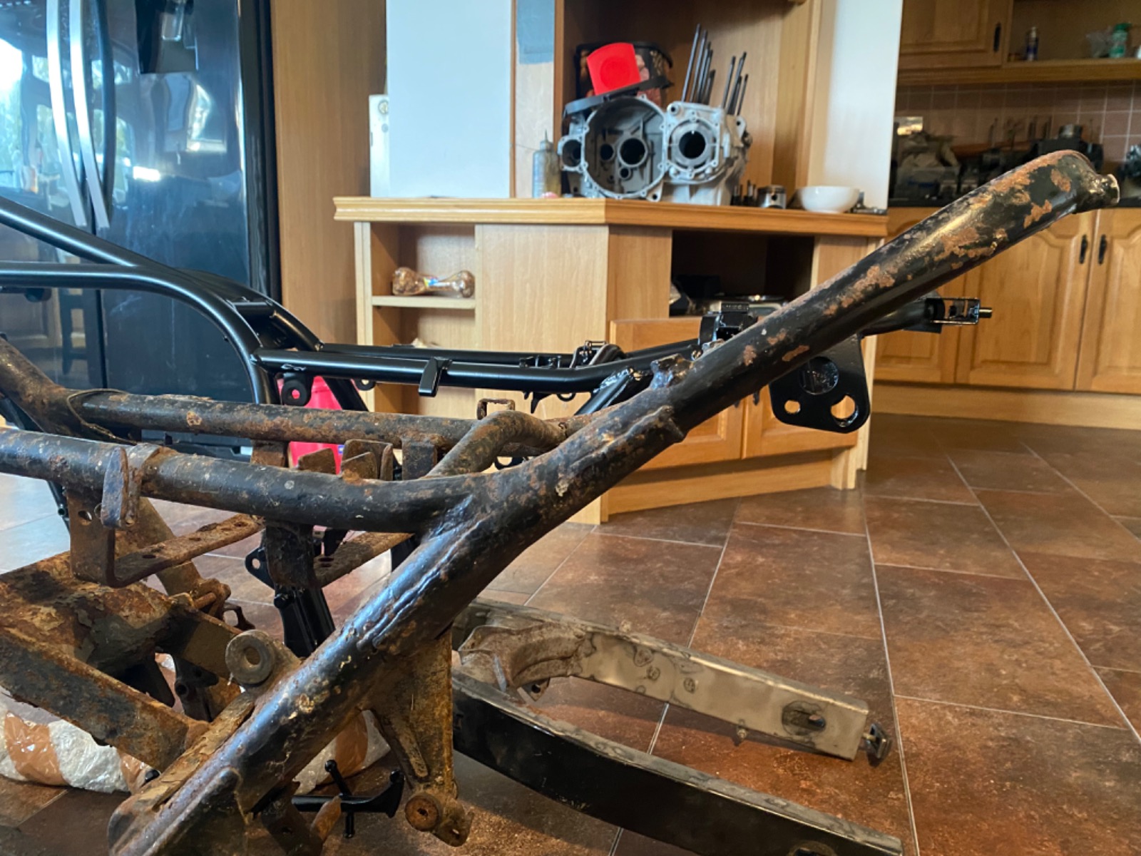

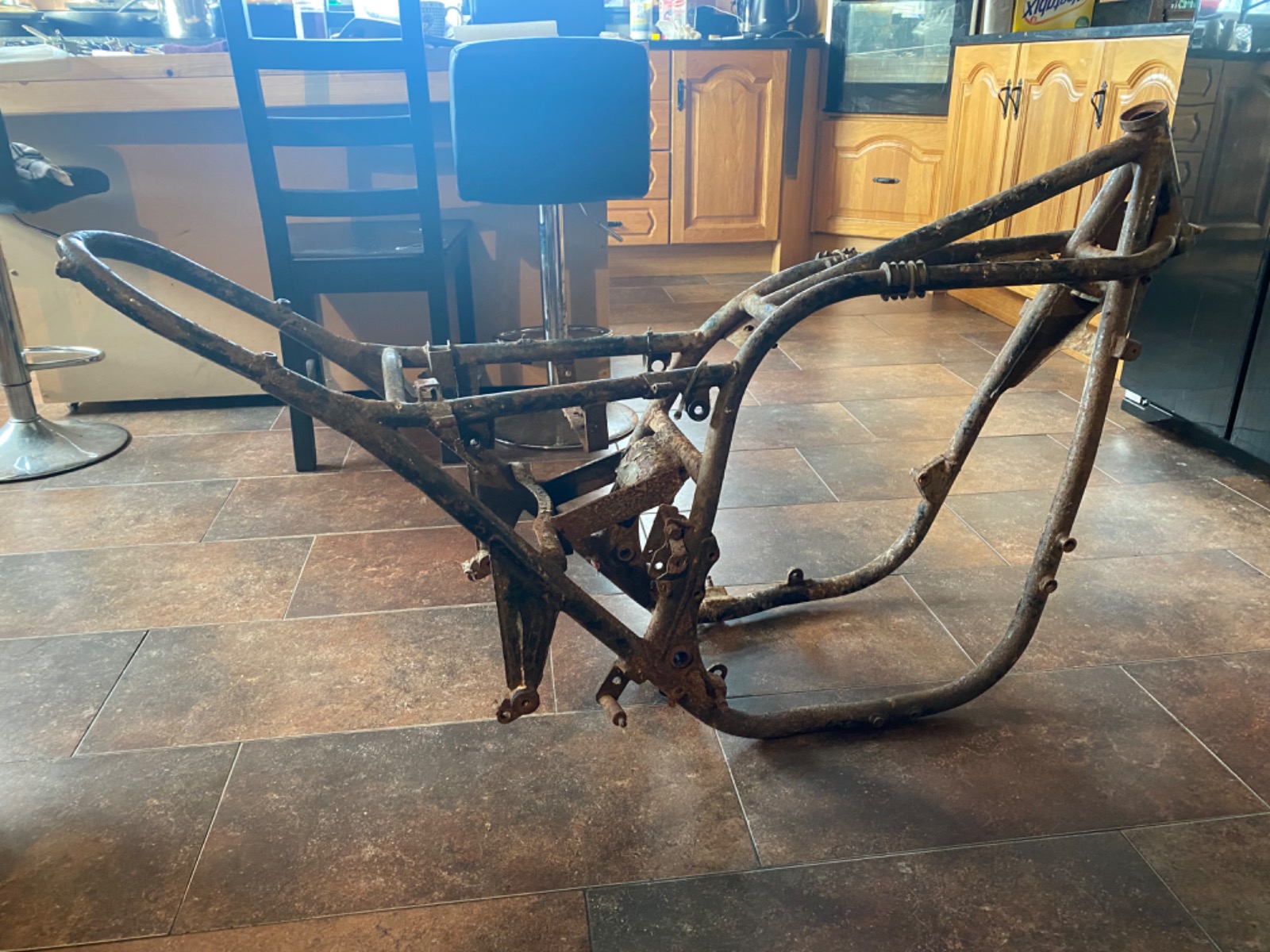

Managed to take advantage of the crappy weather today to make some noise without pissing the neighbours off completely (no BBQ's or garden party's going on
) I have finished cutting and grinding off all the bits I don't want so I now have a blank canvas to work from
PS: I got a surprise when the shock mounts came off- is this really how the factory built them back then (don't weld that they won't see it when the mount is on )
