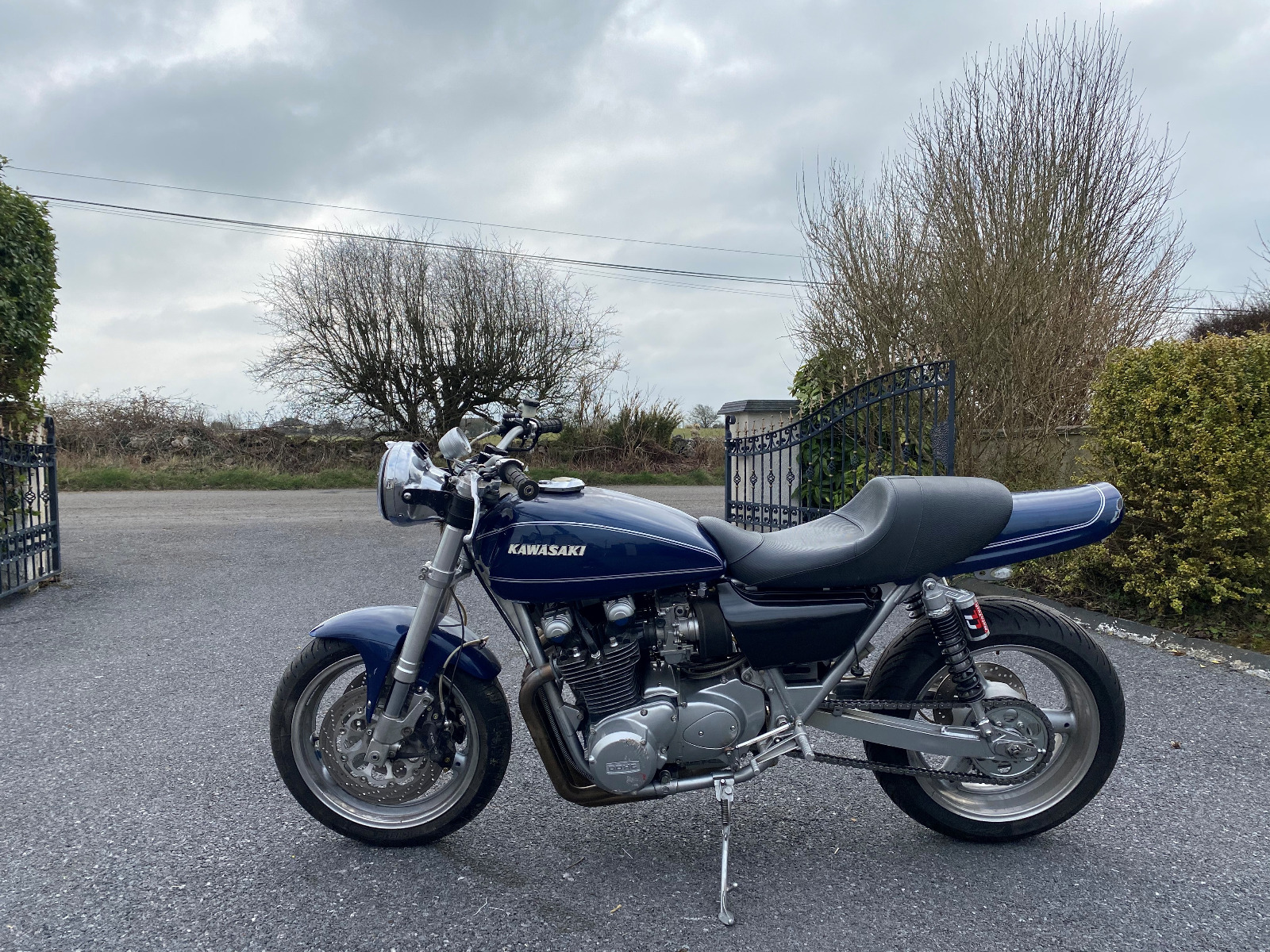

This will not be a full build. Im simply going to take over where Jon (Kaw-a-holic) the original builder left off and style it to the bike that i want from the ashes of the last. This bike has been reborn more than a few times now and its rebuild before this is one of KZRs best and its all here if you haven't had a chance to take a look.
www.kzrider.com/forum/11-projects/592092-phoenix-fighter

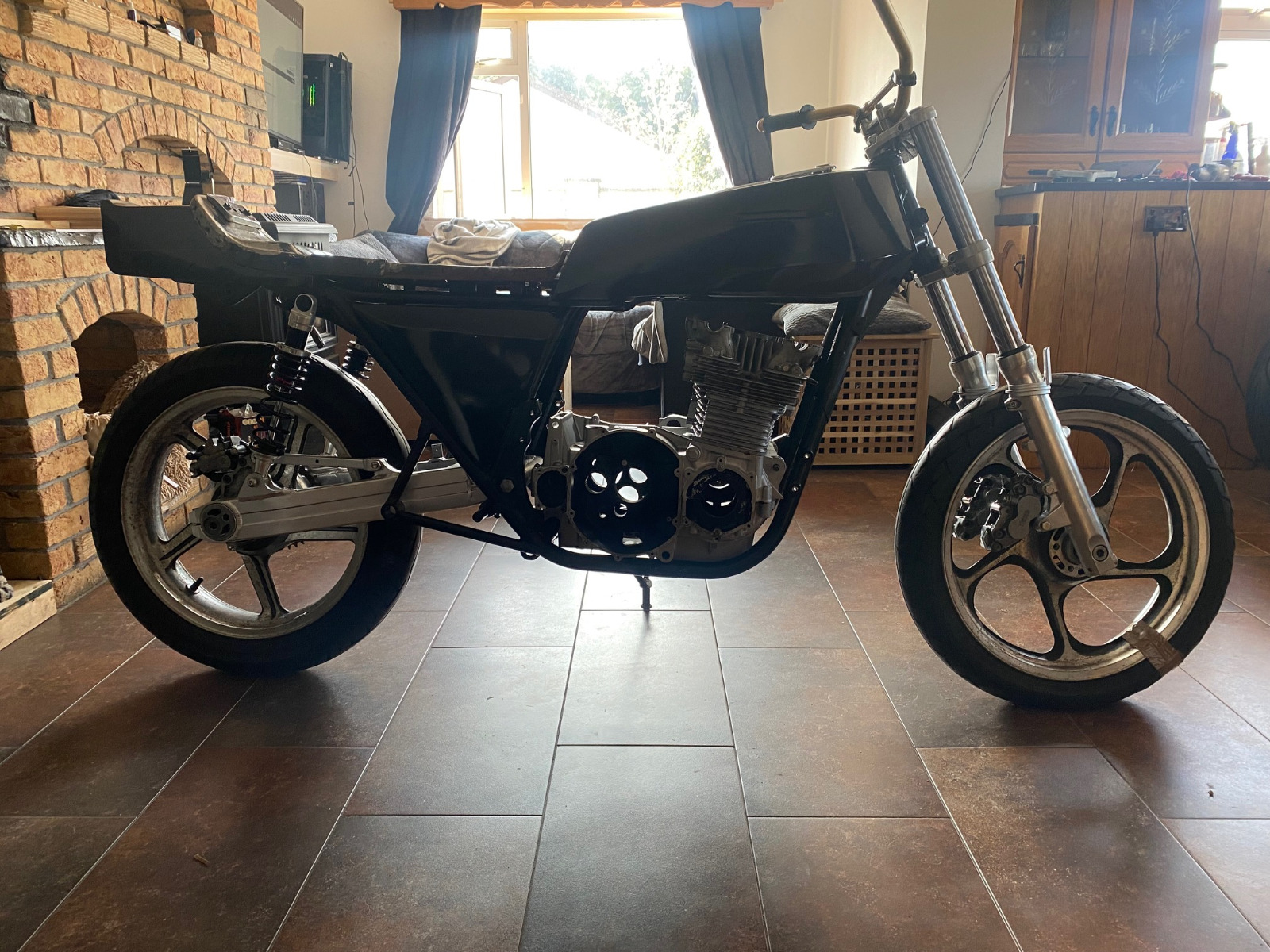

It was a real journey for both Jon and the bike and unfortunately ended in the bike being dropped and for personal reasons Jon need to sell it on. Well 5 months in covid times later it arrived in rainy Galway about a year ago. Iv been tipping away on her for the last year, in between other projects in my life and a full time job. I was going to do a full crank up build but i just want to have her on the road for this summer, if only for 1 summer before it goes back for a full rebuild. I don't want this to seem like in second guessing anything that Jon did, im just tailoring the bike to me and the roads that it will be riding on. Here she is as she landed in my back yard a year ago.

As I remember it Jon was looking at extenders or longer forks before he "high sided" trying to avoid hitting his buddy that stopped in front of him. Looks to me the front end is too low causing all the weight to be on the front tire in a panic stop.
- kzstreetfighter71
- Atlantic West Coast
- Posts: 821
- Thanks: 208
Re: Phoenix reborn.
28 Mar 2022 08:05
100% mate, with the exhaust that was fitted the ground clearance was under 10cm, im looking for the forks off a Gsxr1100 93/94 they are 775mm from top to axle or the same forks for the 95 on that are 765mm, both are hens teeth right now but im always looking, the 93/94 would be ideal. A fair few on the ebay but on close inspection they are from the 91/95 that is 730mm and thats whats on the bike right now.
Re: Phoenix reborn.
28 Mar 2022 10:00
The extenders would help slow the steering down and lowering the shocks could level out the bike closer to stock. Did he hit the collector?
- kzstreetfighter71
- Posts: 821
- Thanks: 208
Re: Phoenix reborn.
28 Mar 2022 11:11 - 28 Mar 2022 11:27
No thank the gods... its a beautiful exhaust...so its all good, not sure what the reason was the pre tension was dialled out a bit so maybe they bottomed out. It was at a low enough speed otherwise the damage to him and the bike would have been way worse. To be honest the front and back set up will be only for this year, ill swap it all for a different running gear in the winter, the exhaust ill be running will be a bit more forgiving than the one that was on it. I have 16cm of clearance now and the shocks preload is a lot more ridged.

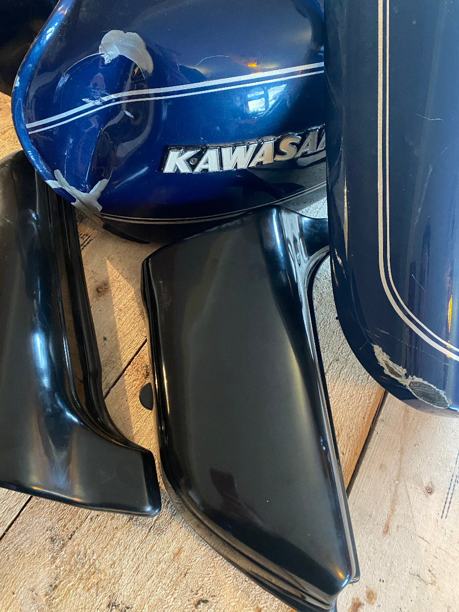

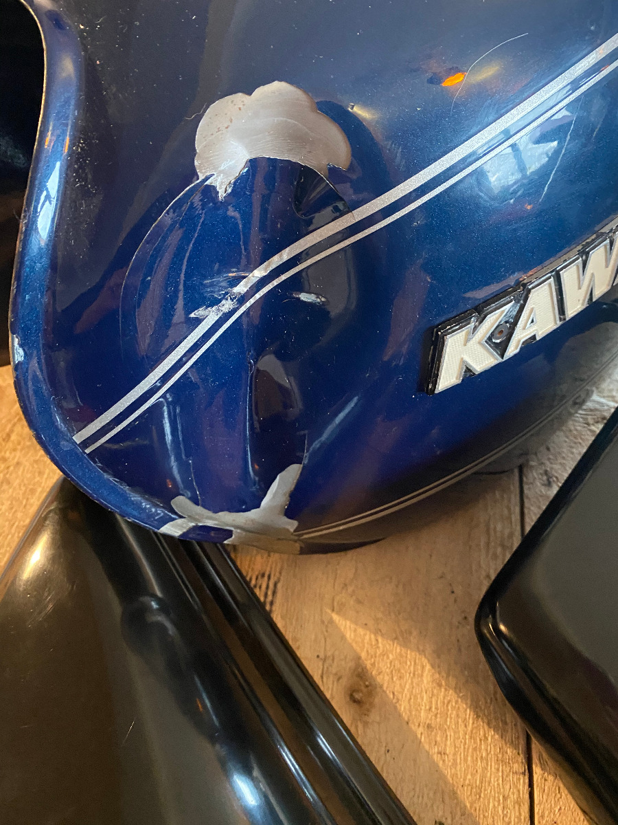

First thing that needed to be sorted was the body work. The tank and tail took a bang and Jon kept the side covers but i got aftermarket replacements, the one promise i made to Jon was that the bike stayed blue in some form or another.

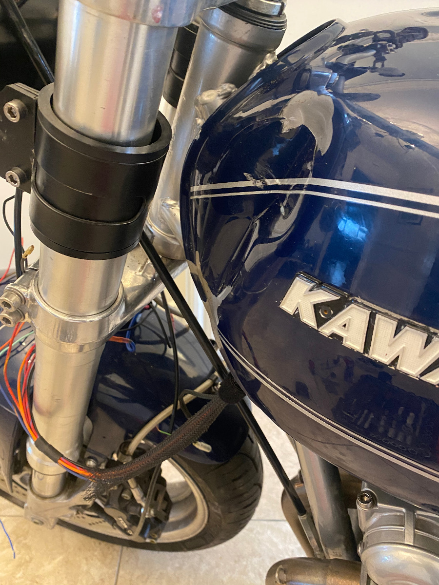

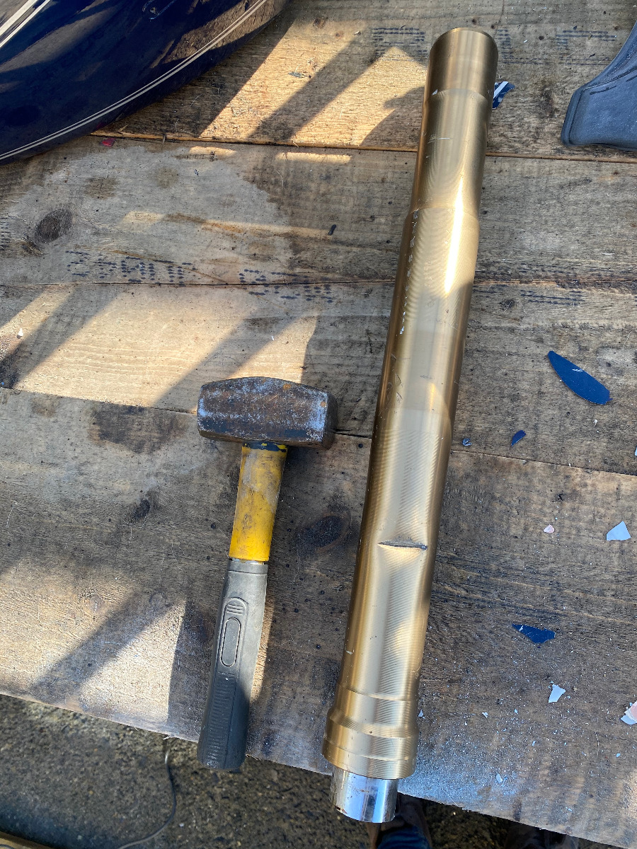

The dent in the tank was so pronounced that it was close to junked but since the bike has and most likely will have USD fork for quite a while i decided to run with the dent and dimple the tank to insure that i have better rotation of the steering. Before it was only a few degrees to the left and right to insure the forks didnt bang of the tank. So first ting i had to do was dent the other side, luck i had a junk USD fork leg as a "dimple tool"
2 stout slaps and we are close enough for the long job of filling and sanding.
