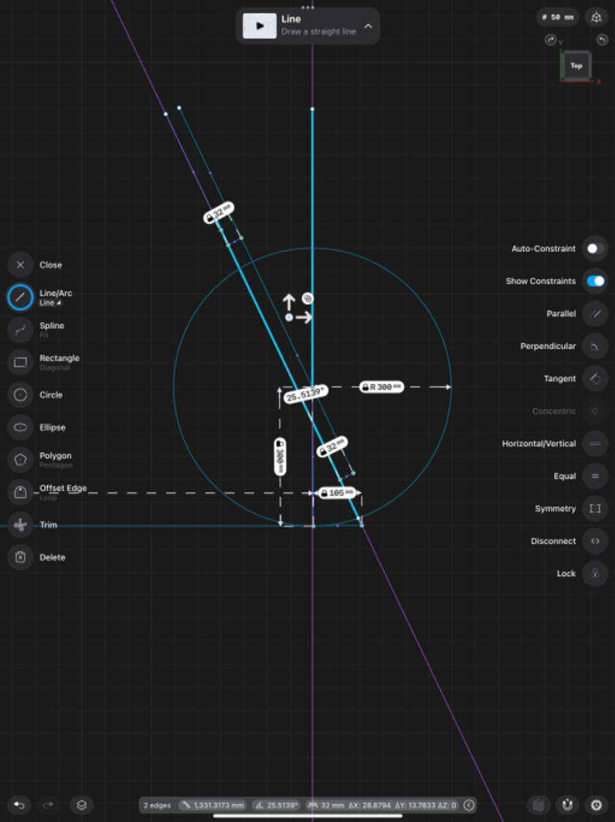

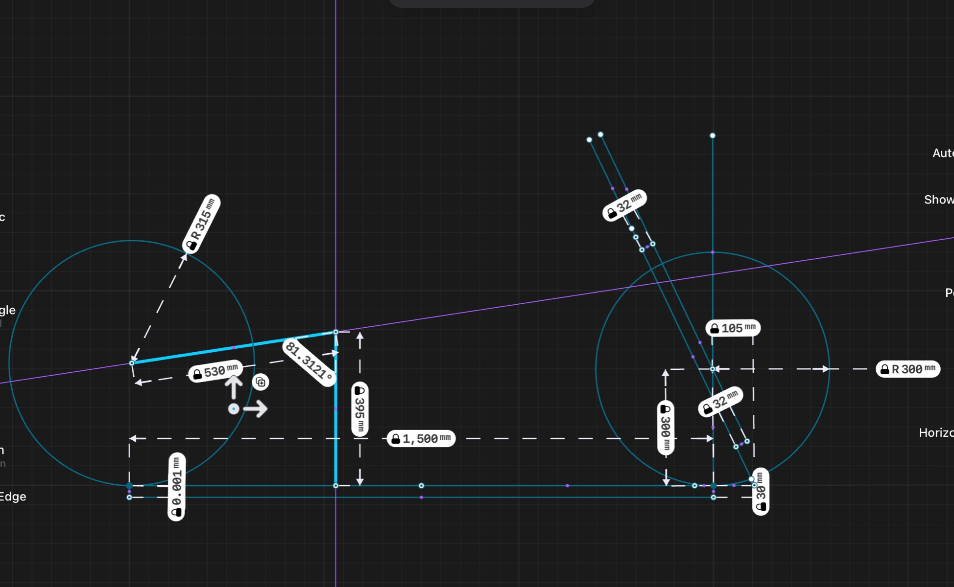

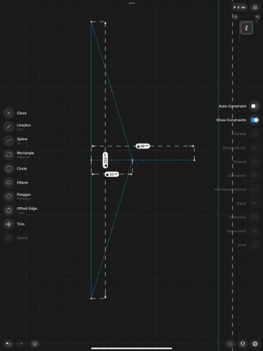

Ok.. I have another option on shocks, slightly longer, i will put those on later today, I’ll also remove a lot of things that might be throwing off accuracy in my measurements. I have a drawing of the top clamp too and I’ll put that up as well. I’ll see if I can find the most level section of my floor too. This all helps a lot lads thank you.

I don't think you need longer shocks, 365mm is already long enough, is there any height adjustment on your shocks ? I'm using the same length shocks and the same swingarm as you.
I'll drop a link below to AC sanctuary's page where they discus 17 and 18 inch setups on Z900 Kawasaki's. Use google translate to read, I have my computer set up to auto translate a number of different language sites. On the left the first 2 links under chassis are top 17 inch and next 18 inch, it discusses rake angle, fork length and swingarm length, its a bit jinglish but not hard to understand...
www.ac-sanctuary.co.jp/factory/chassis-dimension/

You might find this on-line calculator useful to decide on your set-up
nam12.safelinks.protection.outlook.com/?...Xt55dg%3D&reserved=0

Thanks Wookie, now that I have the proper measurements…( I was measuring the rake wrong) iv taken a look and I feel a little more comfortable with where I am now. Like I said before, I’m going to be changing the set up later this year, this is more about understanding the numbers and what to do if I want to change them. Well maybe being told by someone who knows a bit more than me telling me what’s best to do.
The offset is 32mm on the fork clamp.

When measuring trail run your line through the centre of the steering head, then centre of the axle to the ground, centre of the fork leg to the ground, measure the distance between the two lines where they meet the ground, as you have. You are going to need a digital angle metre to measure actual rake, and you can only do that once you have everything mocked up, they are cheap as chips on Aliexpress... The one in the link has a magnetic bottom, that's what you want... you put it on a 90degree surface {magnet side on surface} and zero it out, then put it on the front of your fork tube and see what it says... I still can't see a rake measurement in your diagrams.
www.aliexpress.com/item/1005003391546454...2.0.0.60d13787csdgiV
simplified trail calculator , I ran numbers through the calculator wookie put up, i have used it a lot but its a pain to convert everything to metric, the calculator below takes all ths measurements into account and gives the same results, just click on each box, change measurement and press enter...

Edit…Rake angle is 25.51 and trail is 105mm and trust me it accurate to well lets say a point or 2.
Link wont work, but i can go to the site and log in the numbers tomorrow.

31 Mar 2022 18:26 - 31 Mar 2022 18:30My last link is a downloadable xlsx file Excel}, I just clicked on it and it works for me.
What I'm saying about your rake measurement is that you need to measure it with all the parts, longer shocks and everything on the bike, I didn't know whether you'd done that already, and whether you'd settled on fork length..
The simple angle gauge makes it easy to read rake adjustments in real time, no calculations necessary, made it really easy for me as I could leave it attached to the front fork and adjust the rear ride height and see what change it had made to rake instantly. I'm moving my rear shock mounts so my setup was a bit more fiddly...
Here's a pic of the calculator with your numbers in it

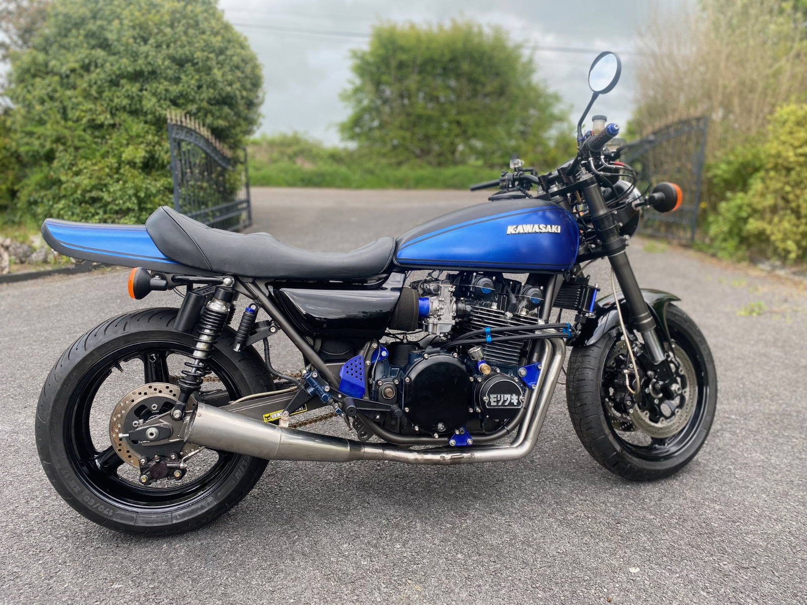

Re: Phoenix reborn.
10 May 2022 10:42

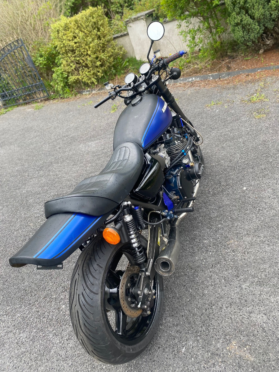

Been a while since iv updated, skipped ahead a fair bit, bike is about 15 hrs from running, going to be giving the tail and tank its clear coat tomorrow. There will be a bit of a tare down and ill snap all the changes iv made. the hydraulic clutch conversion is on and working so far but i need to do a few road tests before i pat myself on the back, here she is as she stands now.
