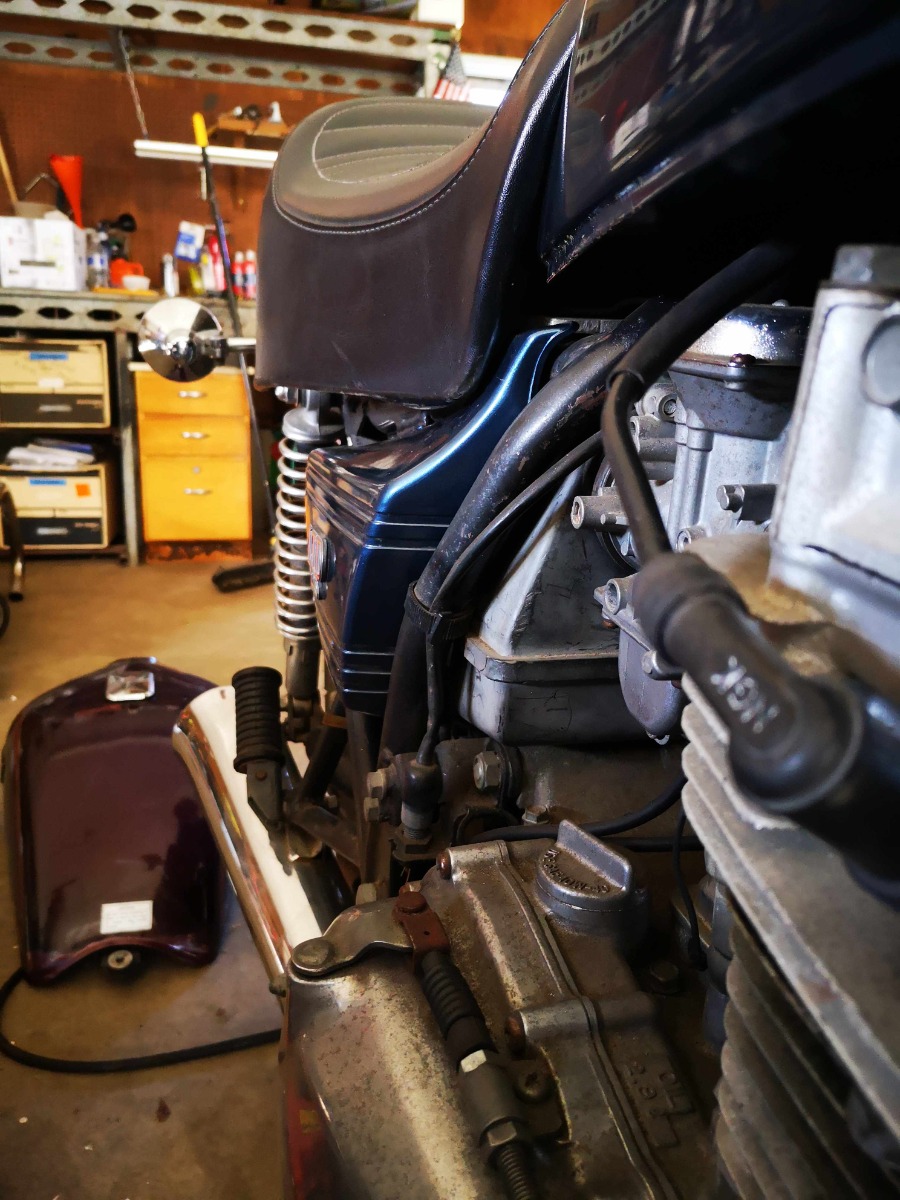

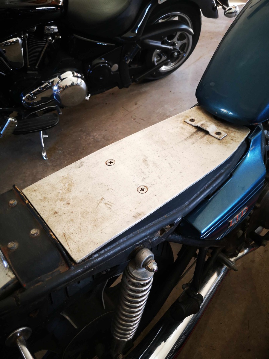

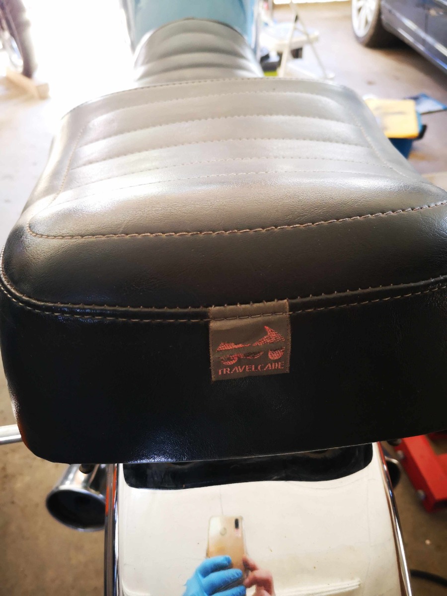

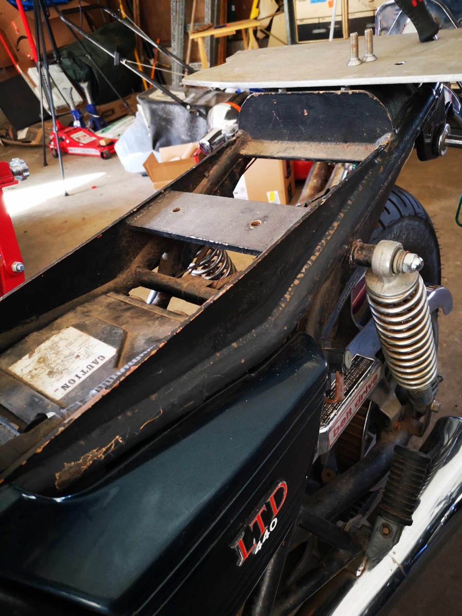

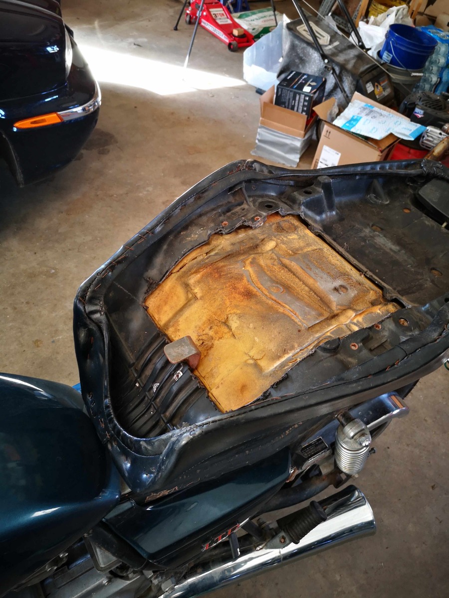

2. WTF is the deal with the seat ?
The whole bike looks very very bone stock, but then the seat is wrong and too wide and... underneath is a pretty intense welded platform that looks like it was intended for the cafe-racer flat seat conversion that was fashionable for a while but, oh well, anyway.
I mean, look at the pictures below.
The thing is, I really like the look of the 440 Ltd, and its seat is quite cool in a convoluted 1980s way. So. I need to find a seat, and I need to figure out how to re-install it to my frame...
Any thoughts ?

Your bike has been modified to fit the wrong seat, I'd chase a stock seat and cut all that non stock metal out....

Travelcade was once a popular and fairly expensive upgrade. It is sad that somebody butchered the bottom of it. Looks like you will be spending some quality time with a plasma cutter or cutoff wheel in an angle grinder.
