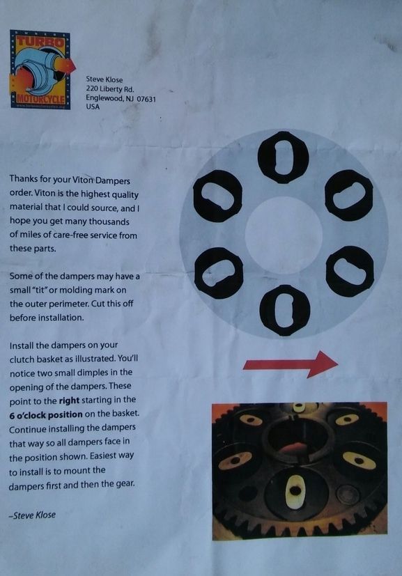

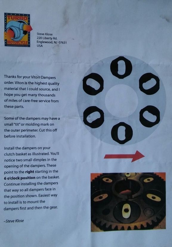

Next the clutch basket showed some back lash, due to wear in the rubber bushes inside the basket. The rivets holding on its back plate were drilled out to access these bushes. A mod will be done to eliminate the back lash, by inserting 1mm thick tubes into the holes in which the bushes sit, this will lightly squeeze the bushes and so remove their loose fit.

A better clutch fix is to replace the rubber bumpers. A guy on the KZ750 Turbo website sells them. You might want to check my rebuild thread, for more details on the mod.

Thanks for the info on the replacement clutch inserts, though my clutch basket is now repaired. Moving on to the electrics, with many changed components.. gauges, rear lamp, rectifier/regulator, switchgear and coils from a Honda Blackbird.. similar spec to Dyna coils. I decided to make my own wiring harness. I have used the M-Unit from Moto-Gadget before, but they are expensive, so I found another German company making a cheaper, simpler electronic control box, called the D-Box from Axel Joost. I'm in the middle of wiring up the bike now, using the D-Box and a new, modern Rectifier/regular in place of them separate OE components.
