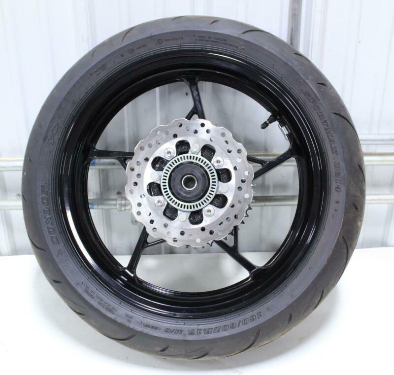

Gday mate, when looking for wheels for my 750R1 project I bought a Z1300 front and a Z1000p rear, I wanted 18's and apart from the rare 3 spoke GSXR1100J wheels the only others were Japanese and expensive. While checking different style wheels I came across the later model Z650, 2017/18/19 and discovered they were 3.5 inch front and 4.5 inch rear, I got lucky and got a set from the UK complete with discs and hubs for 100 UK pounds, they are basically 5 spoke wheels and so much lighter than the early 7 spoke wheels it blew me away. I'm using the 18's for now as I'd already bought tires but will be adapting the 17's soon. The rear has a 20mm axle so its only the chain line to work out, I'll be milling the rear hub and If that doesn't get me close enough I'll use an offset sprocket, there's plenty about, I've already found some for the 520 chain I'm using...
Just another option...

Yes I was looking for lighter wheels but also a set that had a 4.5 inch rear, the 4.5 inch wheel is a bit easier to make fit and still look good on the early bikes with a 150 or 160 tire, depending on clearance... Yes, I got a very good price on the wheels, plus 90 UK pounds to ship to Australia..
