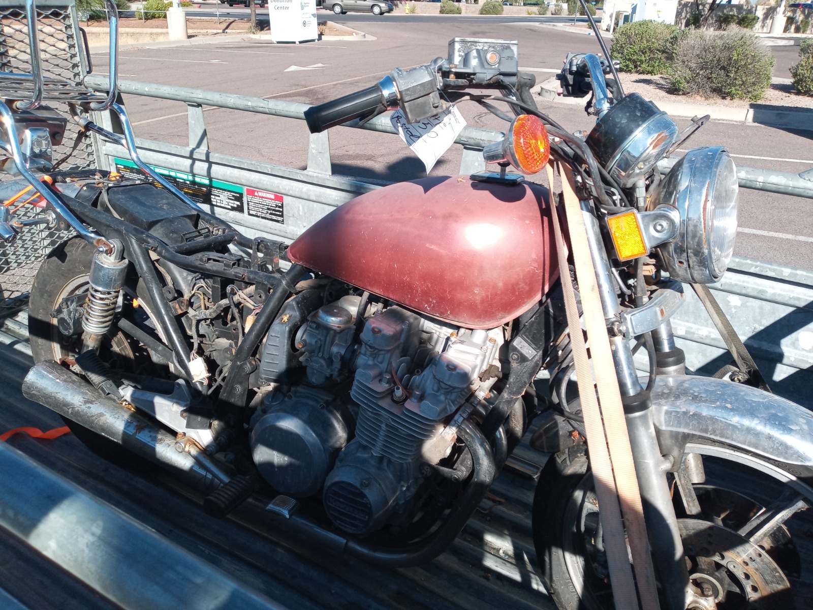

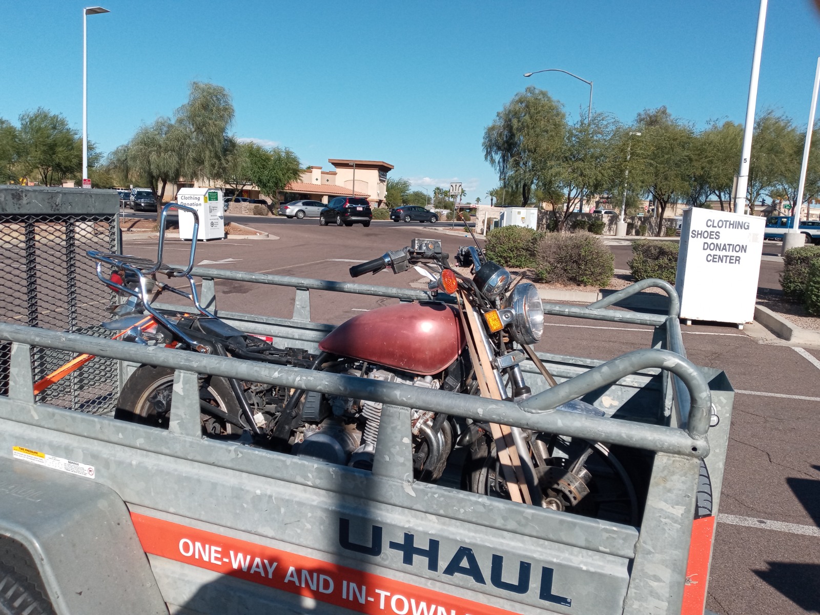

I made the mistake of looking around ......Ummmm......I was looking around FB Marketplace in Vehicals- Motorcycles and there was this mostly complete looking LTD or CSR. Missing a seat and not by much else by it's picture. It is Mesa and the wife's son and his family lives up there and we were planning a trip there anyway and I slipped out of the group to check out the bike. It was originally listed at $500 down to $350. I offered $325 and the took it. I found a oilpan witth the oilcooler attached and snagged that for $25.I should have took pics but didn't In the morning I head back to Mesa and pick up a trailer and then the bike itself. I'll try to take some pics of the KZ 750 and it's loading. When I got a look at her she is missing a starter motor and the rear brake caliper along with the seat.The last title (yes it has one) was issued in '08. I do not recall seeing a tag so who knows how long it's been off the road..She will need a total rebuild. Outside, no dents/dings observed on the tank. Exhaust looked shiny and solid. Rear fender needs replacement but, I may have one in the parts stash. I know the stash has a starter and the 750 GPz is going to give up the ZR7 starter clutch that is in her or search ebay for one. Wiring looked surprisingly good for it's age. Some of the signal lenses will have to be replaced. Normal stuff. I'll be posting more as it happens. Untill tomorrow...

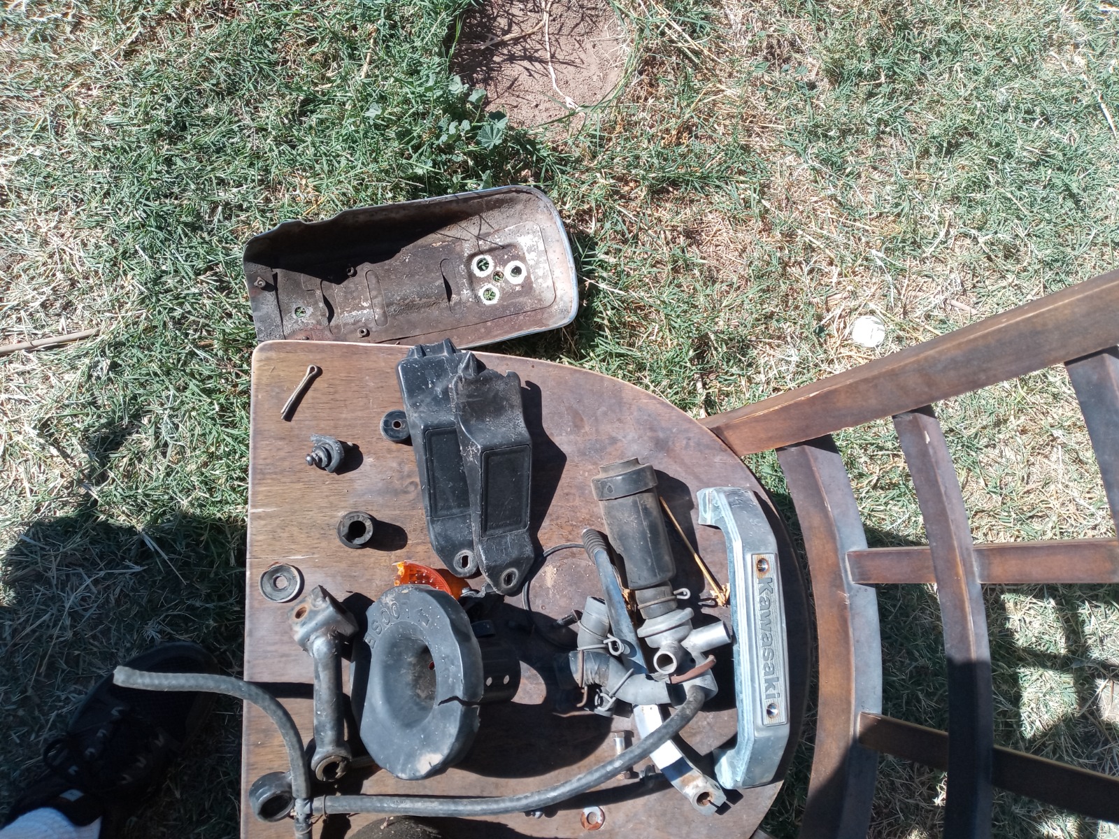

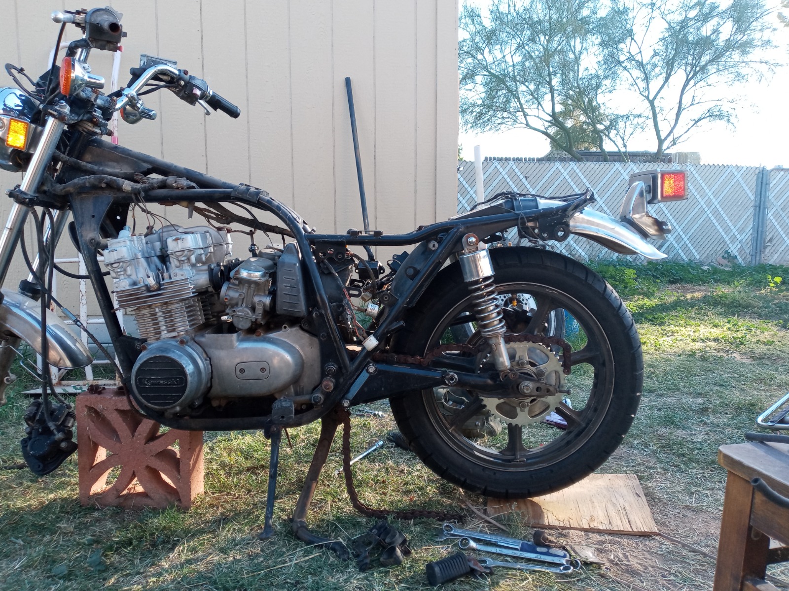

Well the day was warm and clear and nothing planned. Sounded like a perfect day for wrenching. Out comes the sockets and ratchets and the wrenches. The origninal project (KZ/GPz hybrid) got new tires last January, so the plan was to use them on this 750H. Yes the rear tire is a 16" on the H and 18" on the Hybrid. I measured and there is a 2 inch difference in height. I figure the taller wheel might make the H a better highway bike. I'll see when she is on the road. I got the rear tire installed with no problem. Used the same spacers. It was a direct bolt in. Last night I swapped in the rear fender from the parts frame(a '81 650 H). Another direct bolt in. Preety much the 650 H got spoked wheels and rear drum and 1 front disc. The 750 got triple discs and mag wheels.I don't know about the dash or electrics/electronics, but I susplect they would be very similar.Oh yeah the tanks are the same.How about some pics? The pic of the broken parts are of the removed parts that are not going back on. So far all the hardware had given me no problems during removal.

How is the frame?

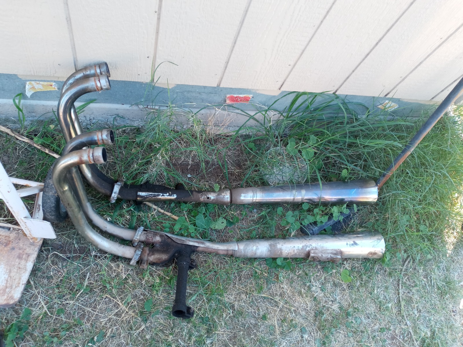

Seems in good shape. No dents. Even the exhaust pipes are in good shape for being almost 40. I'm not too worried about rust as we are in southern Arizona. I should still look it over though. Thanks for the reminder.
The only history I know of on this machine is it was bought by the shop for partlng out in 2008. Coils and rear master cylinder and clutch and front brake levers were missing and the rear fender was minor dented. Starter is missing too.Other than things being dried out the bike is in fine shape and under my care, getting better. Today the swingarm bearings got lubbed, wheel bearings on the rear wheel got new grease.I think I found the source of a clunking sound, maybe. The chain was missing an outer plate at the masterlink! The engine is in gear and I haven't been able to fine nuetral.
