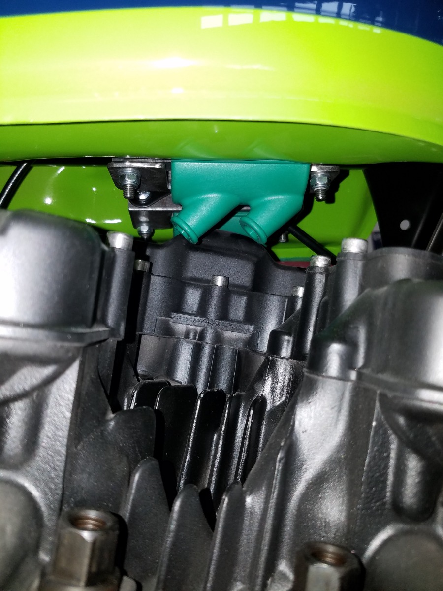

Here is how I mounted my Dyna coils to my '81 KZ50. I used some 1/8" thick steel angle and cut a notch to clear the coil.

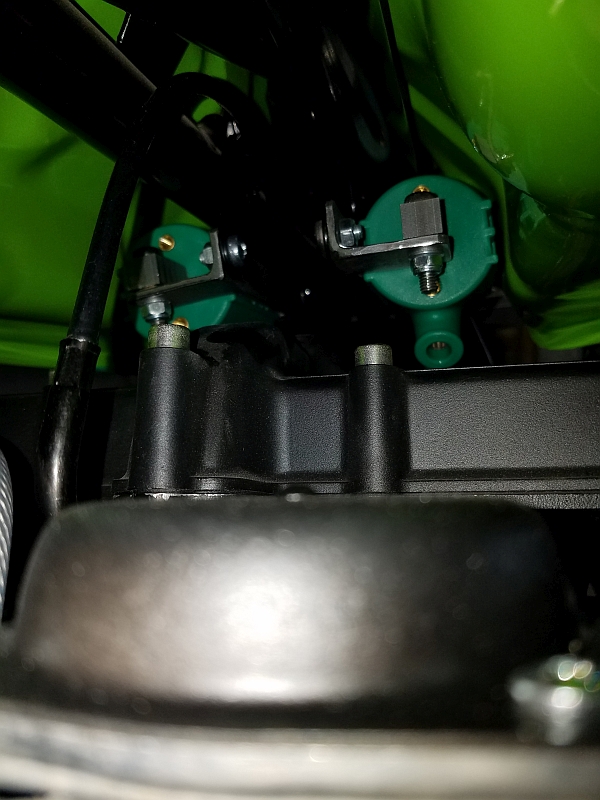

I made coil brackets from 1-1/2 angled aluminum. pic is a rough prototype. holes offset for the coils.
