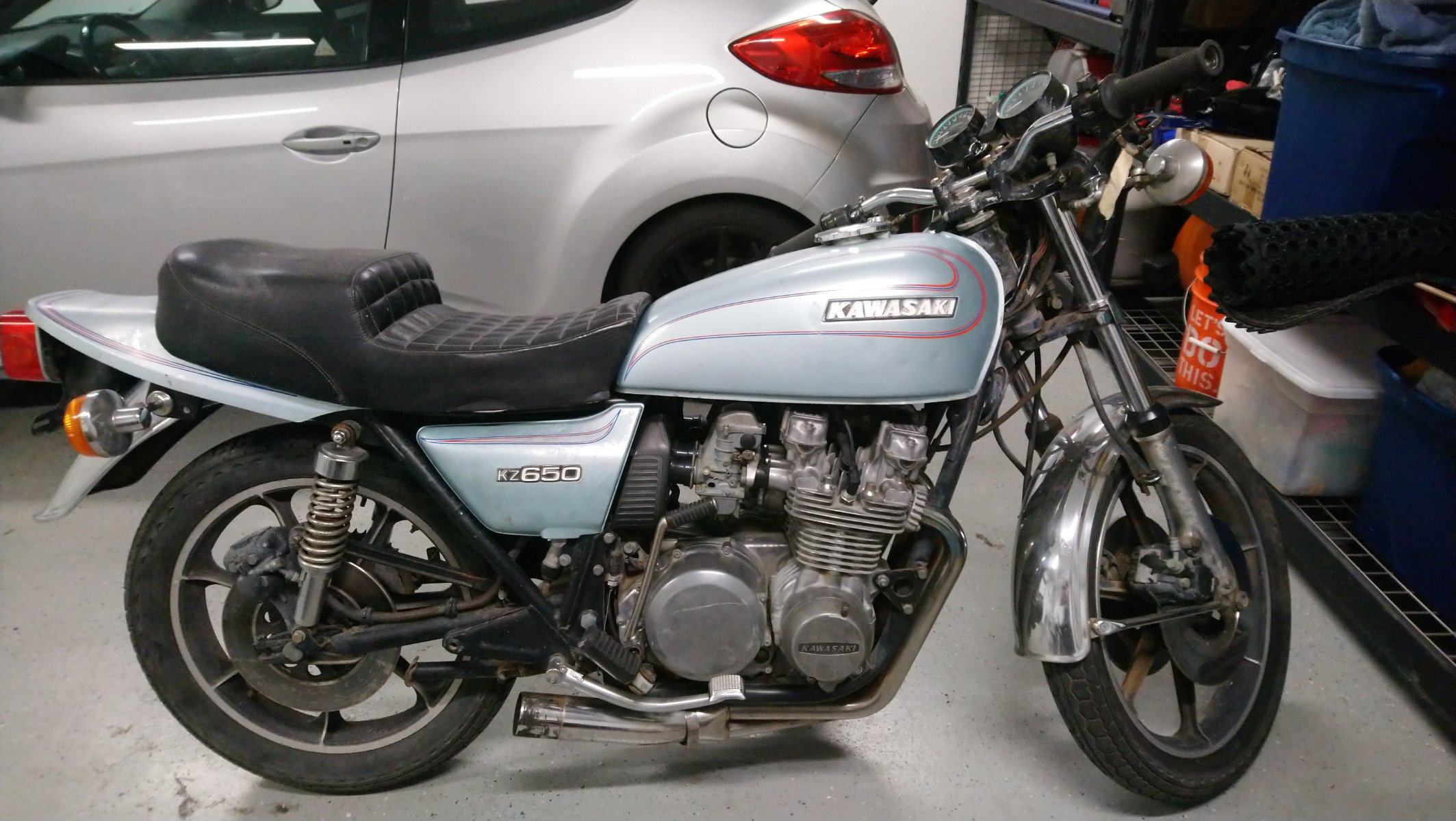

Here's the bike with the cleaned up carbs and some grips on it, looking a bit more together than before.

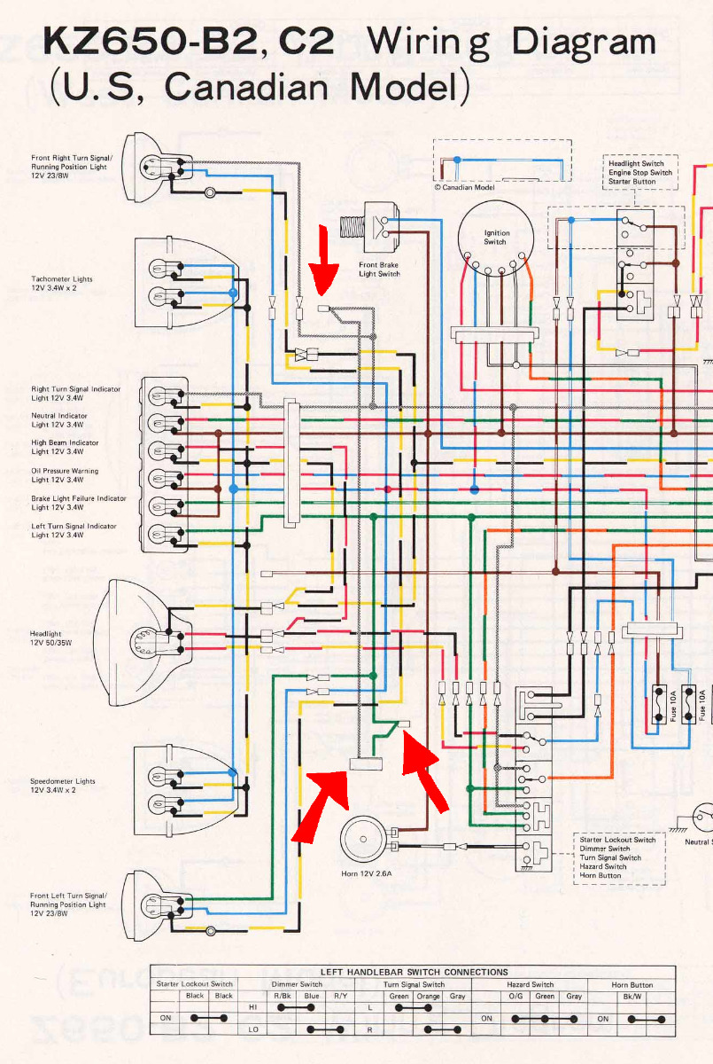

I sat down with the wiring diagram, and I found a spot where it looks like someone tried to be clever and modify the harness at some point... but did it wrong. There's a female end of a plug in a spot where there shouldn't be, and nothing to connect it to. Looks like redoing the wiring is going to be in my future.
So, an elementary question: what kind of wire do I need? I've searched before, and the answer eludes me.
edit:
Well... maybe not. I looked at the color wiring diagram instead of the one in my service manual, and I found the suspicious pieces. Why are these here? Especially the grey/green plug?
Though I am definitely missing the lockout switch on the clutch,and I am guessing the inside of that control may be a mess as a result. I'll try to take it apart soon.

11 May 2021 03:50Looks like an optional connector/connections for a turn light beeper.Well... maybe not. I looked at the color wiring diagram instead of the one in my service manual, and I found the suspicious pieces. Why are these here? Especially the grey/green plug?

Those are for optional factory light accessories that came with the factory optional windjammer fairing - they are vesitgial in your case.
Most of the circuits here will be OK with 18ga wire. however certain circuits like 12V+ from battery to key switch will need to be 14ga - if your harness is intact just replace what you need to with the same gauge wire or thicker. I recommend using OEM style 4mm bullet connectors however generic 4mm bullets that you can get at most auto parts store will work as well. you will need the appropriate crimp tool as well - vintageconnections.com/Products/Terminals
