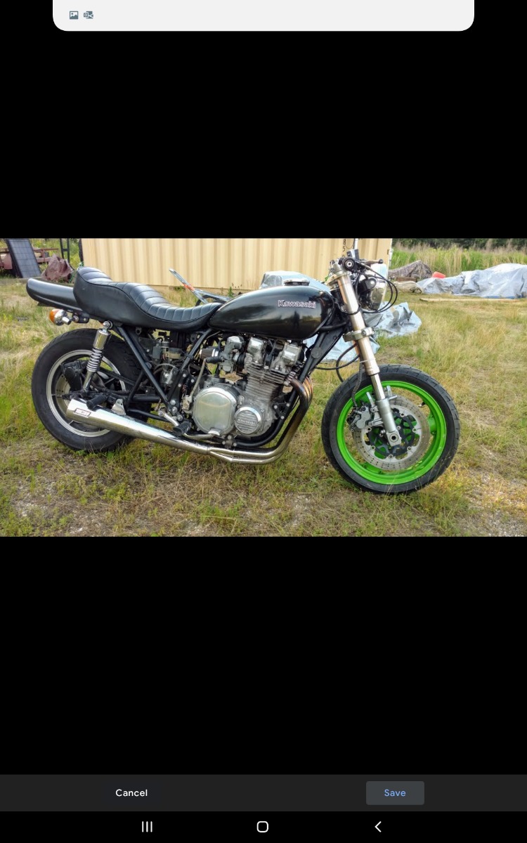

The bike...before heading to the builder
