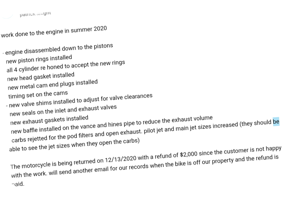

1. Engine disassemble down the pistons. CYLINDER HEAD AND CYLINDER REMOVED AFTER EXHAUST, CARBURETORS AND FUEL TANK. TOP END KIT ABOUT $90
2.New piston rings installed. $30 A PIECE SO ABOUT $120 IN PARTS. NEED TO SIZE AFTER HONING
3. All four cylinders honed to accept new rings.$70 FOR A HONE AND $15 FOR THE OIL
4.New head gasket installed. COMES WITH THE UPPER END KIT
5.New metal Cam end plugs and installed. $30
6. Timing set on the cams. ??? DID HE SPLIT THE CASES OR USE A CAM CHAIN BREAKER?WHAT DOES HE MEAN BY TIMIMG SET? DID HE SET THE VALVE TIMING AS PART OF REASSEMBLY OR REPLACE THE GEARS AND CHAIN?
7.New valve shims installed to adjust clearance.$100
8.The seals on the inlet and exhaust valves. COMES IN TOP END KIT
9.New exhaust gaskets installed. COMES IN TOP END KIT
10.New baffled installed in exhaust pipe.DID NOT PRICE IT
11.Carbs rejected for pod filters and open exhaust. $250 MAX FOR JETTING AND REBUILD
This is the price for parts only. No labor.

14 Dec 2020 15:57 - 14 Dec 2020 20:48H1Vindicator wrote: Is there a reason for doing this project? seems kinda strange to me. especially lacking any mechanical skills or a place to work. to each his own I suppose.
Minor problems. Most items are bolt on. Just place the timing mark on the 1-4 mark before disassembly and reassembly. Use a torque wrench( I have 3 different sizes for my bikes) and feeler gauges . If he watches the videos and has a service manual, plus a haynes or clymer manual(the factory manual has confused a few people ), the rest is just how bad he wants to do it and time. Piston ring compressors can be bought or made and the same with valve spring compressors.

14 Dec 2020 18:44 - 14 Dec 2020 18:45Installed new baffle then rejetted for open exhaust? lol
IMO, if you own a vintage bike, even more a customized one, you NEED to be able to wrench on it or have deep pockets.

Honestly, based on the way I read you issues, it sounds to me like your carbs were just jetted incorrectly.
