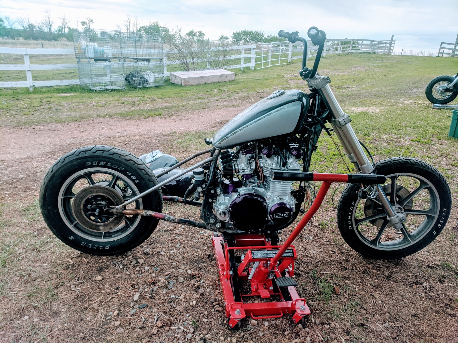

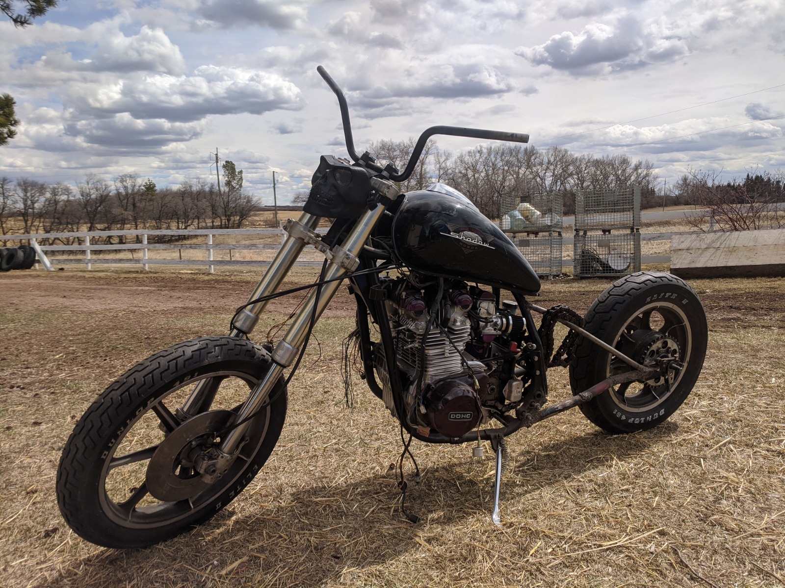

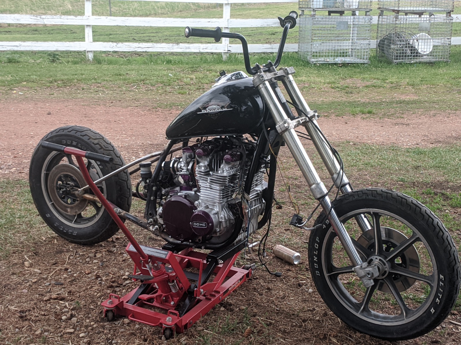

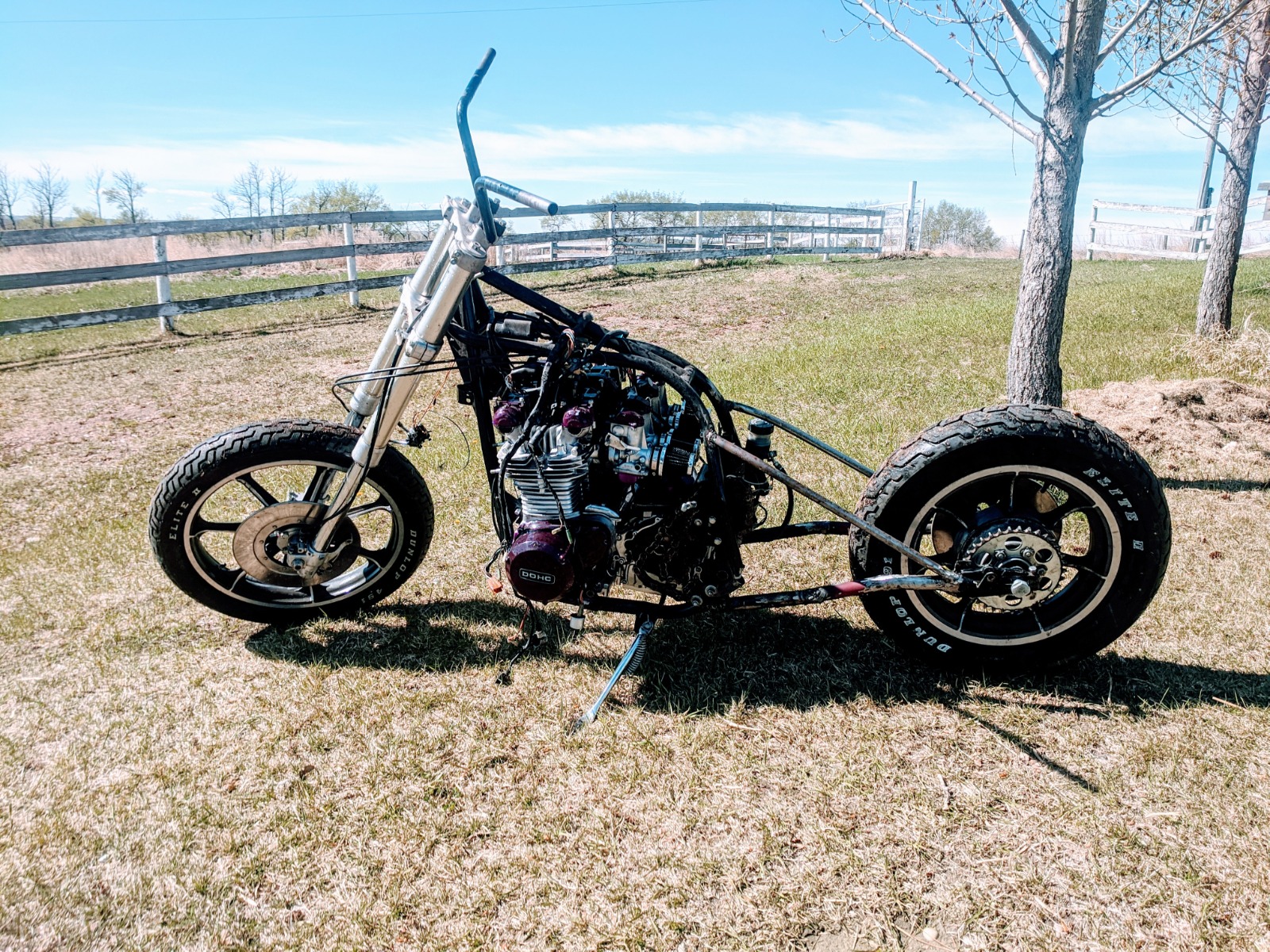

Hey so I'm new here and I just wanted to show off this project I'm working on . So I have a feb/77 made kz1000 which is actually coincidentally the same month and year I was myself born haha. I have stretched out the rear end and hardtailed it. I did the fab and welding ect myself. I put a set of Honda cr500 forks on the front and I think it looks pretty mean. The tank is off a early 80s Honda or maybe even a 70s not too sure. The handle bars came off a Yamaha quad and I am going to add a suicide shift to it yet. This bike is all me and I started with a near mint kz with 12000 miles on it and I have created a monster. I will update the project I have many tricked out things I'm gonna do. I'd like to hear your comments and remarks. Thanks all

Since you asked, I think it borders on criminal to do that to a "near mint" KZ.
That aside, I have some concerns. The struts look smaller (weaker) than the other frame tubes, and the bend in them will encourage flex, which will put added strain on he welds. A cross brace or two might help. At the axle end, the struts end well before the axle, which creates a lever that will put tremendous stress on the welded joint where the upper and lower tubes converge. I think the upper tubes should extend to as close to the axle as possible.
The lower tubes that replace the swingarm look pieced together, which makes me wonder about their strength.
Did you use some sort of jig to insure that the rear wheel is centered with the frame and front wheel, and is perfectly verticle and pointed exactly straight ahead?
The early KZ 1000 frames flexed a good bit at the steering head. I suspect these modifications are going to exacerbate that problem. Kawasaki redesigned that part of the frame in 1981, especially on the police bikes. You may want to mimick what the company did.
I hope you are a wiring wizard. Cutting off all those connectors will make identifying circuits even more challenging.
It is your bike and you will do it your way, but you did ask for comments.

AS you can see our group when asked will share their opinions .
Im sure you love your creation , but reality is few will share your taste.
Other than killing the bikes value for resale at some point the historic
pattern on chopper style bike projects is they never get finished ( Maybe 10 percent do ).
Now forget the differences in personal taste , The bike as built is not safe to ride at any speed.
Nice try , but frame work is not done properly and will bite you.
By now you are probably mad at me and the others who responded but we speak from experience.
Start over , or just get a stock frame and put it back as it was .

OMGosh, what a monster. If the condition of the engine speaks to the original condition of the NEAR mint bike you started with then I’m aww struck that this creation has become what was a very nice ‘77 B1.. I’m gonna keep the rest of my comments in my pocket. I two want to caution you on actually riding it in it’s current state. ITS NOT SAFE. I have a ‘77 frame if you’d like to start over.
We are not making any personal attacks on your creativity or your vision but more the bike of choice. Slmjim captured it best. You would have been further ahead to have sold the near mint 1000 and used that money towards something more roached out as a basis for your build.
