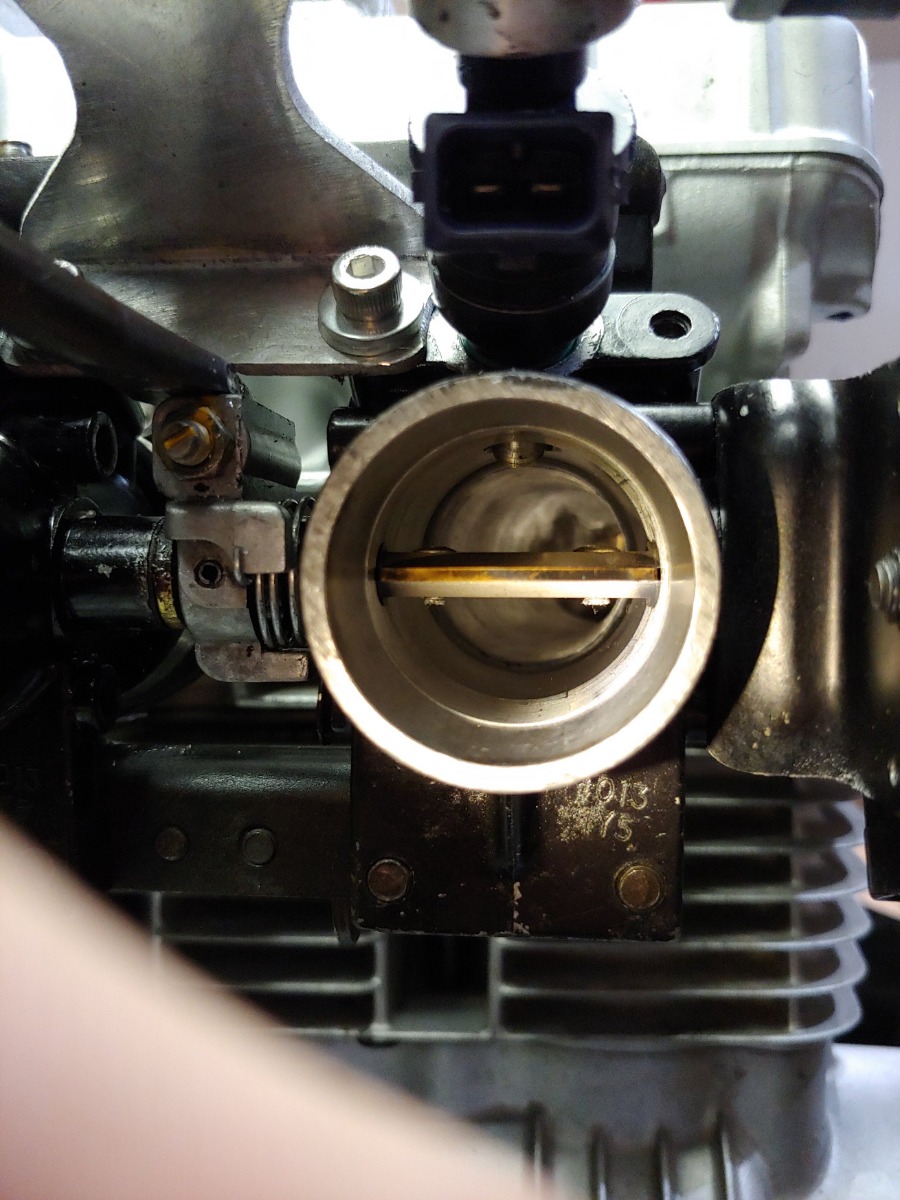

Stock ports:
Current ports:

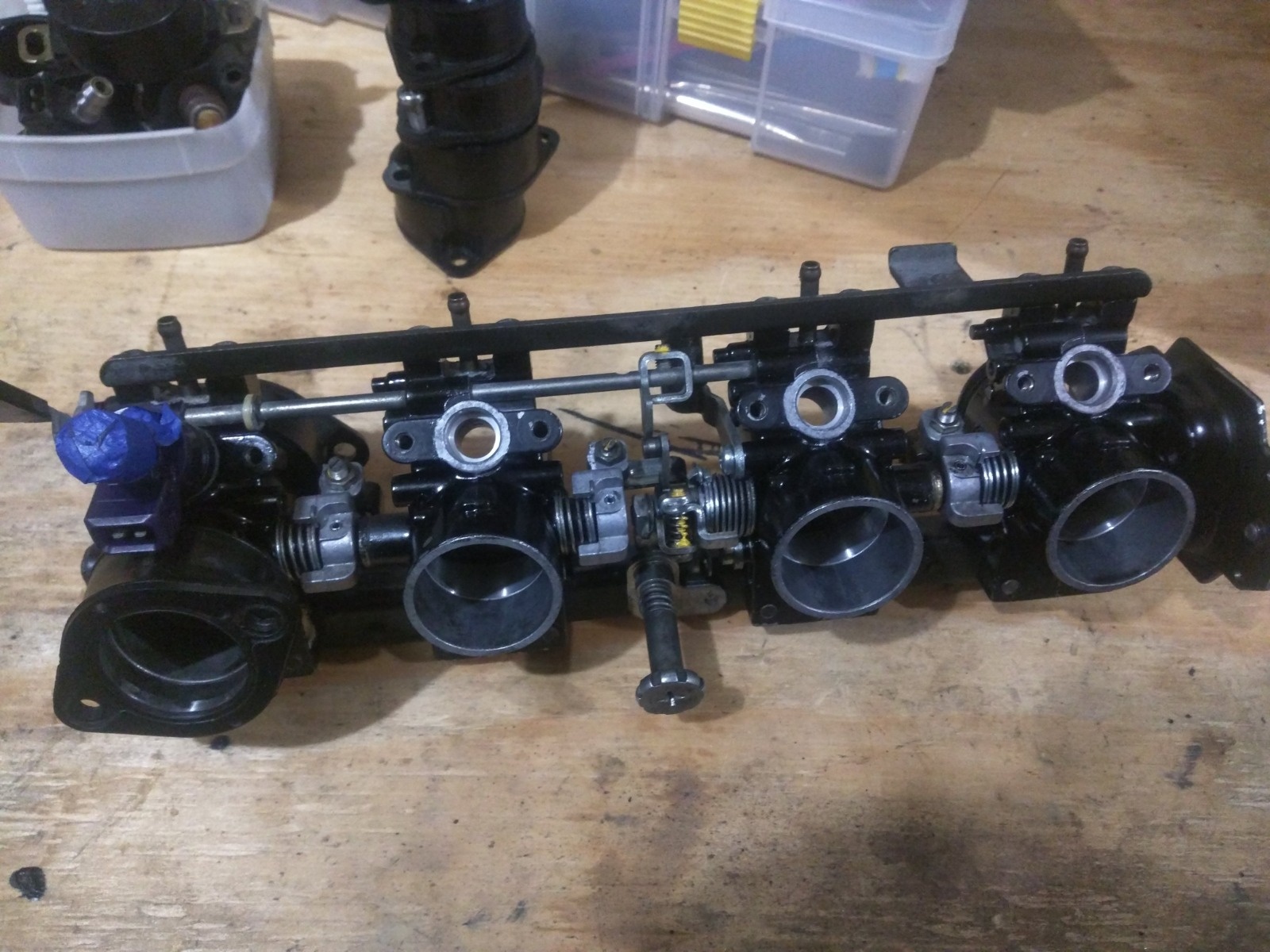

TB rack:
Side profile of rack w/ injector
Nozzle end of injector
Modifying the TB rack shaft for the mikuni TPS. Not a direct fit on the shaft as the 750turbo forum said.

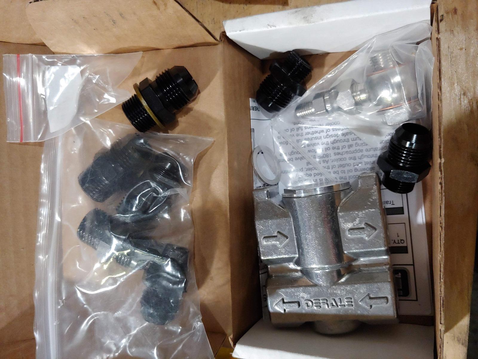

Oil cooler and turbo fittings

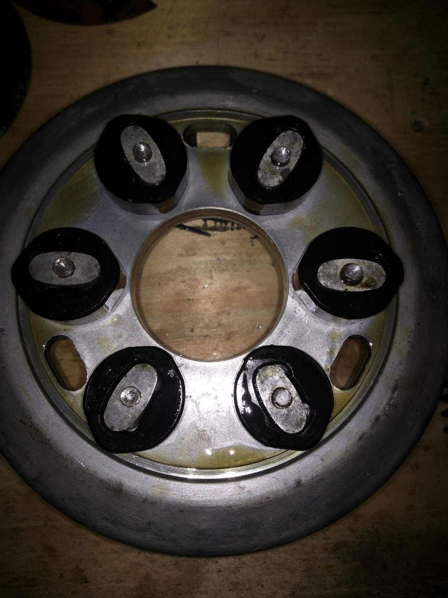

mid way through the clutch rebuild. I meant to get the solid GPZ dampers, but i guess that's the difference between the kz750 and gpz dampers. oh well. my fault

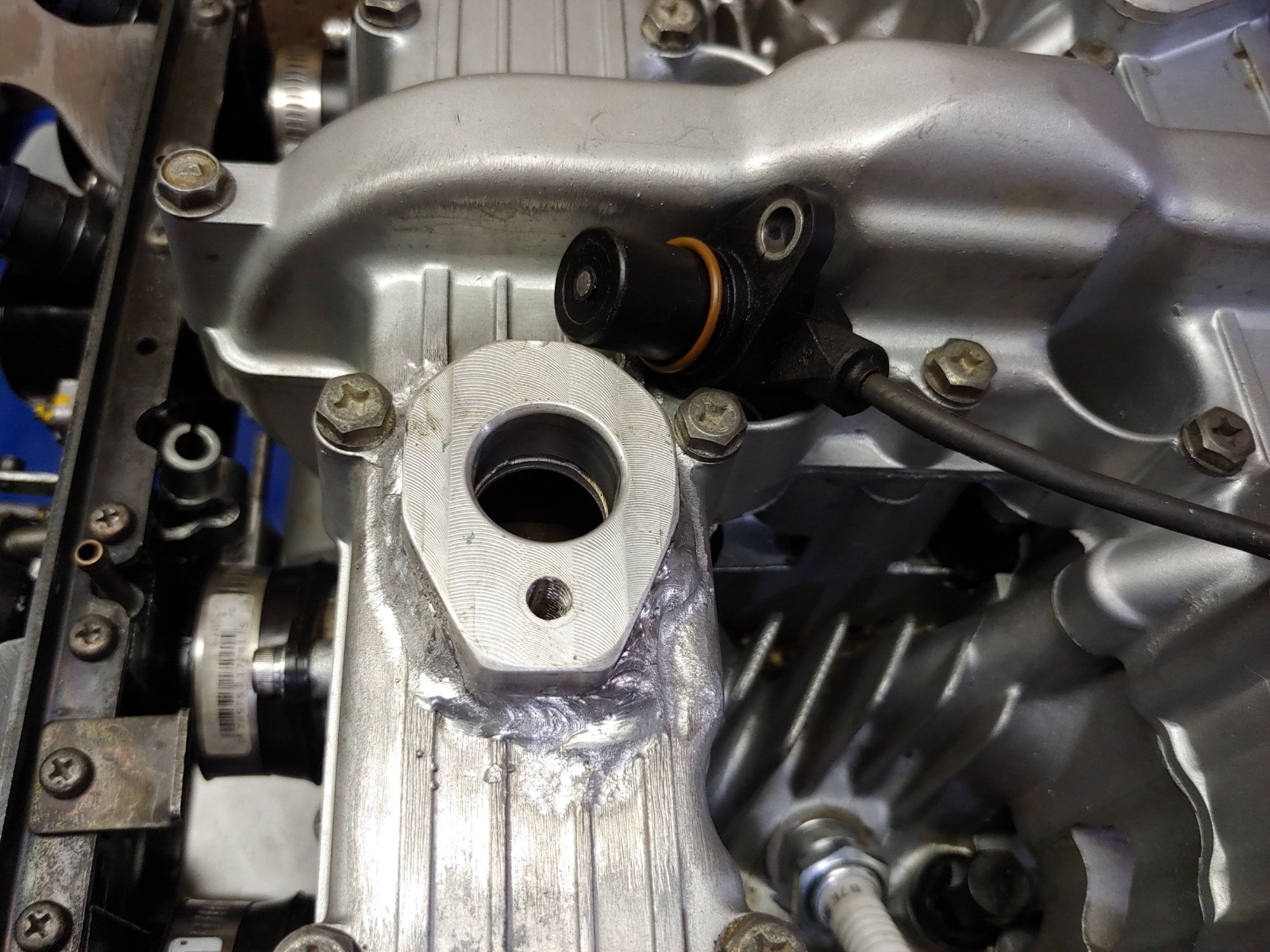

Hole in valve cover for hall effect sensor
Bung welded on:
Current state:
